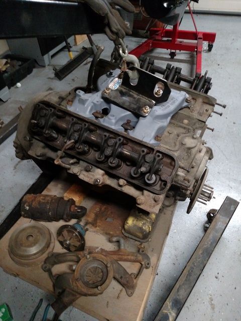

        So I haven't done a whole lot on the car for a couple weeks, but I did pick up a fairly complete '64 studebaker 259 V8 that I will eventually have rebuilt and swap it into the car.
        This will be a ways down the road so I'm still going to run the 6 until the V8 is ready to drop in. To handle the added power of the 259 I'm going searching this weekend for a ford 8.8 rear end with matching 3.73 gears.

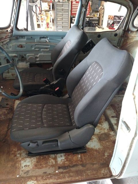

          Since I want to throw this thing through some turns when it's finished I didn't want to be sliding across a bench seat so I picked up a pair of early 2000's mercedes c class coupe buckets with all manual controls. I'll have these upholstered to match the interior when the time comes.

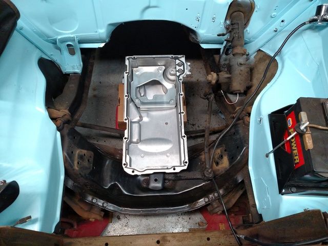

          high clearance GM oil pan...

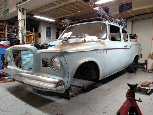

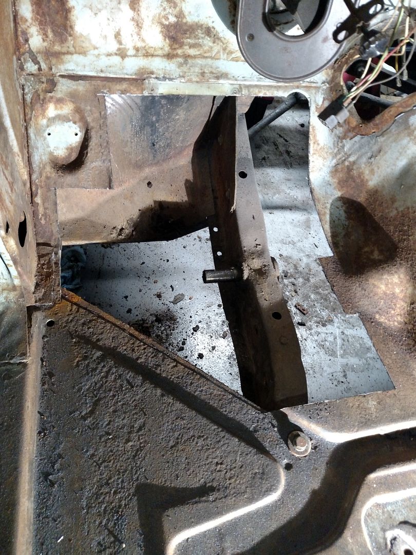

              Little bit of progress the other night, cut out the worst section of the driver side floor pan to begin the repair work.
              The passenger side will be similar.

                • #38
                  are those w203 sportcoupe seats?
                  Lucas
                  Daily: 2004 Pontiac GTO. . . . . . . . . Daily Econobox: 2009 Mini Clubman Cooper
                  Originally posted by LCG
                  High 21! It's like a high 5 but includes both hands, both feet and a boner.
                  • #39
                    Indeed they are, I also have the headrests but they didn't come with the seats so I had to find them separately on ebay.

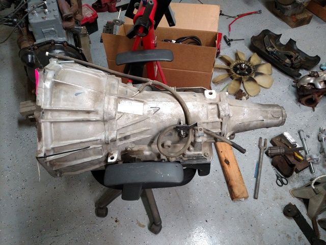

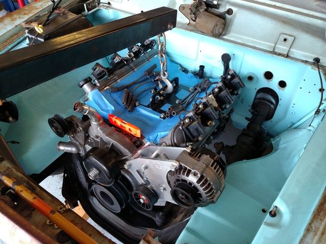

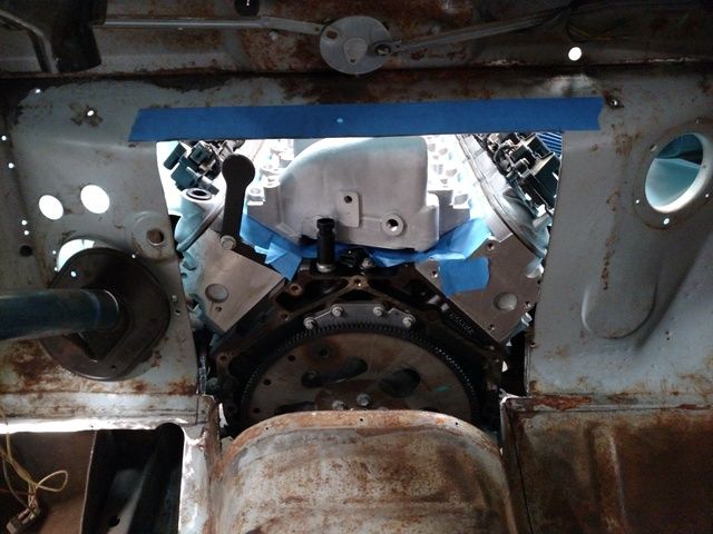

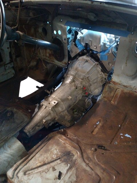

                          I got the motor last monday and have been mocking things up. As it turns out the 4l60e is too big to fit under the original floor so I'm having to cut that section out and rebuild a tunnel but I'm also recessing the firewall a few inches to move the motor back where I want it and needs to be in my opinion for the best performance and fit.
                          Leaving Pacific Fab in Gilroy Monday afternoon.
                          2003 4l60e with 106,000 miles picked up from Cordova Truck Dismantlers in Sacramento, very friendly and honest place.
                          First mockup with the motor, I had already swapped the oil pan, removed the power streering pump and bracket and installed the underdrive pulleys and Dirty Dingo alternator bracket, it was at this point I realized I was going to need to cut the firewall and floor.
                          First cut.
                          More mockup with intake and radiator.
                          Second cut with trans bolted up.

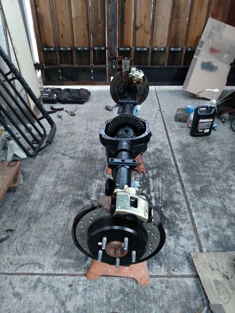

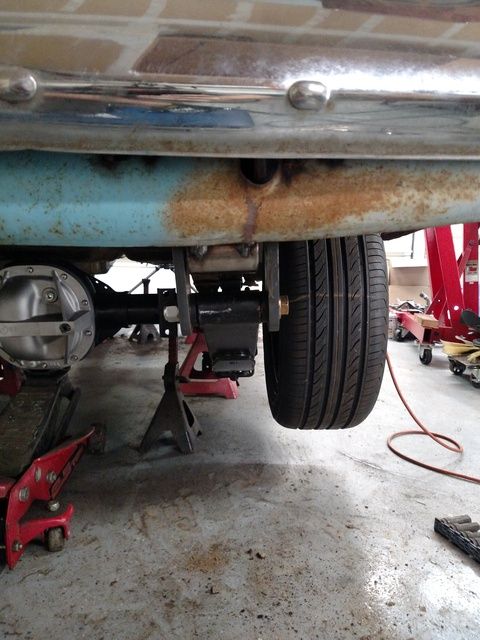

                            I turned my attention to the rear suspension and axle today and began cleaning up the axle and relocating the spring perches. I'm also replacing the outer bearings, seals, and parking brake shoes while it's apart.
                            -Tyler
                            1960 Studebaker Lark VI Build --> http://www.stanceworks.com/forums/sh...ad.php?t=80102 <--
                            1948 Ford F1
                            • #44

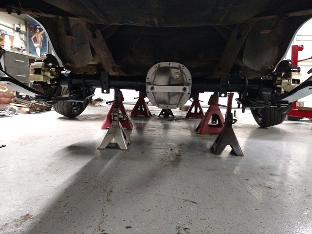

                              Got the axle all squared away, cleaned up, paint, brakes, outer bearings and seals, and a fresh new Moser cover.

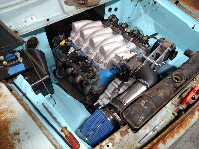

                                Made some progress over the weekend but at the same time hit a little snag with the steering. One step forward, two steps back I guess. I got the rear shackle hangers all burned in so it's half a roller again but then I tried to fit the motor with the high clearance Hooker manifolds and they still don't clear the steering so I'll probably be going to a rack and pinion setup.
                                I have basically two options for this one being a full replacement crossmember and mustang 2 suspension or try and mount a rack behind the factory crossmember on a cradle. The factory steering knuckles attach the tie rods behind the axle centerline which is why I would try and mount the rack behind the crossmember. I'll probably try this method first because if worst comes to worst I can use the rack and rotors I already bought for the other suspension as well.
                                Don't mind the mark that was an early measurement.
                                Test fit with the radiator, I'll most likely move the motor back at least another inch from this location.
                                It's all looking very snug and I'm still contemplating what to do with the firewall.
