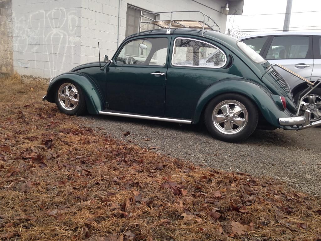

          Here's my old bug she was a 71 named darla and was backdated by a PO which I wasn't fond of but beyond that she was a good car.
          4" narrowed beam
          Drop spindles
          5x130 disc brakes
          5x130 studded rear drums
          4.5" and 5.5" fuchs

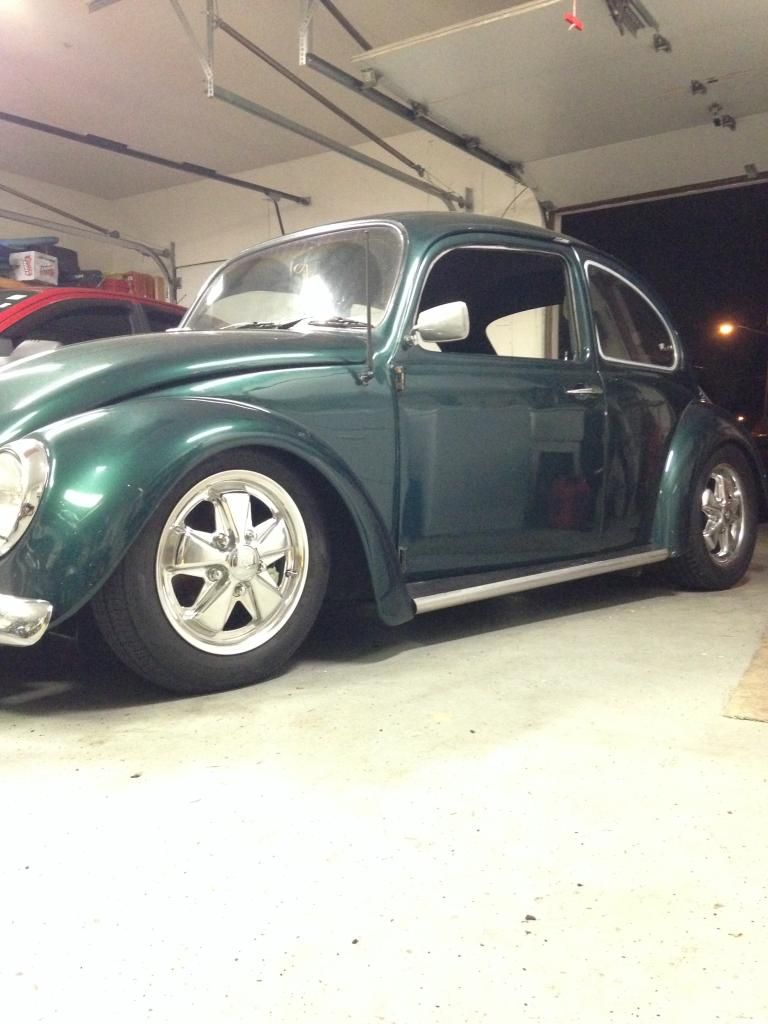

            Sweet man! Also wish I had a shop with friends to work on cars with.
            Heres my 77 which has one outer click with 2" adjustable rear plates. So about 2 outer splines relative.
            I wish I would gotten 4" drop plates honestly.
