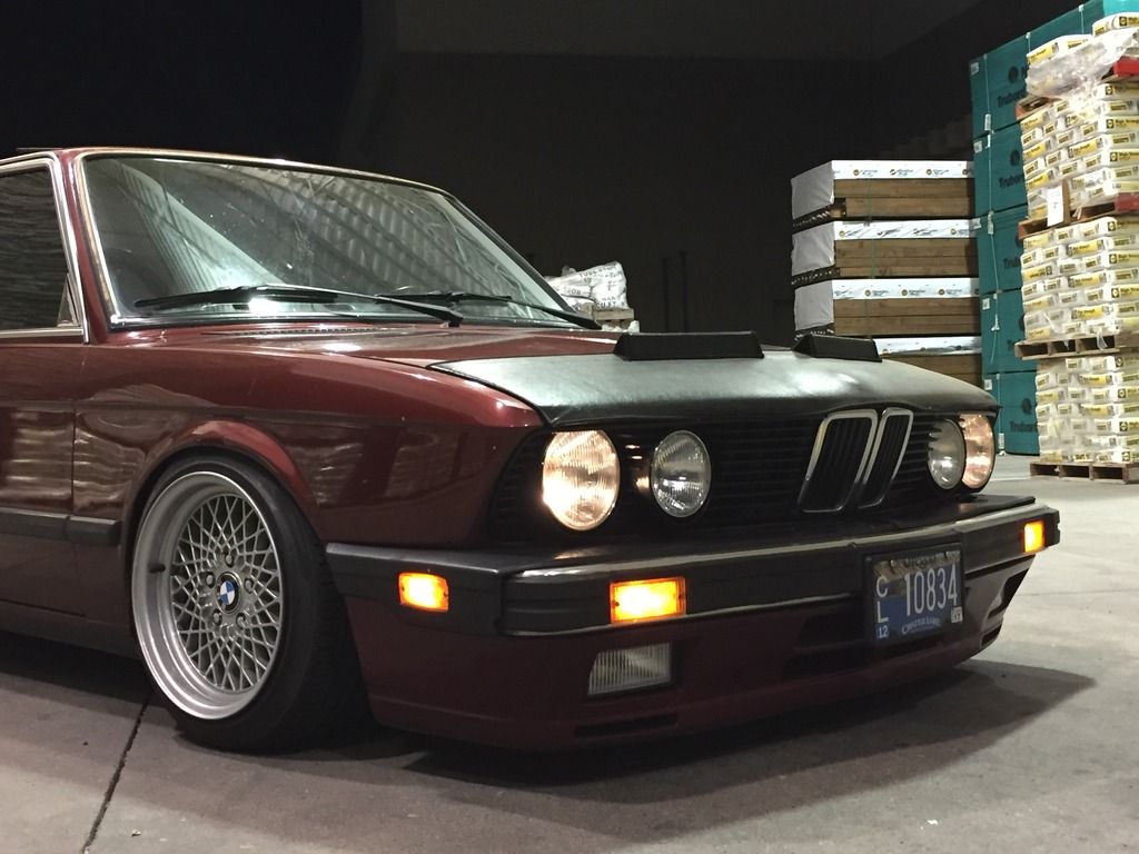

Haha im always back and forth with it Thank you!Originally posted by Back_in_Black View PostLooks way better without the Hood bra! Nice build tho!

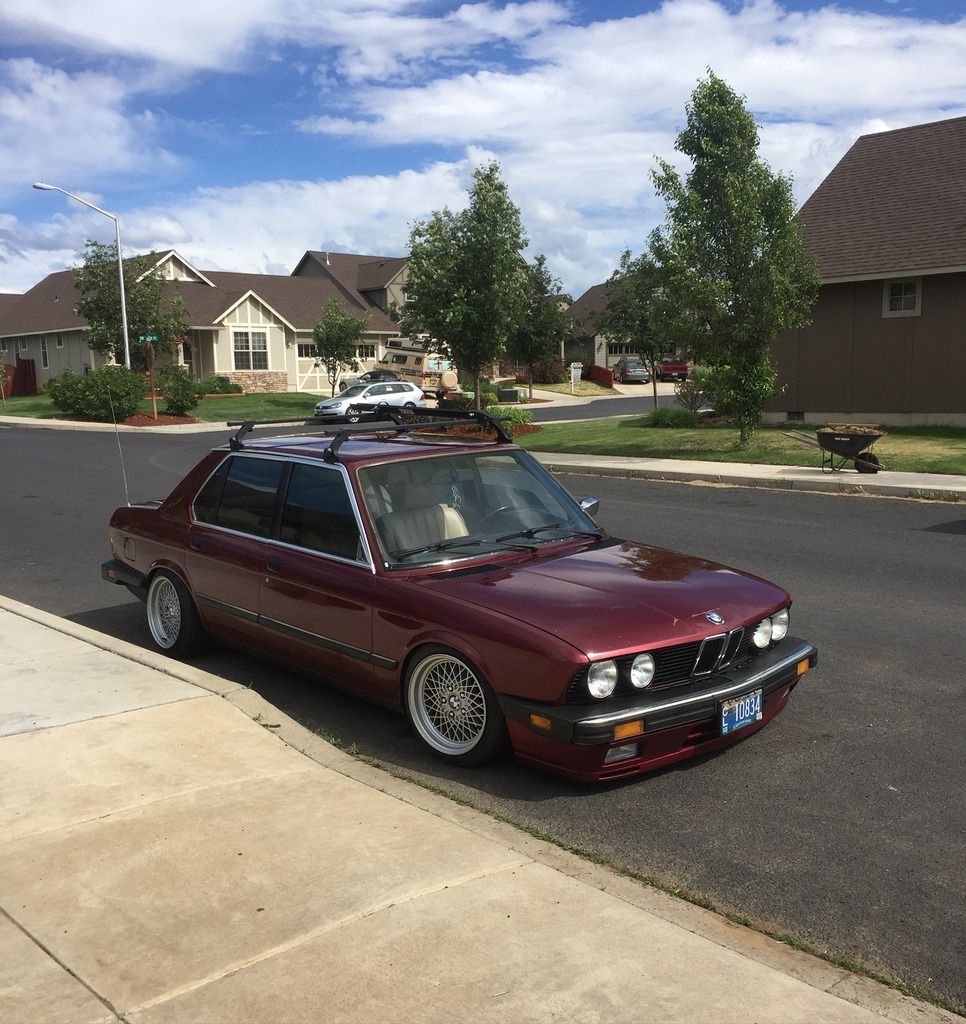

A few iphone shots from the other night. Patiently waiting for leavenworth next month
Leave a comment:
damn, never saw this thread before.
calypso red with a creme interior is always a winning combo.
and those seats look like new!
really classy, keep it up
