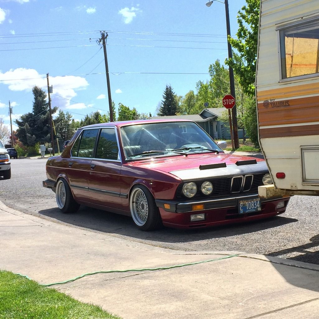

Well my wheels havent had center caps ever and I always tossed around the idea of making them but bmw caps are too small for the center of these wheels considering the smallest section of the center is about 3 inches. So I finally decided to make some. I wasnt a fan of what riken had as a cap with it sticking out 2 inches or so. Just doesnt look great to me. Flat caps are something I really like so I was really able to accomplish that look doing it myself. Went to lowes and picked up some plastic 3 inch test caps.
These worked great. Hard plastic, thin, and two lips gave me the opportunity to have 2, very tight, points of contact inside the center since there are two different diameters due to the small step lip. First thing was to make the larger section fit tightly. I trimmed off a bunch of the outside and then hand filed the edges to be smooth.
Next was to sit there and file away. After multiple test fits, I got each one to where I wanted.
Next was to file the raised center section. Same step as the last. file away until it fit super tight.
After all 4 were filed, cut, and fit tightly on both surfaces, I painted them black and threw them on the car.
This is a rough idea of what they will look like when I get stickers/emblems for them. BMW has a common 68mm emblem. 70mm is what I will be getting. The extra 2mm helps fill out the center better. This is one I have laying around that I taped on to get an idea.
Emblems should be ordered next week sometime.
