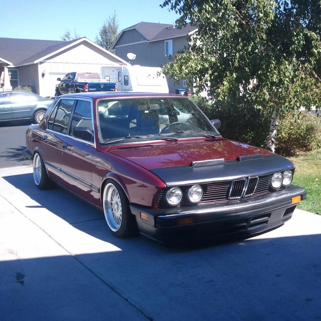

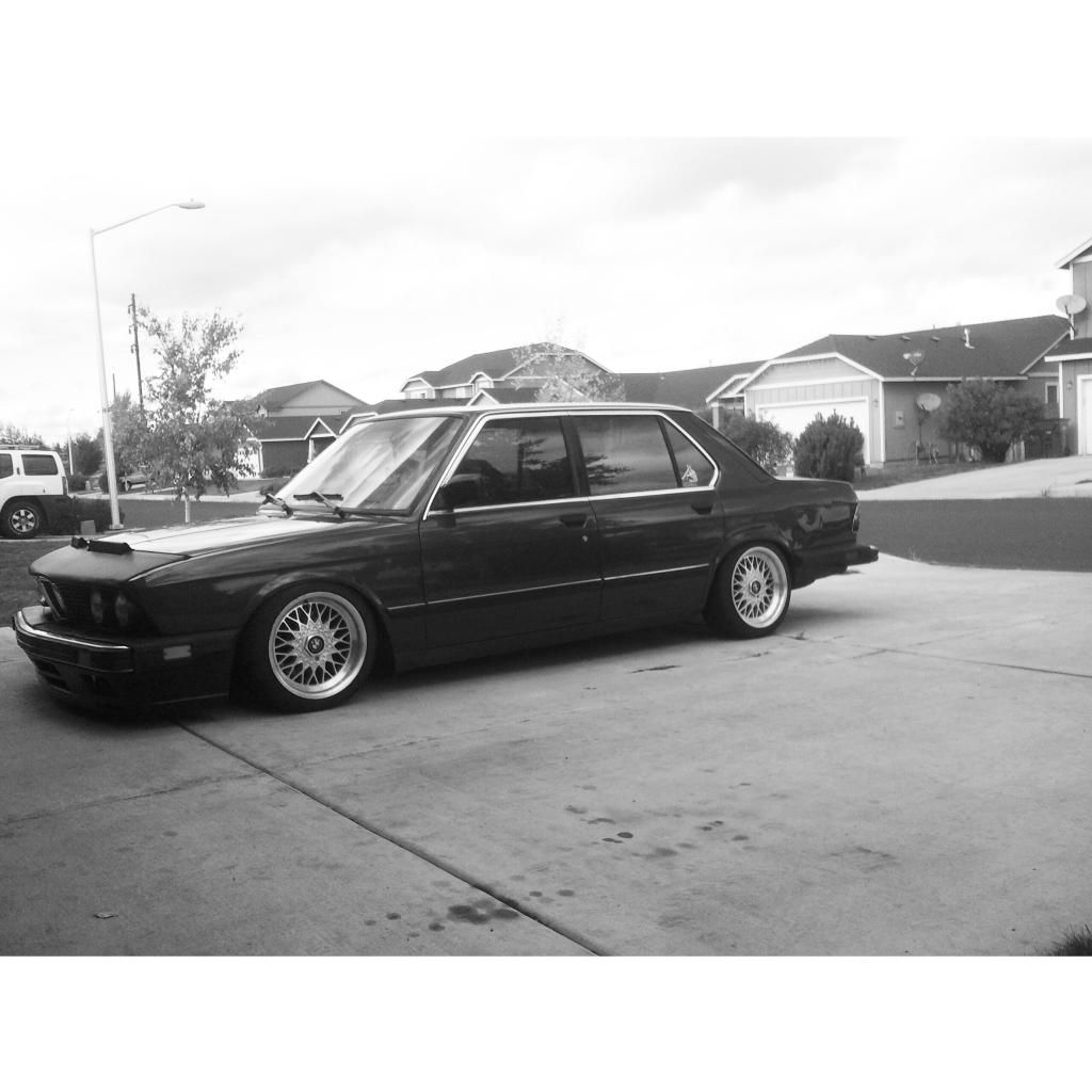

Well havent updated in a while. School and laziness have taken up most of my time. Well got a bra to cover up the shitty hood paint. took a month but im so glad I waited and got it. Not everyones style but im really happy with it. Also spaced out the front more. I beleive its at -2 now. Other than that, havent done much else.

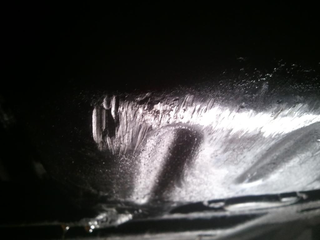

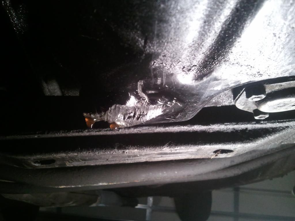

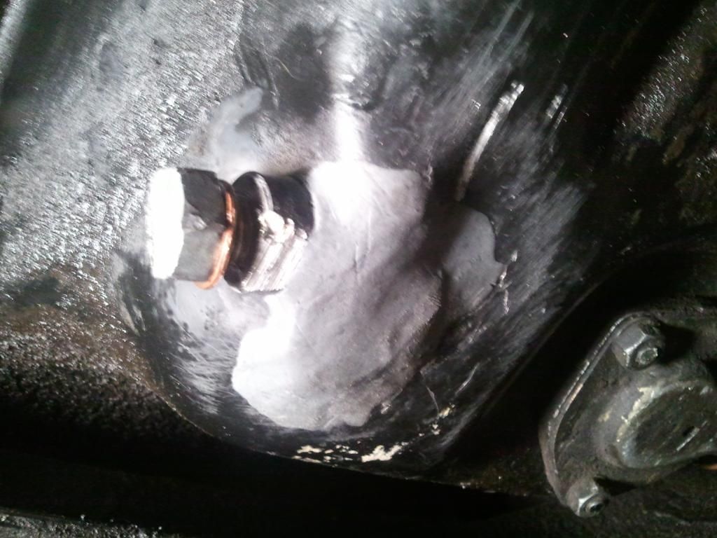

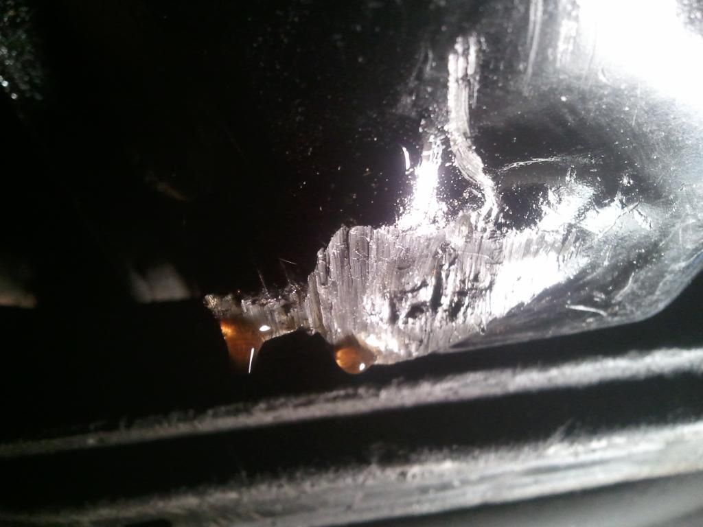

Well after 3 years, I finally cracked a pan. Didnt even really notice it until I changed my oil. Had a crap ton of dirt holding the oil in... Either way, I went to fix it, dont think I cleaned well enough around the area, and it leaked again. So today, I really cleaned around it, sanded, made sure I could get as little oil to come out until the epoxy settled, and hopefully, it will seal. Used WAYYY less this time too. That may have been an issue before as well.
The funny thing is within allll of this, it is a tiny crack.

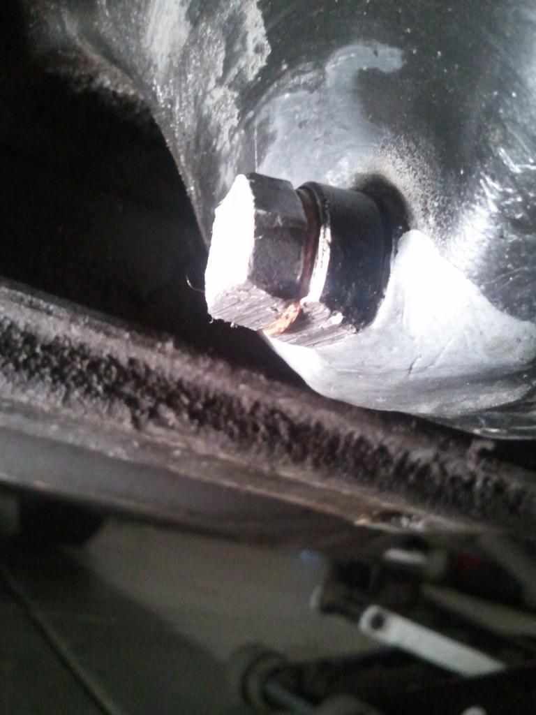

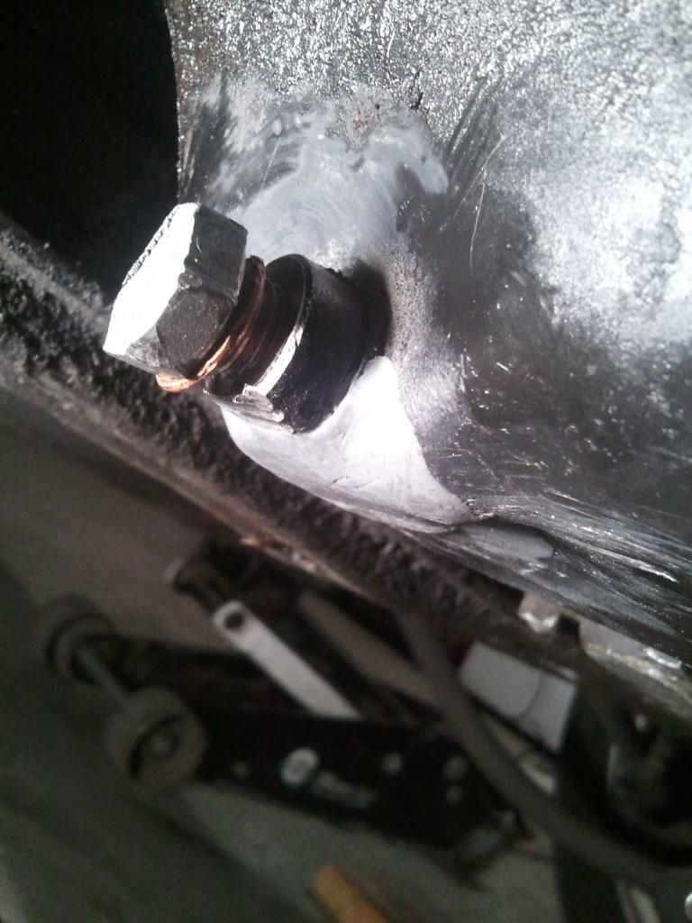

Some other little spots
Got the bolt matched back up lol

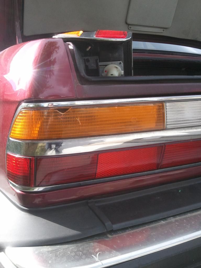

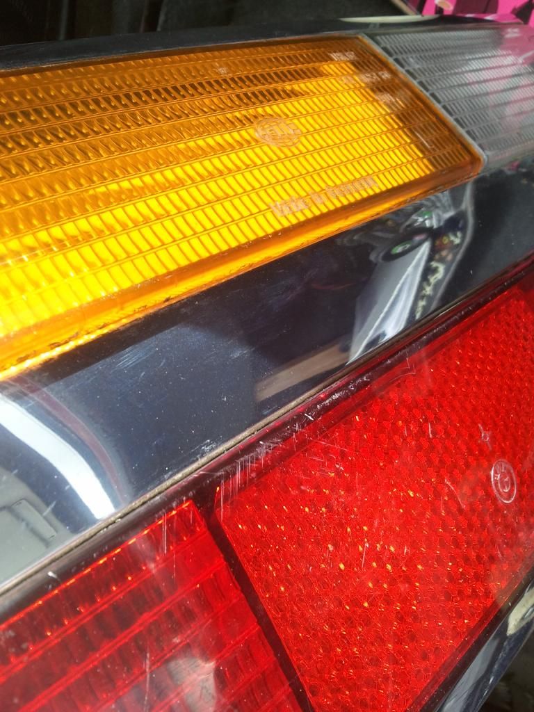

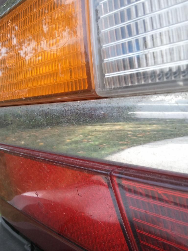

Also got some good tails with the car that I could never seem to get to work before. Thought the plug was messed up. Ended up playing with each bulb for about 10 seconds and bam. they turned on so I threw em in.
OLD:
NEW:
wiped them down after as well. Pretty sure those little white scratches dont show nearly as bad anymore.

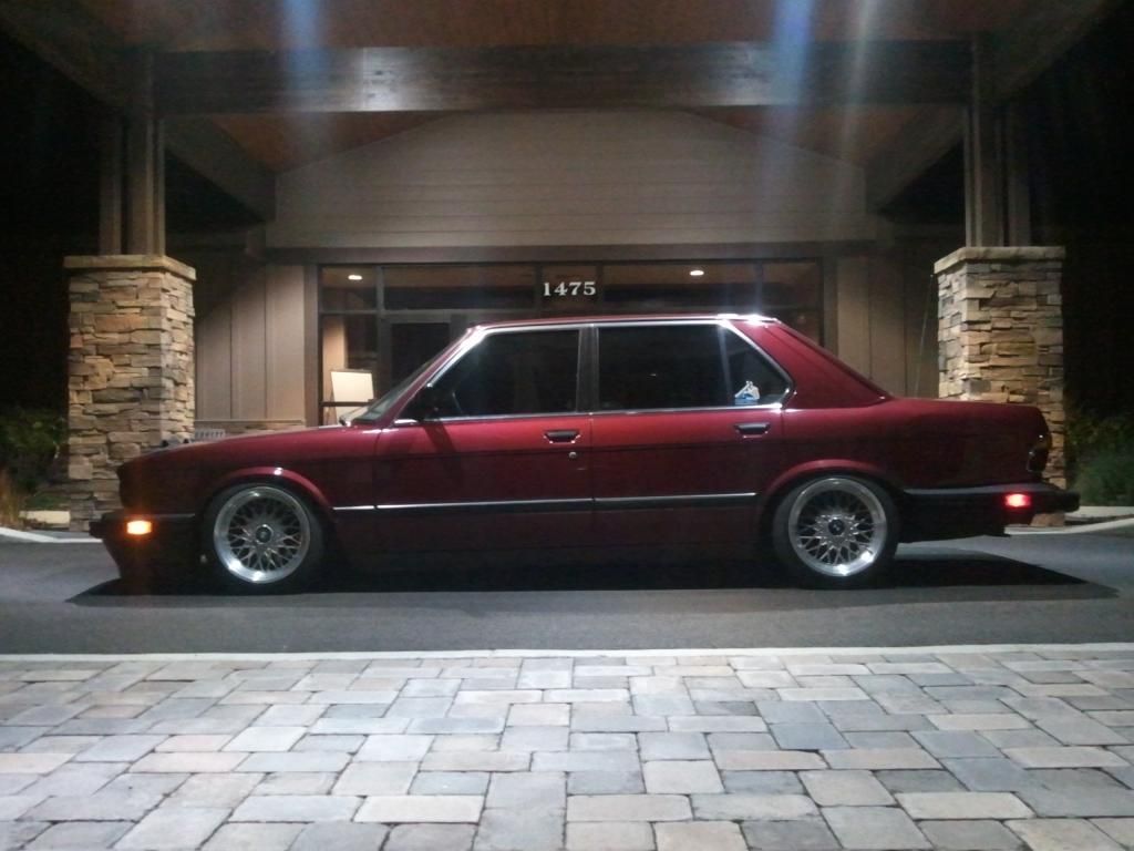

And some together photos.
