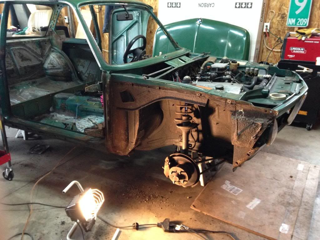

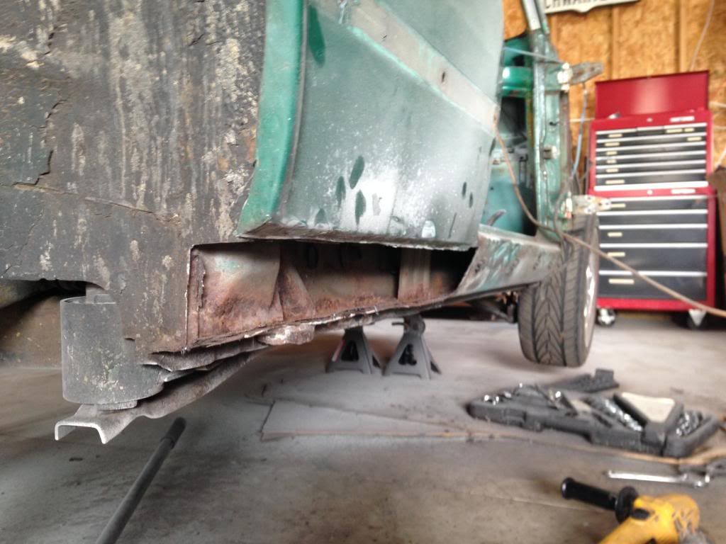

      Removed the interior and glass, lucky to find that the only big rust issues are the front floorpans, looks like those are going to need to be cut out! No wonder there was a draft coming through.
      Removing the sound deadening sucksssss
      Everything else is looking pretty tidy

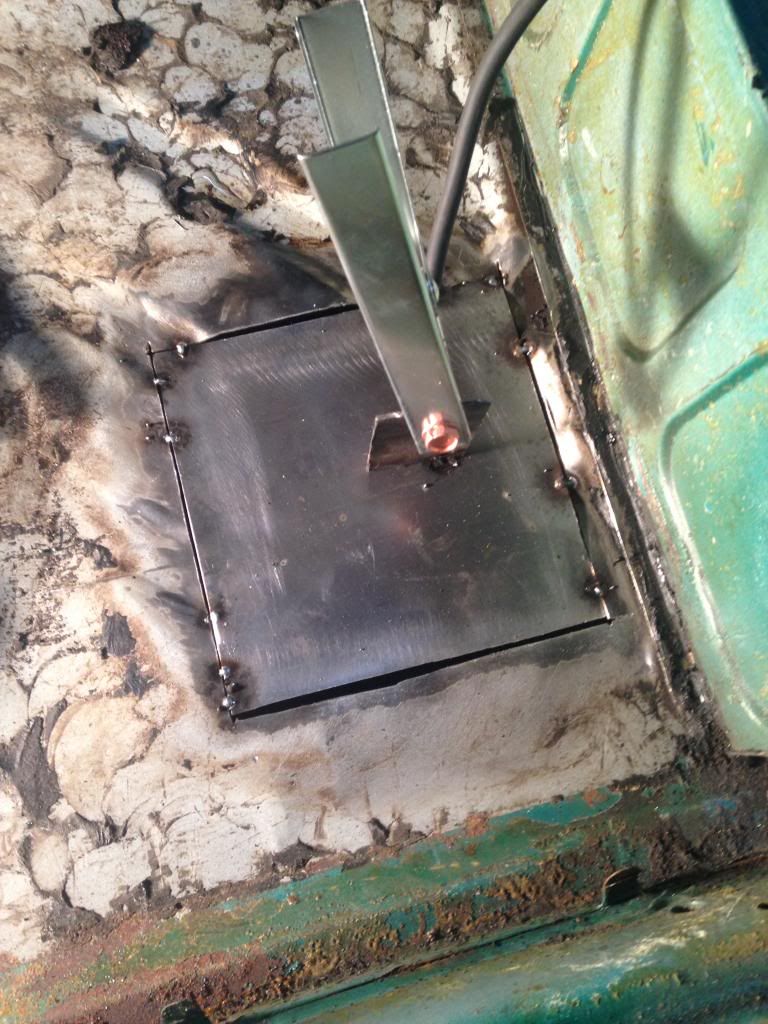

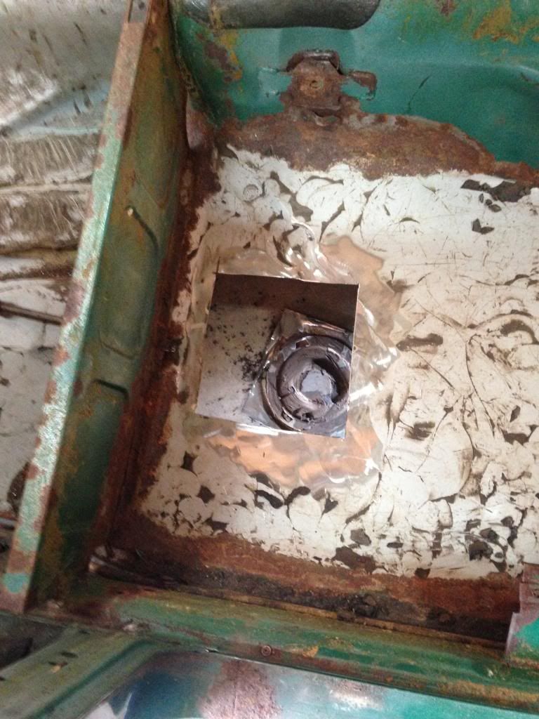

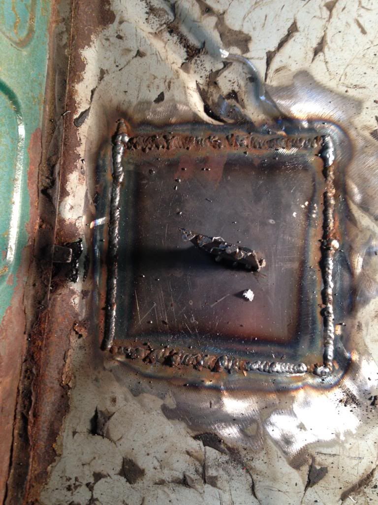

          Then my grandpa taught me to weld so I welded up the drain plug holes.

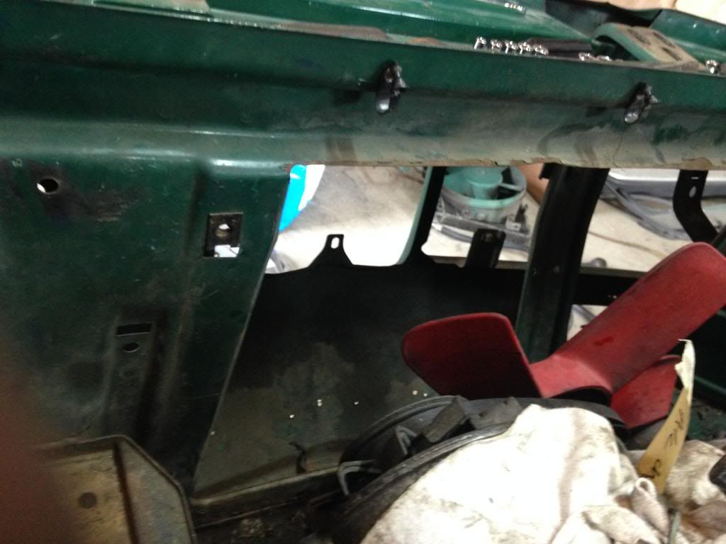

          Took the front fenders off

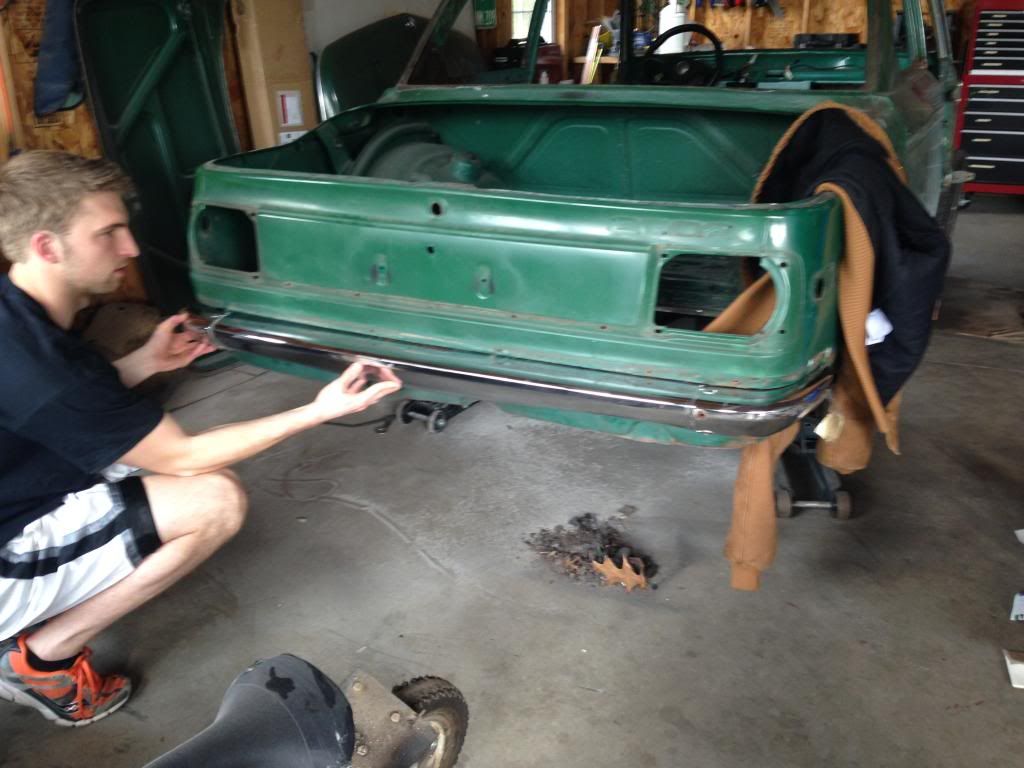

          Had to cut a lot out because she is truly a rust bucket, this cleverly hiding under a tub of bondo
          Who doesnt
          Bumper that will go on in like five years when its done

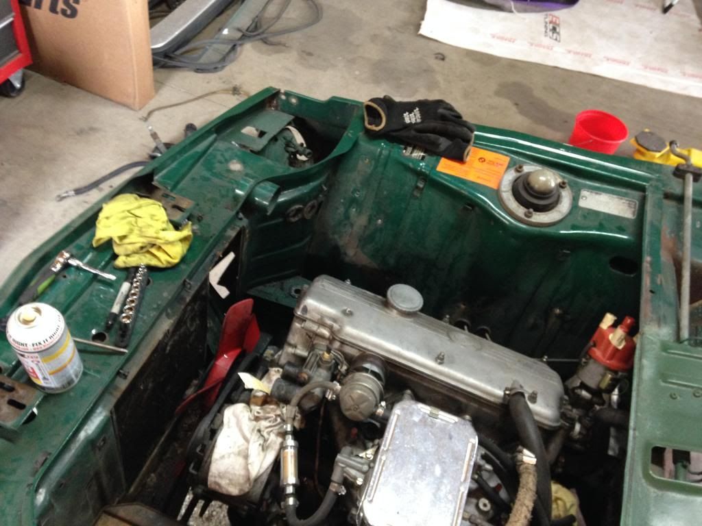

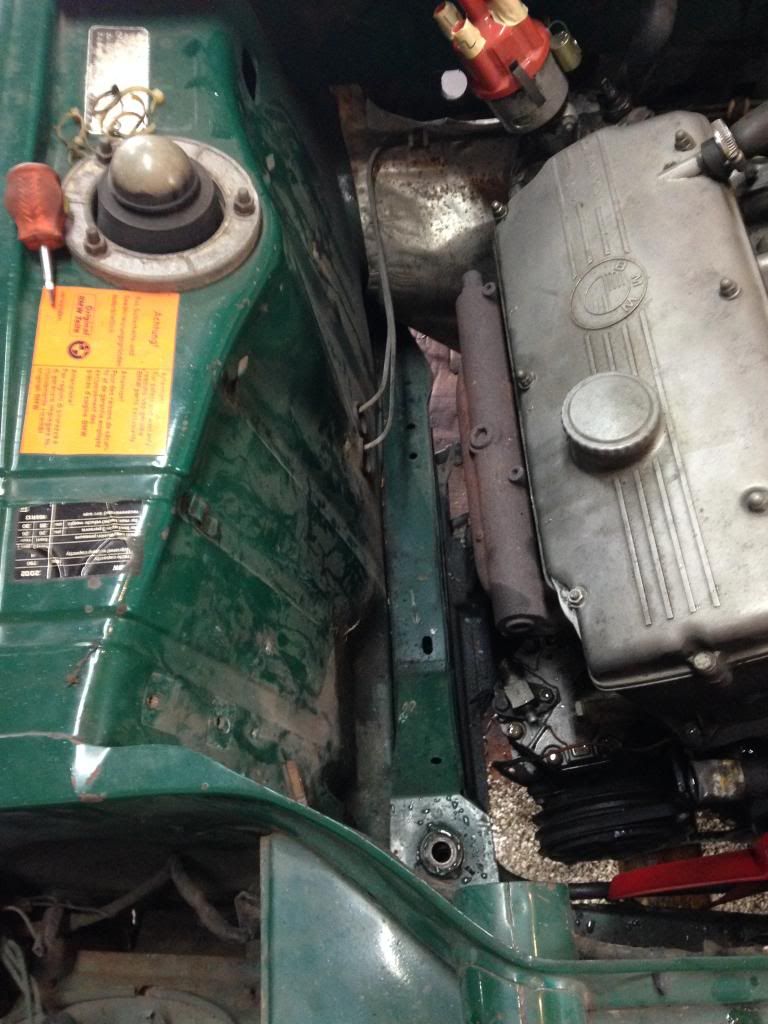

                              Started cleaning up the engine bay. Mostly just cleaned up the passenger side so far. Trying to keep the wires straight is tough stuff. Engine will be removed once I have everything ready to go.

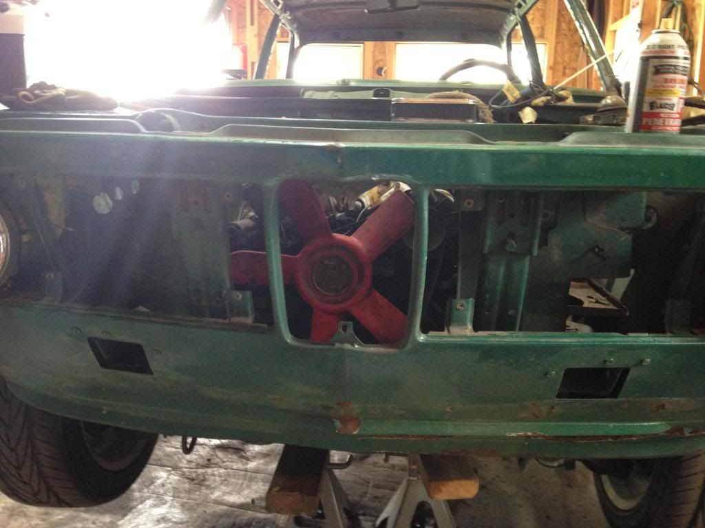

                              Took everything out of the front

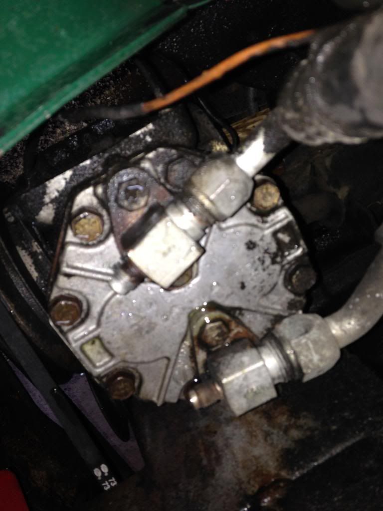

                              Ours had an aftermarket air conditioner in it. This air conditioner had lines running through the top of this piece pictured below. Anyone know if this was just a mounting point or if this whole piece went with the aftermarket air conditioner. This piece is on the passenger side of the engine and it has a belt running it.
