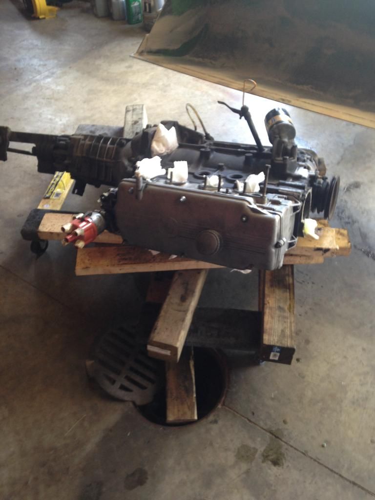

                            • #44
                              Only thing he missed was when the engine fell into the drain.
                              Its been a lot of work and fun this summer but the build will slow until next spring as I am leaving for my freshman year of college at Clemson U. Wish me luck!
                              • #45
                                No one needs to know about that.
