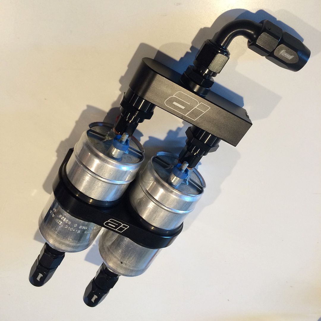

    Dual 044 bracket arrived today, very nice quality.
    Waiting for some more fittings from summit and then all I need are injectors and ms3 to start it up.

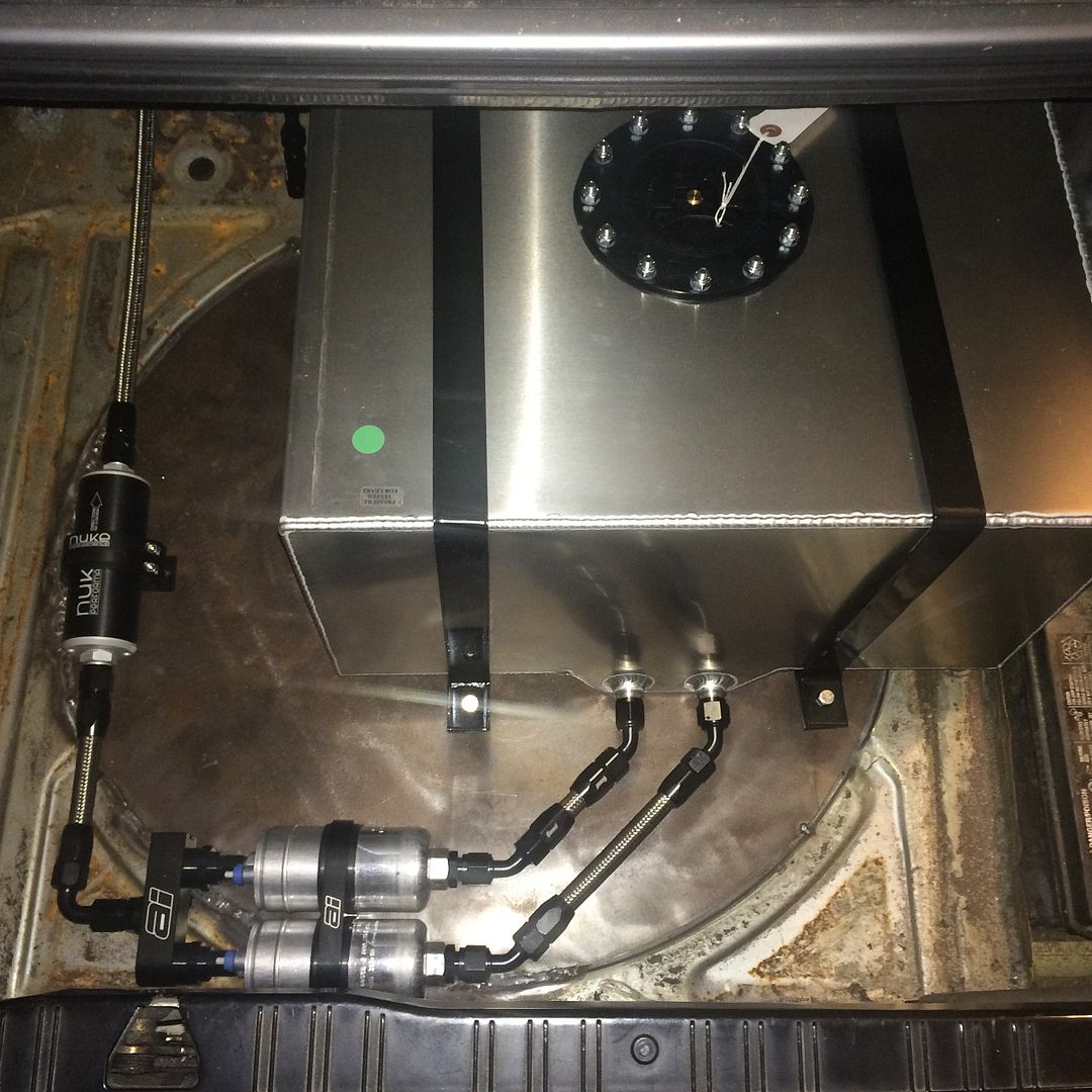

        Ran all of the lines for the fuel cell last night

          Little update, finished welding my trunk shut and ran my fuel lines. Got a set of kirkey pro street drag seats, going to buy the covers and RJS harnesses soon.

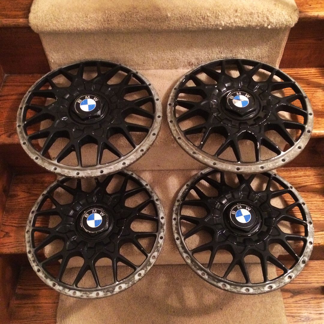

                  Found a set of bbs rc041's on craigslist the price was right and they are forged and 1 of 150 sets I've been told. VRwheels will be making lips and barrels for them, and I will get the centers polished.

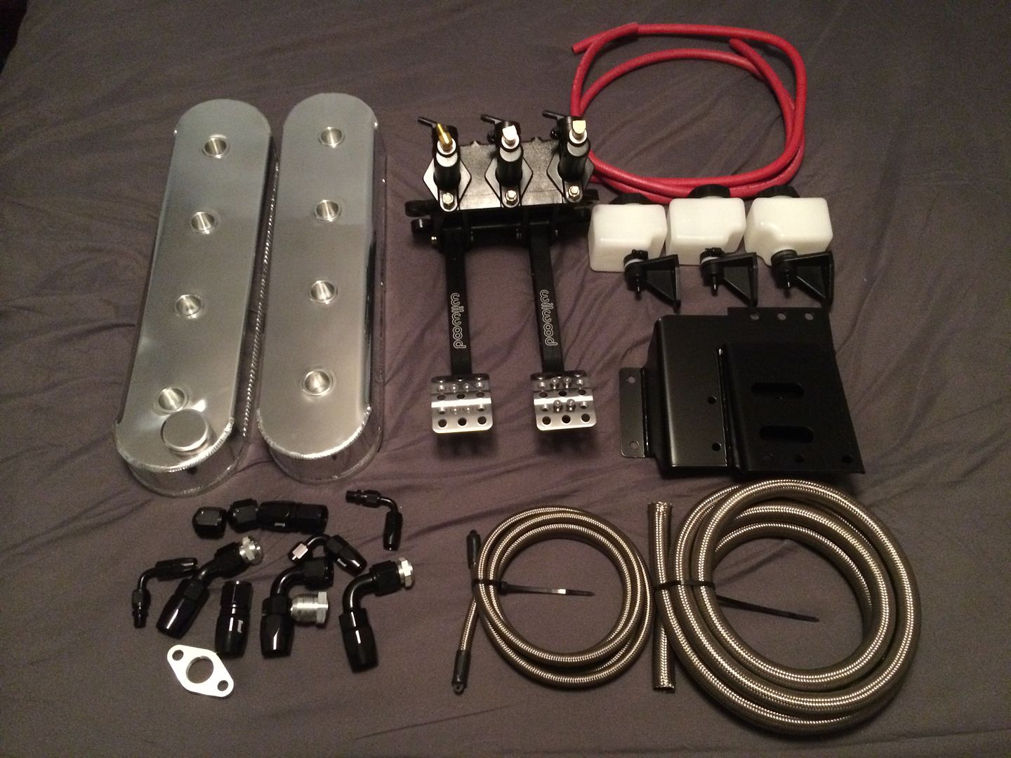

                        Bought some more parts. Wilwood manual pedal setup because the booster doesn't clear, shaved valve covers (don't worry I'm going to powdercoat them), AN fittings for breather setup and oil feed/drain, and coil relocator brackets.

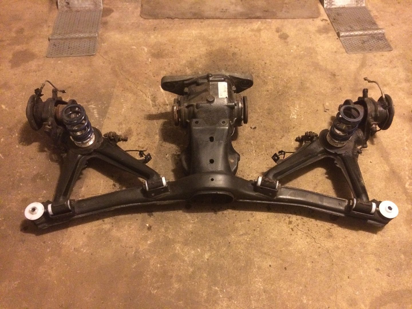

                            Rear end is all sorted now.
                            E36 diff with a 4 clutch rebuild and 3.46 gears, CAtuned chromoly axles, z3 hubs, e46 brakes, camber/toe adjustment tabs welded in, raised subframe 12mm, cut and boxed/reinforced subframe to clear 1350 u joint.
                            Had to mill part of my diff to accept the 2 extra clutches.
                            New bolts, bearings, and clutches
                            It's going to be a tight fit, I still plan on reinforcing the subframe a little bit more just for peace of mind.
                            Next step is to machine an adapter to bolt the 1350 u joint flange to my diff input flange.

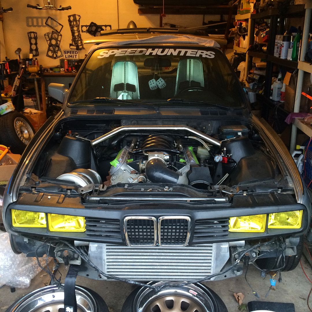

                                Made some progress on the car...
                                Finished up the diff rebuild and flange adapter plate.
                                I will clearance the subframe some and weld another plate across the bottom.
                                Here's the 5" exhaust vs my old 3" hahaha
                                Worked some on my crossover setup too
                                Front brakes showed up today, still need rotors.
                                I saw this picture online comparing gen 4 bottom end to gen 3 and I quickly decided to swap in the aluminum 5.3 I have.
                                Here's how it looks so far with the catch can in the corner too.
                                Next up I'm building the trans and setting up a trans pump to keep the gears cool. Still need to order a driveshaft, front hubs/rotors, and small things.
