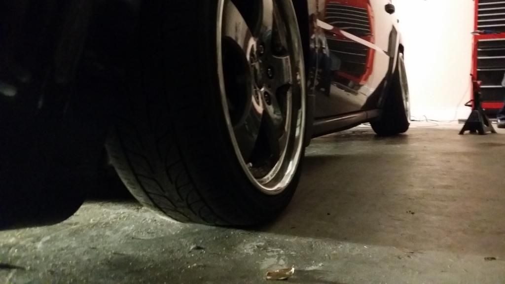

While everything was torn apart, I threw on my new tubular camber arms and played around with them just a little bit. I'm in love.
Sad part is, I'm not laying frame. I'm not sure how to really make the bags sit lower, because I need all the lift I can get right now. It may require me stepping down to 18s like I had planned.
Off to work then get back to leak testing!
But for now, I give you this.
