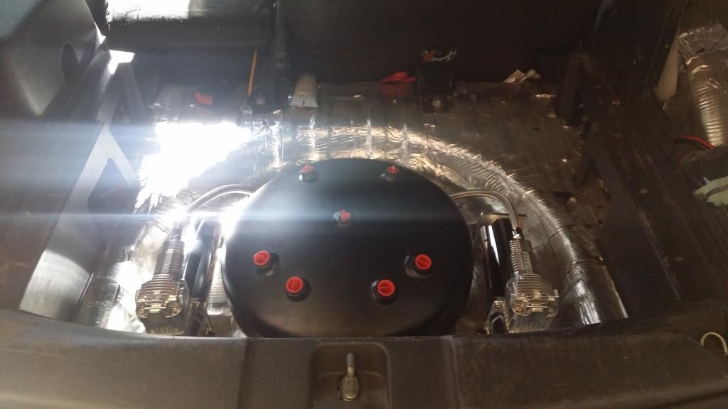

    I was so skeptical about the pancake tank. But I think it's going to look great all buttoned up back there. Nice!
    I was definitely hesitant about the pancake, I think it came out great though. Eventually I'll figure out a way to dress everything up but for right now I'd rather just have functional air!

    I'll tell ya', the tank and compressors look good in there!
    Snapped 2 bagridees tees, and a 1/4 to 3/8 PTC. So my shortage of tees is now -4.
    The fitment is awesome, I had to pull my deadener mat out to clean but it'll find its way back underneath all that eventually.

    You snapping tees? I find those are pretty easy to crack. I like the big machined ones that Bag Riders advertises on their website, but I don't know if that's what they're shipping out.

    Tank so excited it's about to pee itself. Had a rough start to today, snapped 3 fittings, hemanned another so tight the hex nipple went into the female and broke it, and had placed the wrong size order for the hexcaps, or BR site was wrong. I'll figure it out later.
    I got my compressors wired, and functional. That was probably the biggest relief was hearing the compressors turn on. I had to unplug them though since I have nothing to control them just yet and my tank has 4 open ports.
    Until I feel like explaining more problems that occured, Good night.
