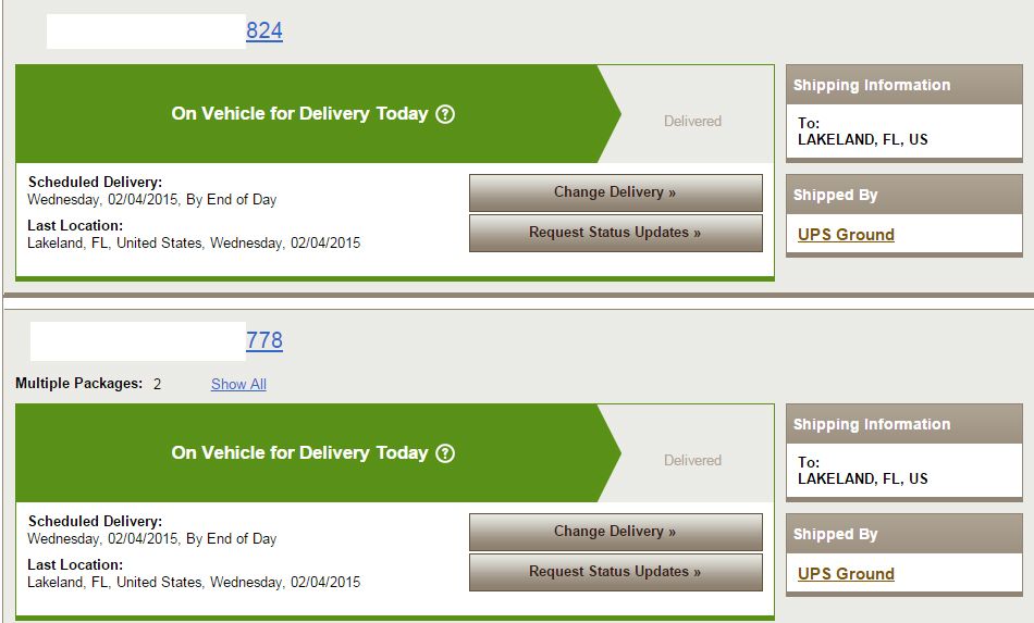

    3/4 packages got delivered. Not sure how that happened.

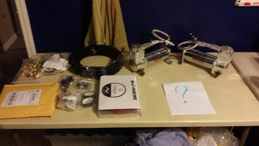

    I won't get into the actual "install" of the parts I have until saturday most likely but I may mock it all up inside the house just to feel accomplished. Or I could do homework.. nahhh.

    Trunk setup inbound. I also ordered the fancy plugs from the site you recommended, and all the fittings I didn't pick up from bag riders should be here within the next few days. The goop and gas line tape should be here friday so until then I might just twist everything together for my own well being and make sure I have what I need.
