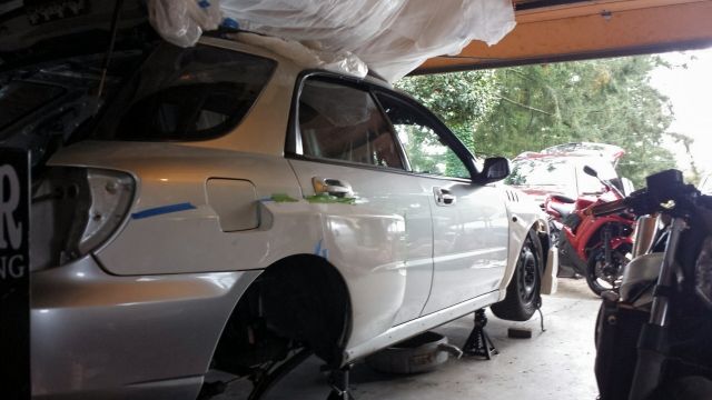

    Originally posted by Recoil889 View Post
    The rear overfenders are L'aunsport widebody GG fenders, fit over the stock fender, which was cut, split and welded to create a new wheel well.
    woah. thats bad ass.
    Leave a comment:
  • Recoil889
    replied
    Originally posted by SnazzyQ View Post
    Are those STI rear guards? also I need to see this in person when its done.

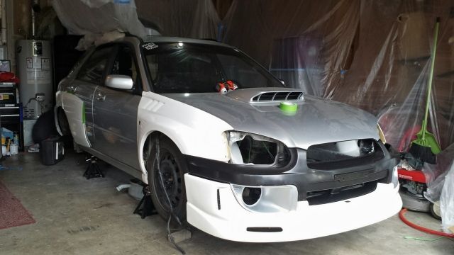

    One more photo for good measure:
    This car sat at about 5.5 feet wide in stock form. I'm now just a hair over 6 feet wide.

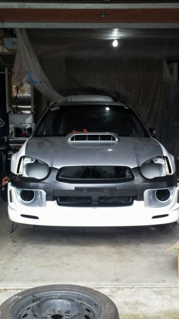

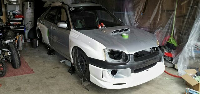

    Chargespeed fenders showed up. Here's everything mocked up:
    That's it for a little while. I'm getting keys to a new place this evening, so it'll be a little hectic getting moved in and settled before anything happens to the car again.
