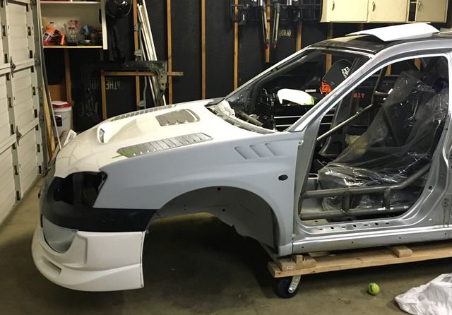

    I received my sideskirts from Shine Auto while the car was away for fabrication. One of the biggest challenges with not buying an out of the box widebody kit was finding parts that would all fit and flow well together. Between the two bumpers, both sets of fenders, sideskirts and front lip, I'm working with five different manufacturers.
    I half-assed bolted up the doors on the passenger side and mocked up the widebody to see of everything would fit and flow together. I was really pleased to see how good it all fit and looked. I still have to add aero to the car, but for now, I'm happy to see it doesn't look awful.
    I decided to take some measurements of the clearance in the fender wells now that everything was finished. 16" in the front and 15.5" in the rear. I'd love to see 315s in my future on this car.

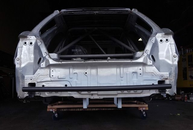

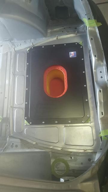

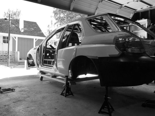

    I made a quick trip up to Godspeed fabrication to drop off some bumper brackets and take a look at the car. Everything is progressing very nicely.
    The rear quarters have been trimmed out so that the widebody will be in place of that area once everything is molded in.

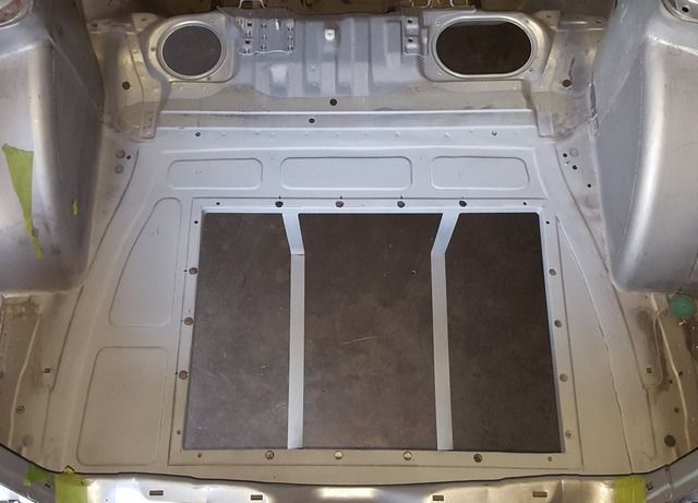

    The fuel cell mount is finished. The bottom of the cell rests onto two horizontal supports and is bolted into the "trunk" floor with two bolts at each corner.
    At this point, I think I'll route the filler neck in a similar area as the stock one and mount the dry-break port where the stock gas cap goes. This may very well change down the road.
    The rear wheel arches were finished to match the interior radius of the rear tubs. Tons of room in there for big tires.
    The last thing left is finishing up the rear bumper beam so I can mount my bumper cover to it like the OEM beam.
    Once I get the car back home, I'll tackle the awful job of removing all the remaining coating from the rear wheel arches and priming them to be ready for textured epoxy like the front ones.
    All this should knock quite a bit of weight out of the back of the car.

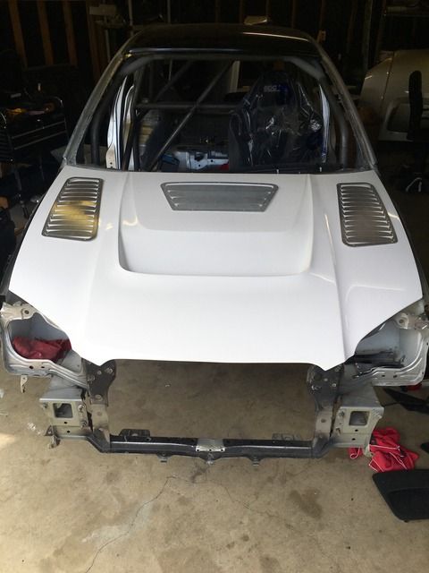

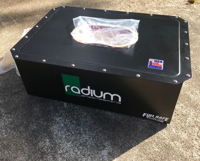

    I had a chance to get the car back into the fabrication shop to finish up a few things, so I had it trailered up last week.
    While its there, the spare tire well will be cut out to install the Radium fuel cell that I ordered a while ago.
    I'm planning to run a remote fill neck connected to a dry-break fuel port either in the passenger side rear quarter lexan, or below where the stock fuel door would normally be located. Still a ways off from making that choice.
    Next up is cutting out the portions of the rear quarters that are replaced by the widebody, finishing the rear wheel arches to match the inside radius of the tubs, and having a rear bumper beam made and welded in.

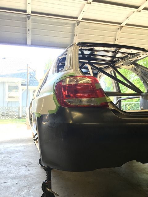

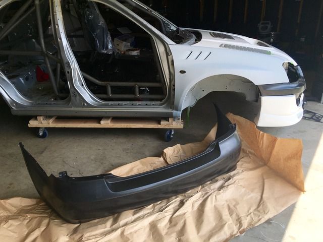

    Got my hands on a new OEM Saabaru rear bumper cover. I may order another one to keep around, it seems harder than it should be to get ahold of them.
    Seems to fit ok. The bumper cover will need to be stretched ever so slightly to fix about a 1mm gap. Not sure the best way to go about doing it.
    Sideskirts are ordered and on the way. I'm slowly sending bolt on parts to body work. Otherwise, things are slowing down slightly while I'm trying to figure out what to tackle next.

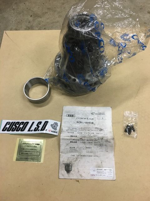

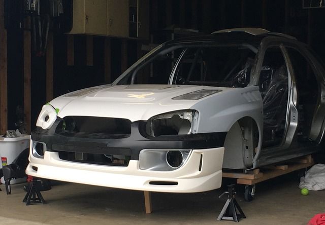

    I was lucky to stumble across a fantastic deal on a Facebook classified page for this brand new Cusco front differential. I've been doing a little digging around to figure out what I want to do with the center differential before I crack the six speed open to re-gear it.
    I wasn't feeling entirely satisfied with how domestic the front end of the car was looking with the Kaminari hood. Luckily, a friend of mine was selling a set of his singular motorsports hood louvers, so I took those off of his hands. I haven't quite decided where exactly I'm going to mount them, but they look good laid out. I'll need to cut these in, so I'll probably do it towards the end when I install the aerocatch latches.
    I received my fenders back from the body shop last week, too. I dropped them off as a test to see if I wanted to proceed with this shop for the remainder of the car. They came out pretty good, but there will need to be a correction or two done before the car is sprayed. After getting those back, I decided to halfassed put the front end of the car together.
    I'll probably spend a good portion of this weekend continuing to mess around with getting the interior prepped and organizing parts for assembly.
