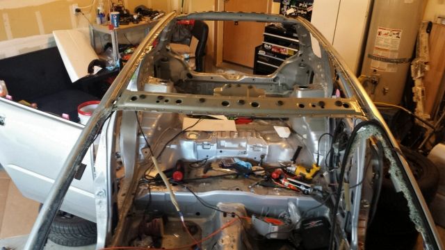

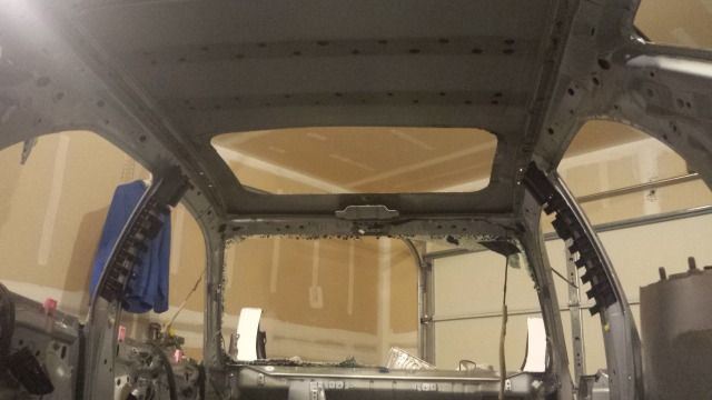

    I took it upon myself to pull the sunroof out of the car yesterday. When I originally pulled the headliner, I had some concerns with the sunroof itself. It tuned out that this was NOT an OEM sunroof. As such, I decided I was going to lose it and have the hole welded and install a spec c roof vent in its place.
    I successfully dropped the sunroof acouple nights ago. After it came out, I noticed acouple things:
    1) The install job was piss poor. The installer didn't do a good job sealing it against the roof skin and there was a significant amount of rust/rot.
    2) Instead of buying an OEM roof skin that is already cut for a sun roof (they're $325.00) the installer hacked up a non sunroof roof skin. This included cutting all but one of the roof supports. When the sunroof came down, the roof skin buckled because of this.
    At this point I said fuck it and just pulled the whole roof skin off.
    Plans at this point are to order a new roof skin and have it installed with the roof vent.
    I'm also seriously debating chopping the roof line down 2" and replacing all the glass with cut to size lexan.

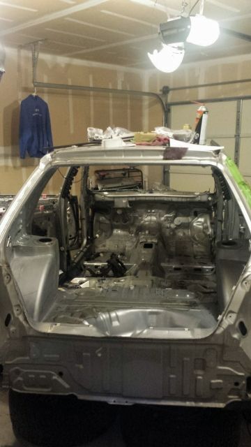

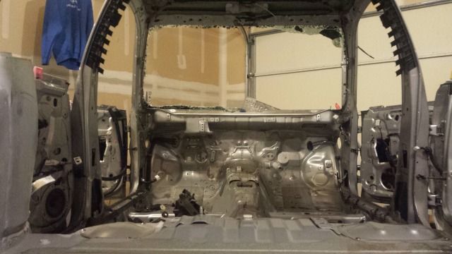

    About 90% gutted as of today. I need to finish popping off all of the plastic push tabs and pick up 15lbs of dry ice so I can get rid of all the sound deadening.

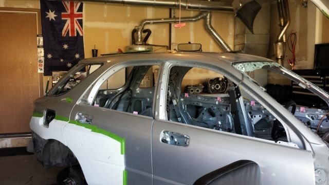

    Quick and half assed update:
    of the glass is out:
    Slowly but surely pulling the wiring harness and getting the car ready for sandblasting.
    I recently picked up a set of EJ257 heads and GSC S3 cams. Hopefully more substantial updates on the horizon.
