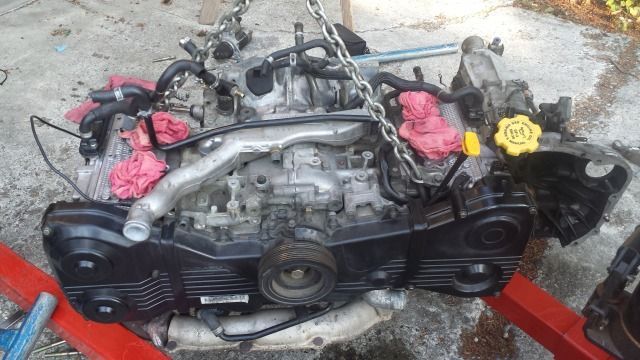

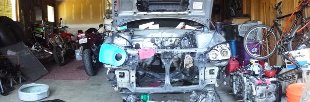

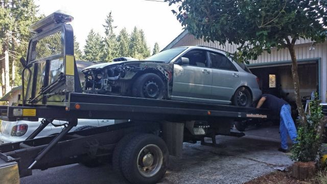

    Since I last posted on here, lots of good stuff has happened. A buddy of mine let me borrow his cherry picker and game over to give me a hand. We knocked off the rest of the exhaust, dropped the driveline and pulled the motor and tranny in one shot. No problem.
    After the motor was out, we separated it from the trans and got it ready to go to it's buyer.
    I deleted out the brake booster (I'm not going to be using it) and removed the harness from the firewall as well as the clutch res., etc.

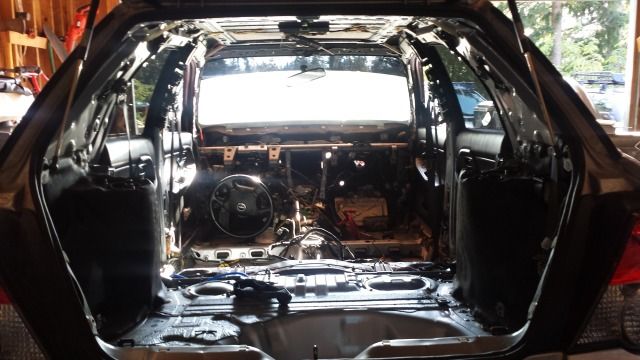

    I spent the rest of the time getting the interior the rest of the way gutted. The fold down bench seat in the rear was taken out ( I plan to run four chairs) as well as the carpet and strut tower covers.

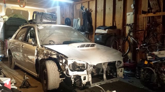

    The car sat for a weekend and then got loaded up onto a flat bed to go up to the fabricator.

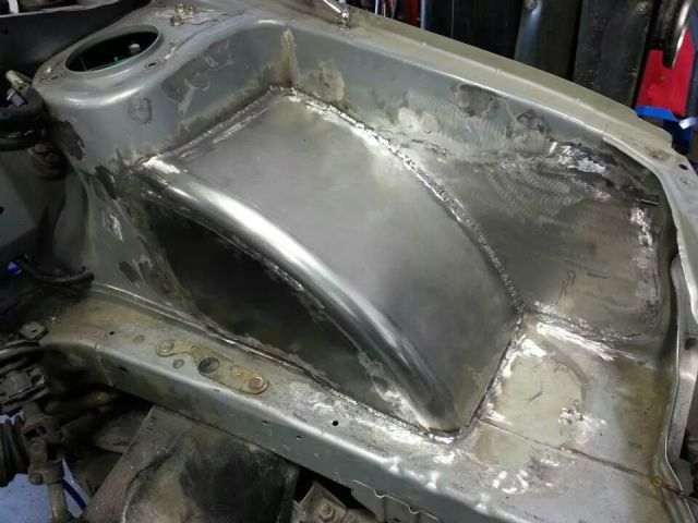

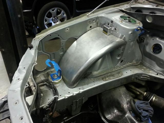

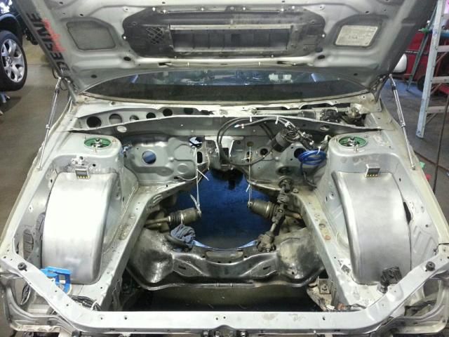

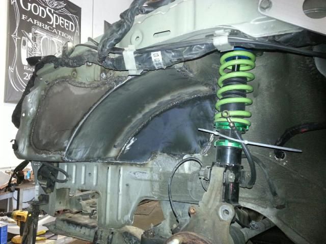

    I got these photos today of the front tubs mocked up and I am beyond excited!

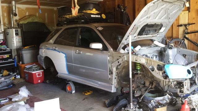

    And just for fun, here is a teaser of the widebody rear end mocked up on the car:

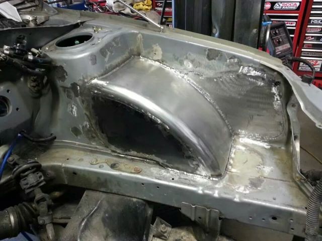

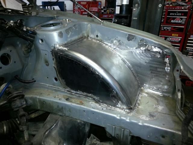

                        Updates!
                        Got my 5 speed, 18g and injectors sold today. More money to dump into the hoopty!

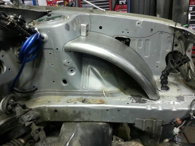

                        Enjoy some updated progress shots from the fab shop. I'm getting excited about how this is turning out.
                        I'll post more photos as I get them.

                              I made a trip up to the fab shop on Friday to check out the progress of the car. As of now, the front end looks just about done. There are a couple small things that need to happen, but it's pretty close.

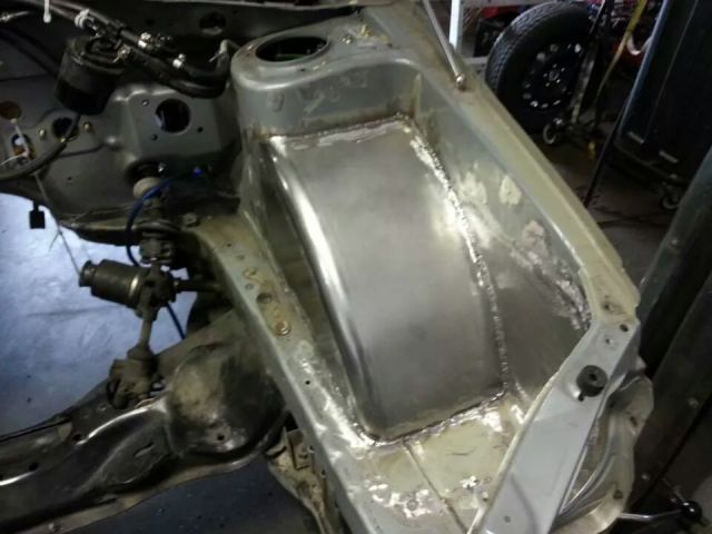

                                I was able to get up to Godspeed Fabrication on Friday and check out the progress of my car.
                                Firewall:
                                Rear tubs:
                                We made a decision on the passenger side rear tub to not cut into the "pocket" that holds and reinforces the fuel filler neck. I wasn't committed to having a custom fuel tank fabbed and fit into the car, so that was our next reasonable option. I'll have to do some work with body filler to take care of the gap and smooth everything out.
