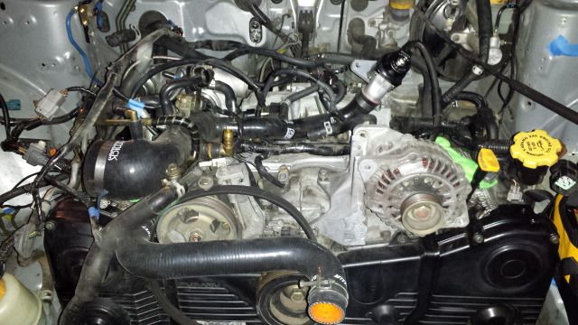

Got a little bit done over the past two days. The first thing that I did was label the brake lines coming off the ABS module, and then disconnect them. I didn't even think of using a flare wrench to do it, so unfortunately, I stripped out one of the fittings on the proportioning valve.
After I had the lines disconnected, I removed the module off the harness the same way I did with the fuse box.
I also was able to delete the cruise control, and start moving the part of the wiring harness that was on the firewall. It sits on the outside of the wiper cowl. What I think I'm going to do is drill one hole in the wiper cowl, feed the harness in, and run it in the cowl. Should clean it up a bit. Because I'm not doing a full shave/tuck, I'm really not too worried about making one small hole. I think the benefit of moving the harness out of sight should make up for it.
