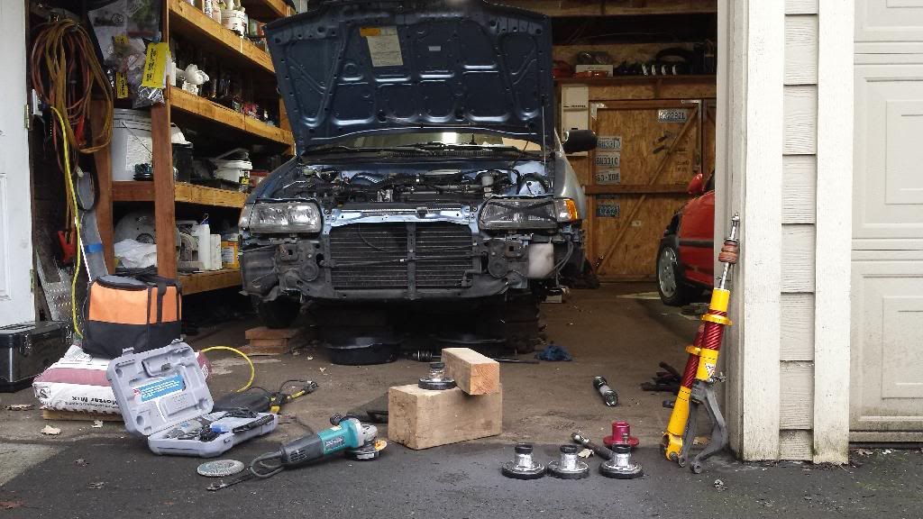

      Well I decided to start piecing stuff together today after work not much done because i have doubts in the Ebay tophats that im not sure if i should use or not? If anyone has input on this let me know. Or maybe i should just get Ground Control tops hats and call it a day
      The eBay top-hats these bushings that are hella stiff not sure if it will cause me issues. I have pictures on what i mean and also had a question to the people that installed top hats on their suspension. Pictures down below will do the talking because it will take me a while to actually explain on what i mean.
      Btw the coils are set to the highest level because i was check them out and set them their so the spring doesnt flop around since they are still no installed. But i will be maxing it out once i put them into the wagon
      So my rear suspension set will not have top-hats as seen in the pictures because i dont want the long as hats sticking out of my quarter panel plastic trim, and there is not much stress on the rear end anyway.
      My front setup will definitely have top-hats just unsure if i should use these eBay ones?

      If I were you, I would get your stock tophats modified/extended. That's what I did. You can measure the rear and extend them as much as possible and still keep the plastic covers, since they will be custom made you can make them whatever length you want. If you take them to a metal shop in your town and tell them what you want done, it shouldn't cost much. Probably around $50 I'd guess, they'd just have to cut it and weld in a new piece of metal. Like this:
        I like the idea I think im just going to do that since the stock ones fit so nice and look a lot more legitimate. How much did you extend yours up front, and how low are you? Just curious.

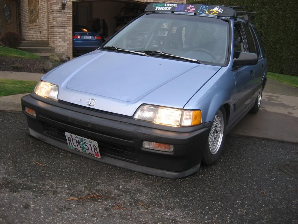

              im hoping to slamm this slut as much as i can go with my gc/koni yellow suspension upgrade but problem is my driveway is probly by far one of the worst to drive in with a lowered car, meaning not slammed lowered! so when im slammed whats gona happen, screwed most likely.
              need a custom ramp or something
              this was on my old shitty ebay coils and those riken i no longer have.
              gotta love those driveway pull ins. haha.
                  It's been a while since I've had the wagon, I want to say they were 1.5" tophats all the way around. I think I could still get the plastic covers to fit on the rear. I didn't measure how low it was when I had it, but I ground off a good inch probably off of my front mudflaps. I still had pretty decent ground clearance though, didn't really scrub until I hit a decent bump in the road. You will probably be lower than my wagon was since I had 16s.

                        I finally got my stock top hats extended welded, did little grinding and cleaning on the welds turned out nice. better than the shitty ebay hats.
                        Ive been really busy with my e36 project so not much update on my shuttle just torn and slowly piecing parts together.
