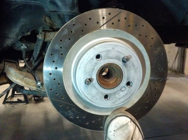

Rear rotor and everything looks good so far

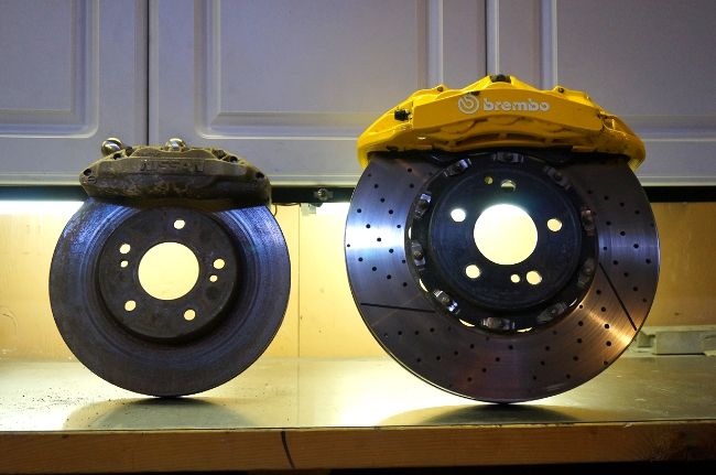

Just for size comparison here are the factory front brakes compared to the Mercedes black series Brembo's
