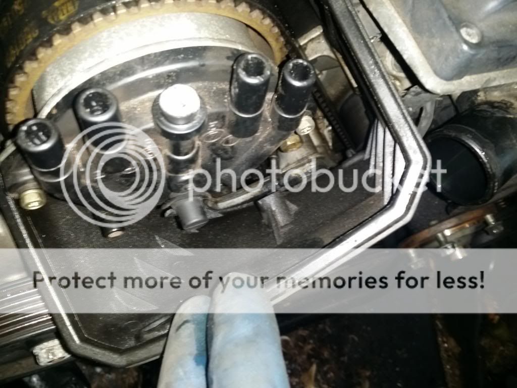

              Today was an adventure LOL....what I originally thought was the oilpan was not the source of the oil leak. The cam and crank seals are notorious for leaking in these things when they are skipped over during the 90k service. My seals...are original. 217k, 22+ years old. Bone dry and wedged in there so tight i took a chunk of skin out of my finger trying to remove the bastards.

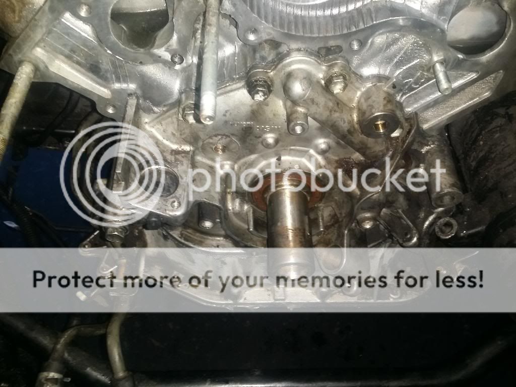

              The oil pump housing had enough oil on it alone and the gasket material,so loose/oil soaked along with the large volume of oil we have seen on previous occasions to finally make the decision i dreaded all along...pull the oil pump housing off the block and see what is going down.
              A few random shots of the cam pulleys and the oil dripping behind them/on them
              heres a few of the Oil pump housing prior to removal.
              Heres the oil pan being dropped and the housing removed
              and a few of the inside of the block.

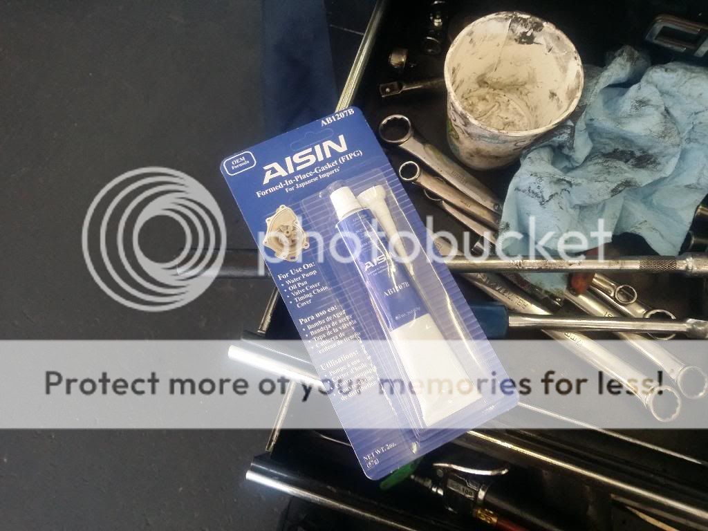

                So today was met with success and failure. I need to get this thing out of the fucking shop already. Boss said it was cool as long as it didn't interfere with regular customers, didn't tie us up from a bay, and I wasn't milking the clock. Stay off his time and use common sense? Sure I'm with it.
                Anyway start the day off with remembering to get some real sealant for the water pump. Ran next door to NAPA and picked up some
                Started up where I left off with this

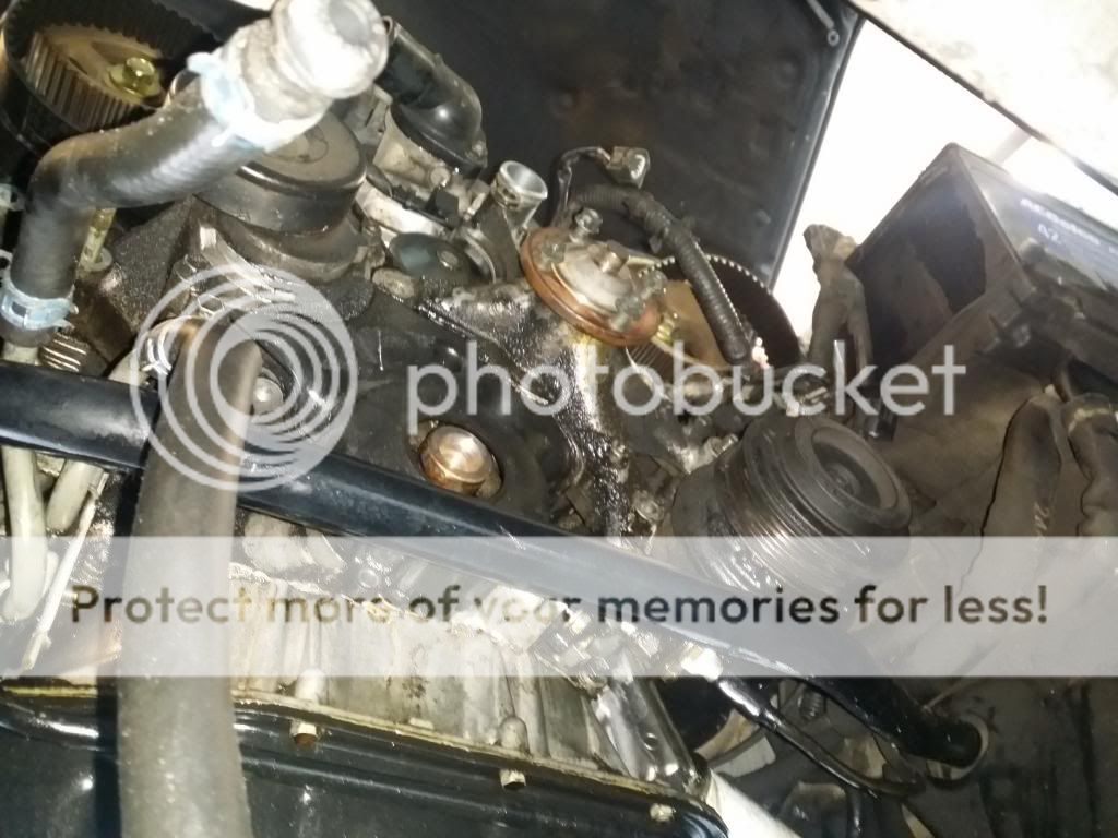

                Well here is where the bad comes in....Seeing as I have been in a rush to knock this part of the project out due to time and space shrinking fast....I have misplaced my Crank position sensor. No idea if NAPA has one. Seeing it for various prices from sources so its not a matter of getting one at all...just how fast can it be in my hands ready to get popped in -____-. Also my coworker managed to accidentally snap some kind of sensor clip thingamabob on the driver side front of motor. pics of sensor clip thing and its relative location. Any idea wtf that thing is? How bad do i gotta beat him with a stick LOL?
