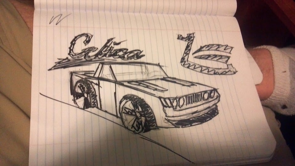

      And I did a thing. Ever since I saw the Hakosuka Skyline/Nissan Sunny hybrid, I thought 'how cool would it be to have a Celica ute?'
      Skyline:
      1973 Celica
