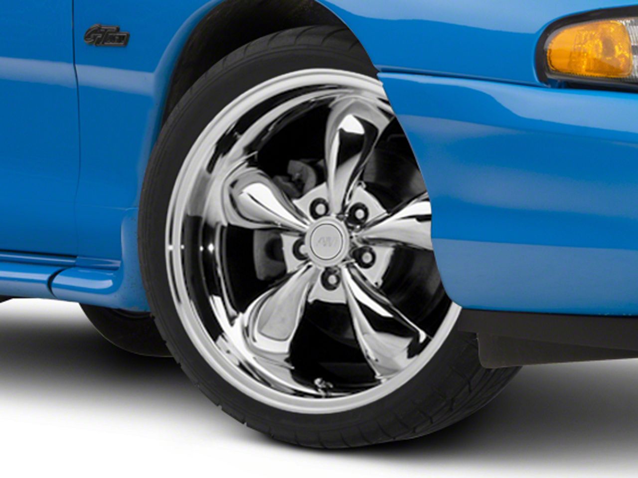

                            IMO chrome Bullitts would be on point. Awesome build man, had an opportunity to buy a Crown Vic LX Sport one time and passed it up...I kick myself pretty often for not buying it
