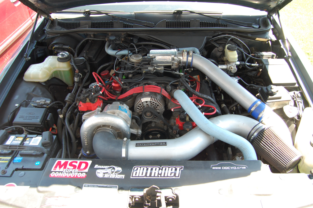

                      Nice work on that bracket.
                      A guy built a sleeper turbo Town Car (same 4.6 2v) and he runs 11's in the 1/4 mile.
                      So that's always an option for you..

                                Just a idea. lol
