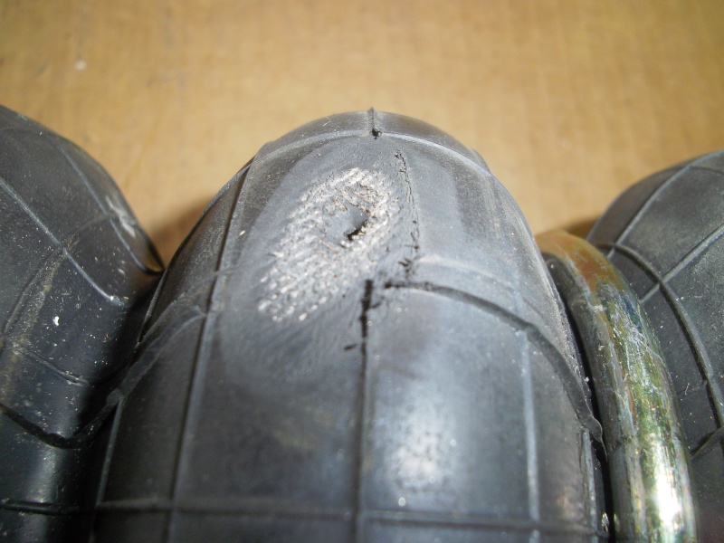

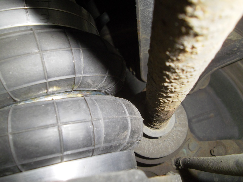

had a little airide-problem saturday night...
ass down, little and then big air leak at the rear air circuit
the next day finding the leak :

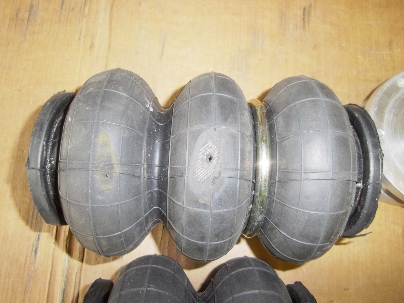

hole in the airbag...because 0 clearance with transmission axle... not very smart... even if the mounting process was done by night with headlamp...

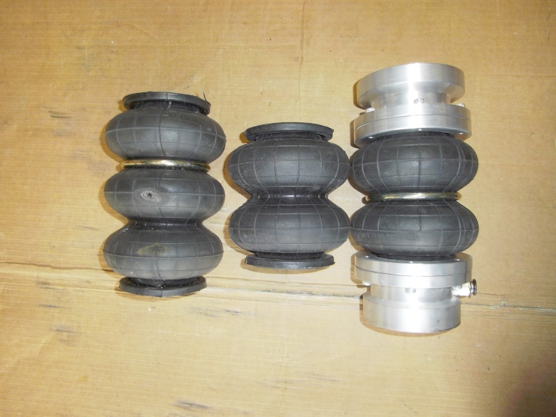

pics :

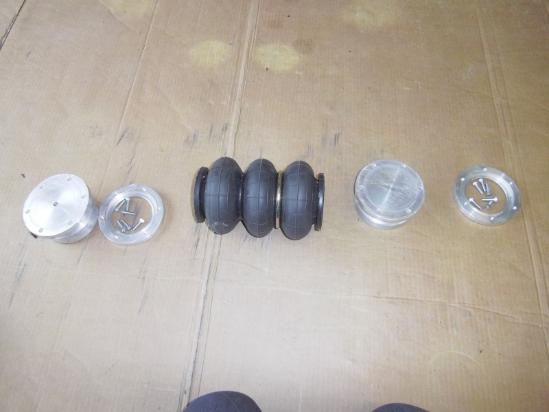

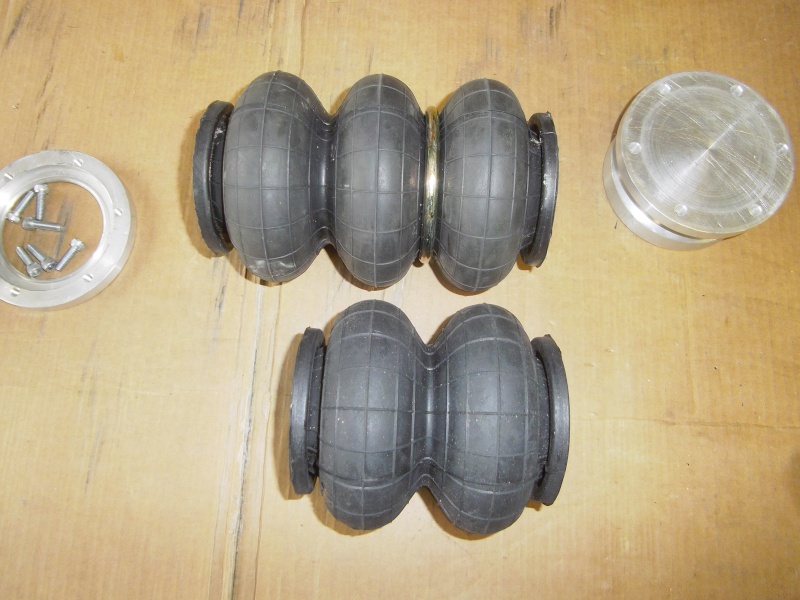

separation of the airbag from the mounting brackets

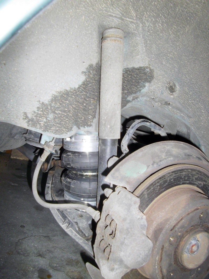

and re monting with 2 ballon airbag instead of three... when i purchased airbags by the the polish company, i had to choose between 2 ou 3 balloons airbag... wasn't knowing what to choose and price of one was only 20€... so i purchased 4 airbags with 3 balloons and 4 with 2 balloons
hop

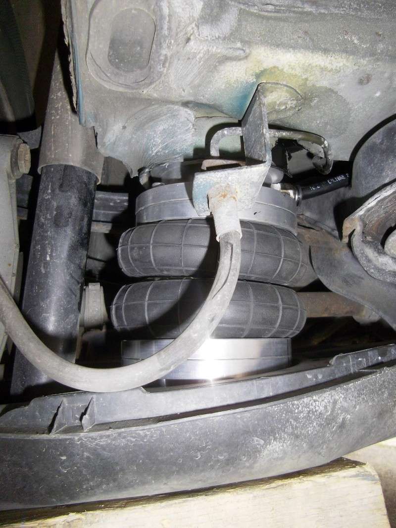

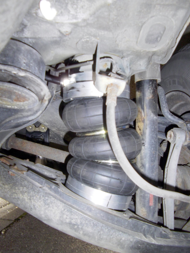

mounting on cars :
instead of :
and now much better clearance with transmission axle
difference is : it goes not as high as before... but it goes much lower.. that means better!Last edited by RENAUD; 01-30-2014, 04:14 PM.cheap bagged 190 benz http://www.stanceworks.com/forums/sh...highlight=190e

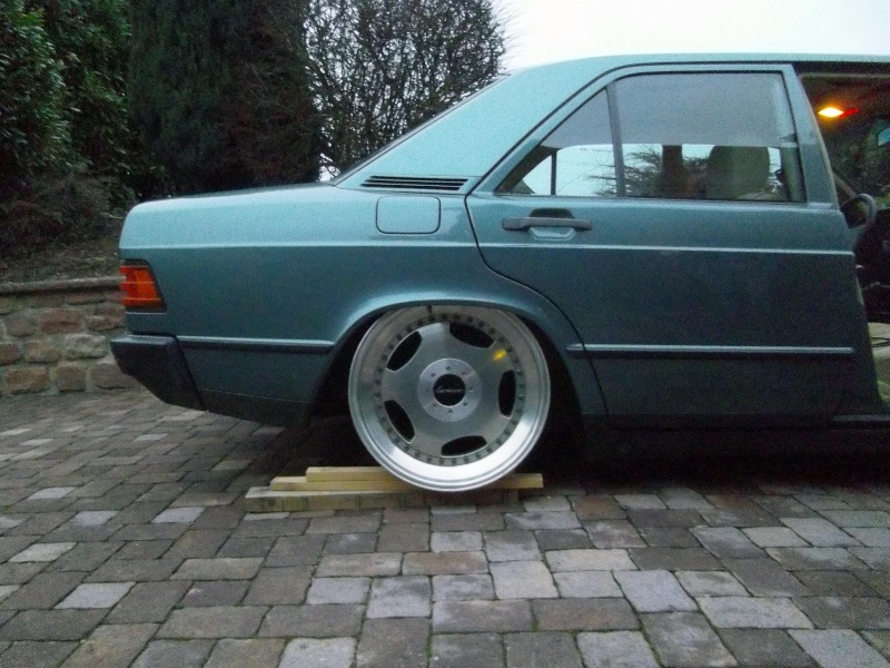

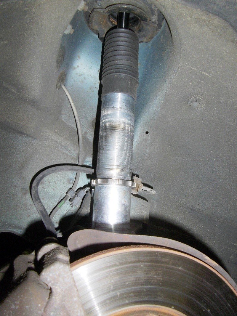

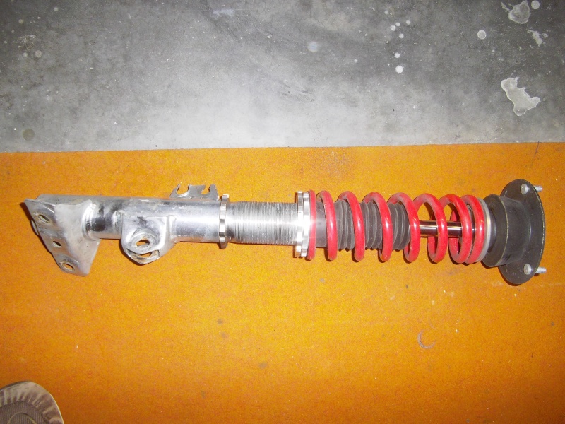

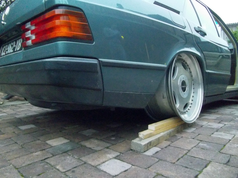

think I'm not going any lower in the front...
frame rail touching steering tie rod : [ame="http://www.youtube.com/watch?v=EQNSR9Vld6g"]biellete de dir - YouTube[/ame]cheap bagged 190 benz http://www.stanceworks.com/forums/sh...highlight=190e

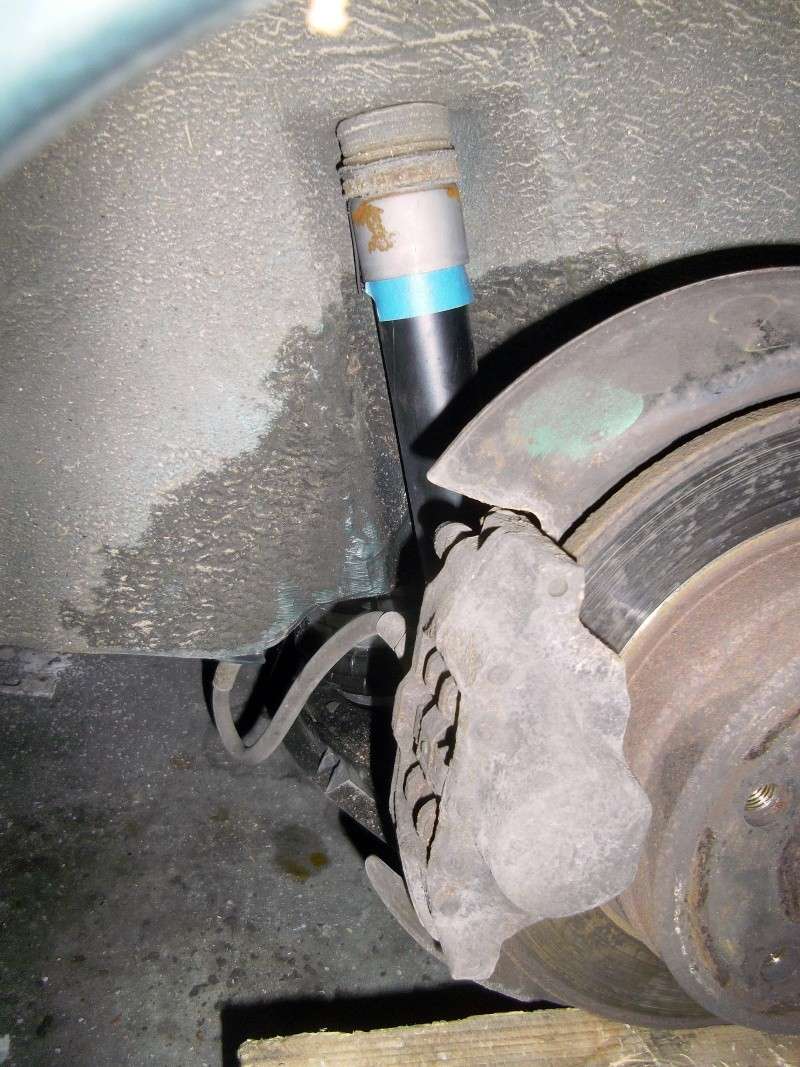

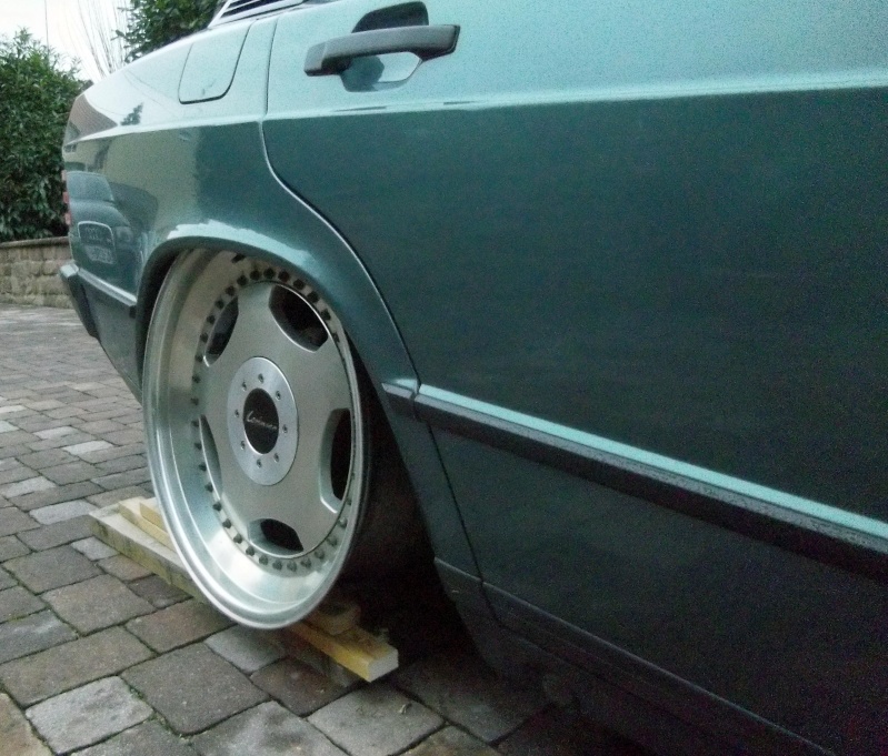

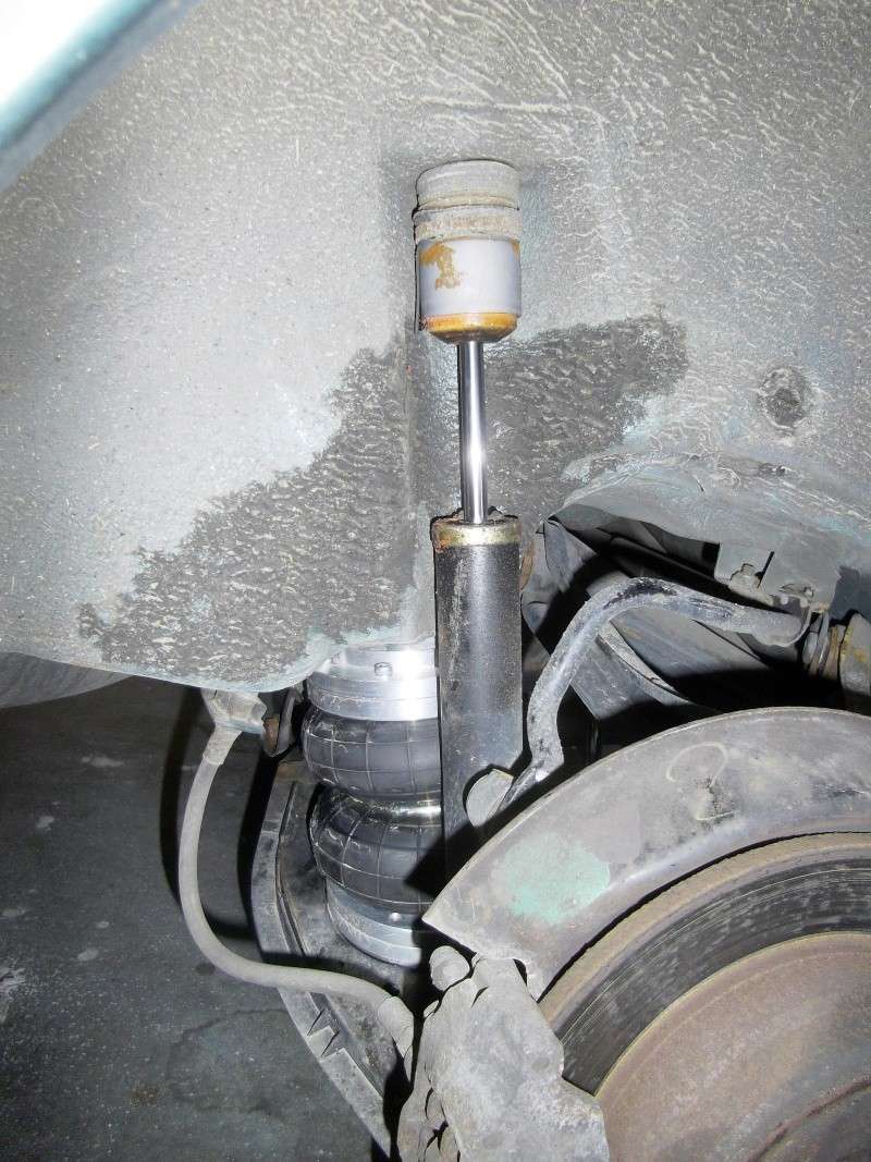

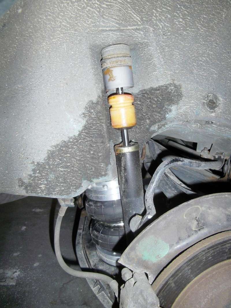

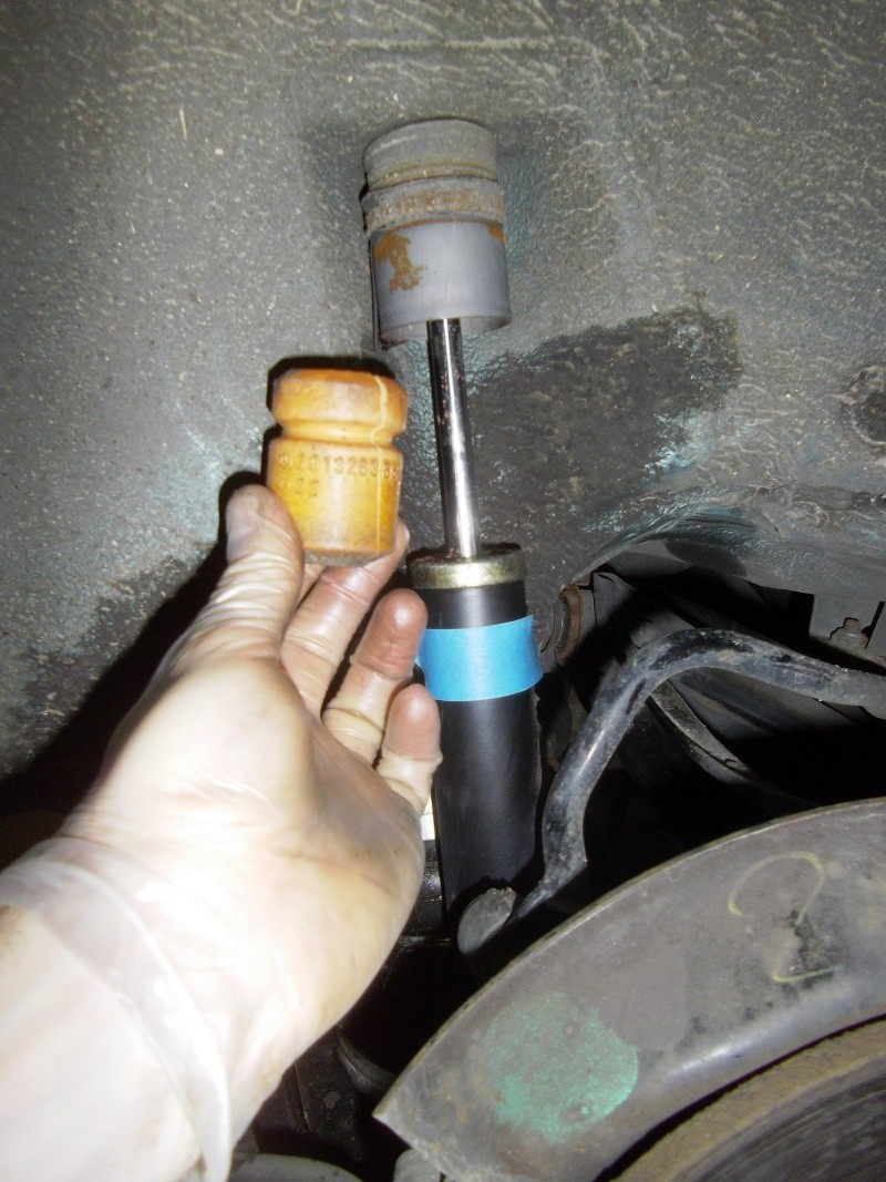

today, I've done a last thing to make the rear go a bit more lower, I removed the bumpstops from the rear shocks
very simple, not even necessary to remove the shock, just the wheel... take a cutter and done

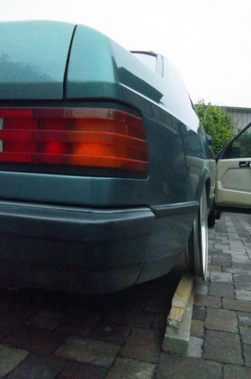

that's it, 15mm lower! (more than half an inch)

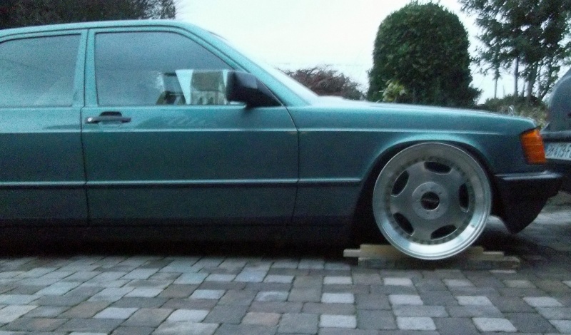

and the result after modifying this last 2 weeks : http://www.youtube.com/watch?v=BUoMV...ature=youtu.be
and a few pics
very happyLast edited by RENAUD; 02-02-2014, 03:36 PM.cheap bagged 190 benz http://www.stanceworks.com/forums/sh...highlight=190e
