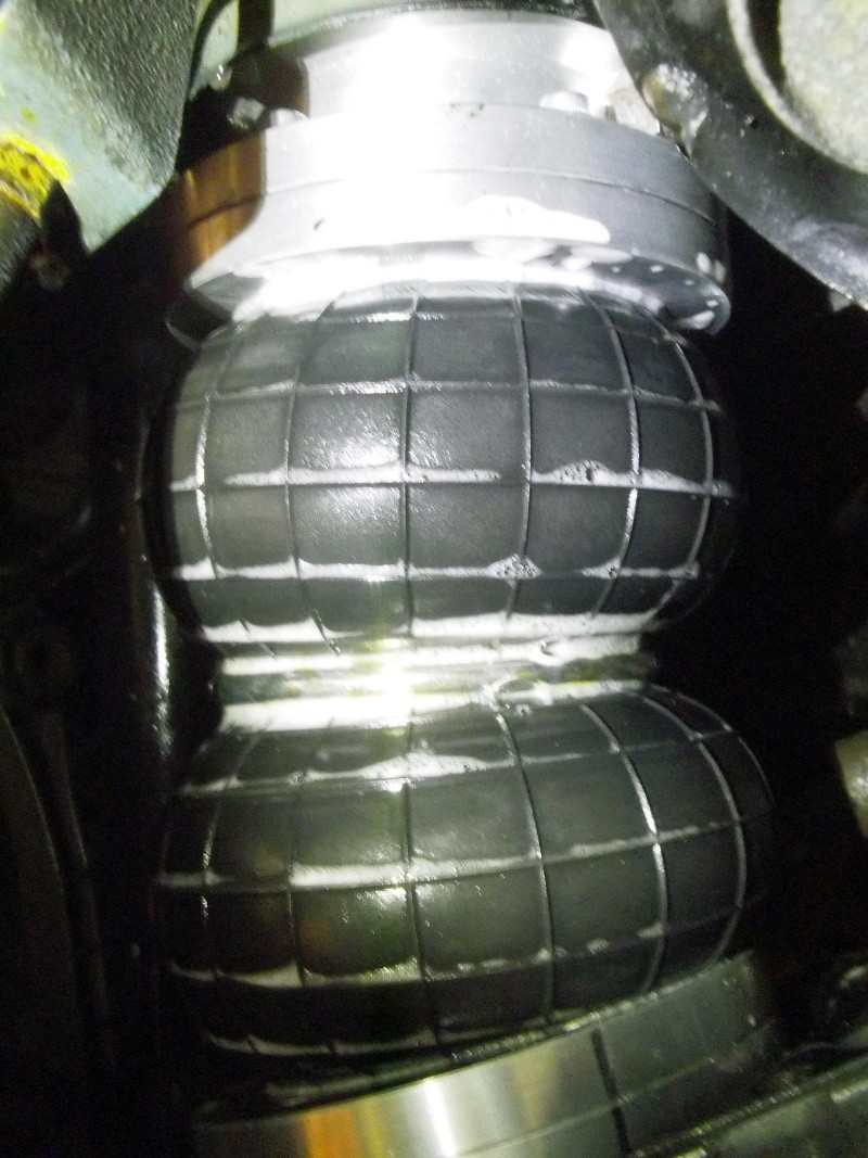

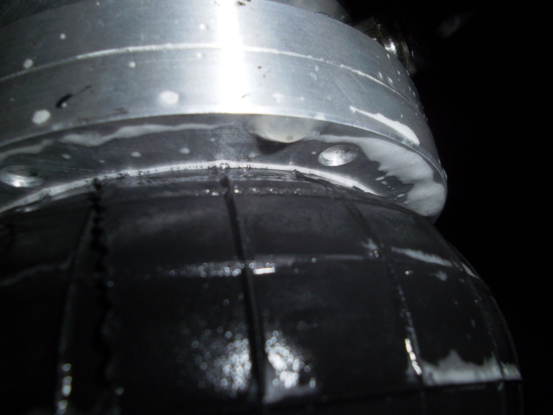

    • yesterday and today searching air leaks on rear airbags

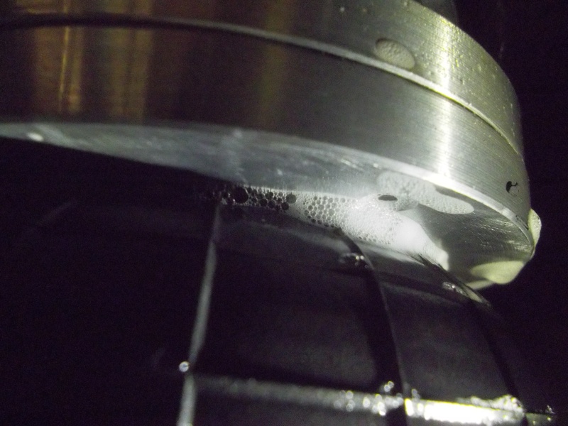

      a floor jack, water with soap and go!

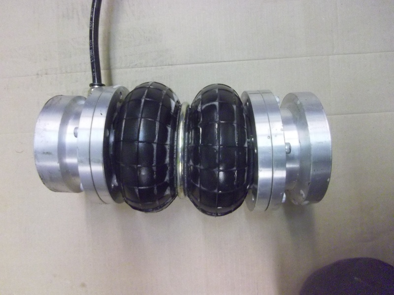

      today I'm focuse on the one on the left (right one done yesterday)
      nearer :

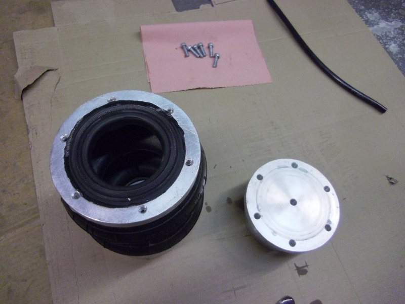

      removed the airbag
      dismantling the 2 aluminium parts of the brackets that press and enclose(?approximative english?) the rubber
      mounting again but this time with a lot of WD40 between rubber lip and the 2 aluminium parts
      when I mounted them 2 weeks ago that was without any grease or soap or WD40, sadly rubber was sticking to aluminium, so I can't make the 2 aluminium parts touch eachself and enclose correctly the rubber lip, don't wanted to torque the screws too much, thread is dirct in the aluminium...
      but this time, it was very slippery and so... good!

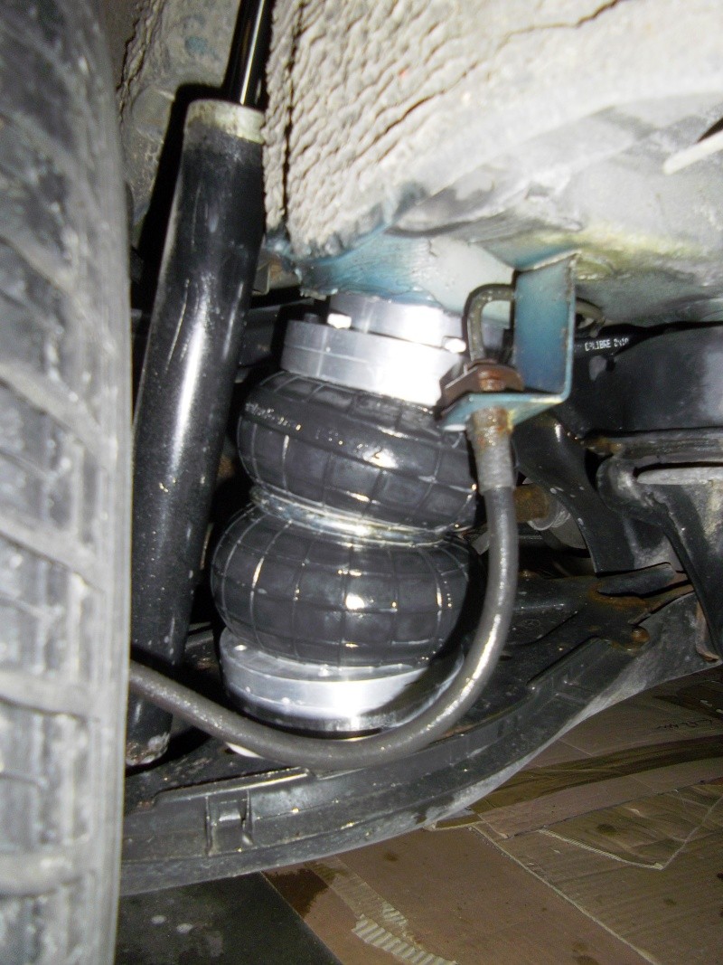

      re mount on car, put airline, give some pressure and re-test with water and soap... and alright! no more leak :
      was rather happy and so just for fun, put the car on its wheels and made 2 pics of the airbag :
      off-road mode
      in-the-ground mode

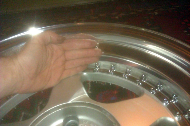

          • arrive from the day :
            just a little test for fun with a center not yet redone...
            and I have big hands lol my size is near 1.90m tall

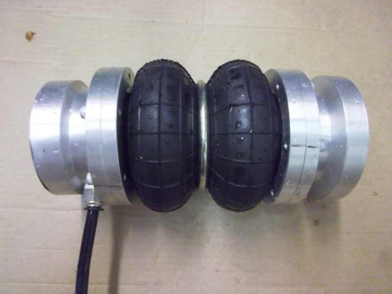

                            • So as I said yesterday, I swapped my front bags today : 3 balloons to 2 balloons airbags
                              taking off the 3 balloons airbag
                              dismantle
                              the stock
                              re mounting it with 2 balloons
                              re mount it on the car
                              a few bfore & after pics (you can clearly see that the 3 balloons bag goes sideways)
                              high
                              low
                              hope that everything is gonna be good and stay good now
