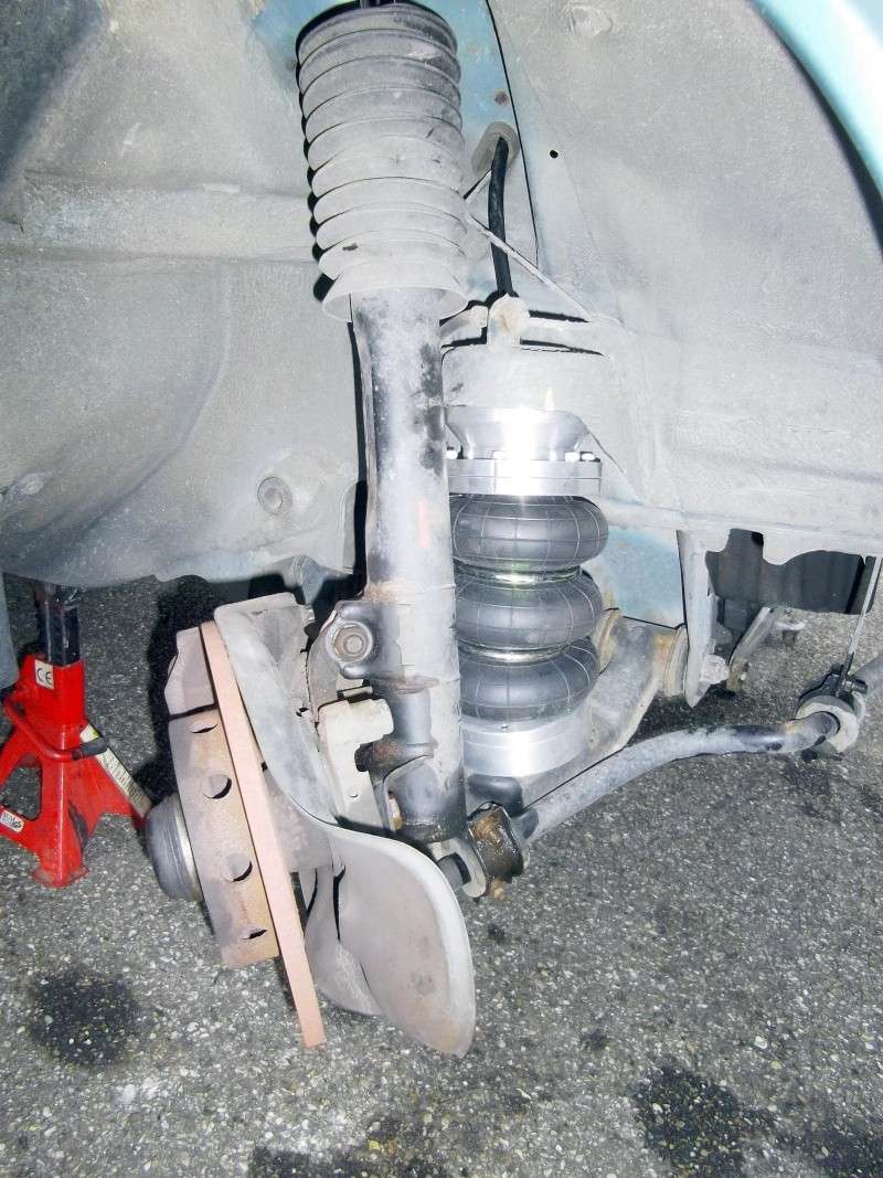

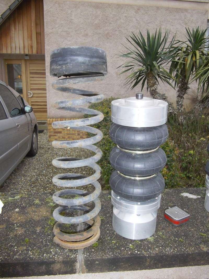

pics of the bags mount
front :
bag in action : http://www.youtube.com/watch?v=3ZnWo...ature=youtu.be

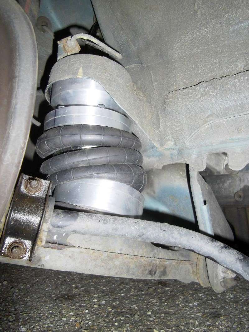

rear :
needed a bit more space for leting enough room for the fitting :
result when you're standing aside :
cheap bagged 190 benz http://www.stanceworks.com/forums/sh...highlight=190e

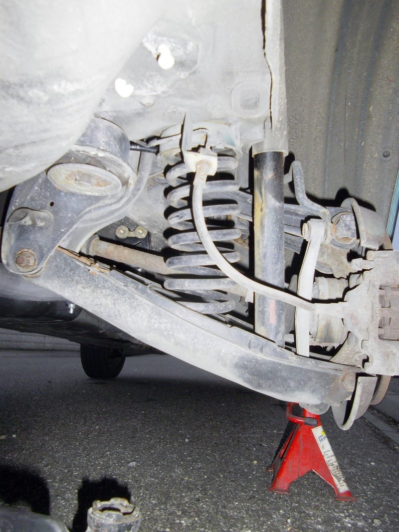

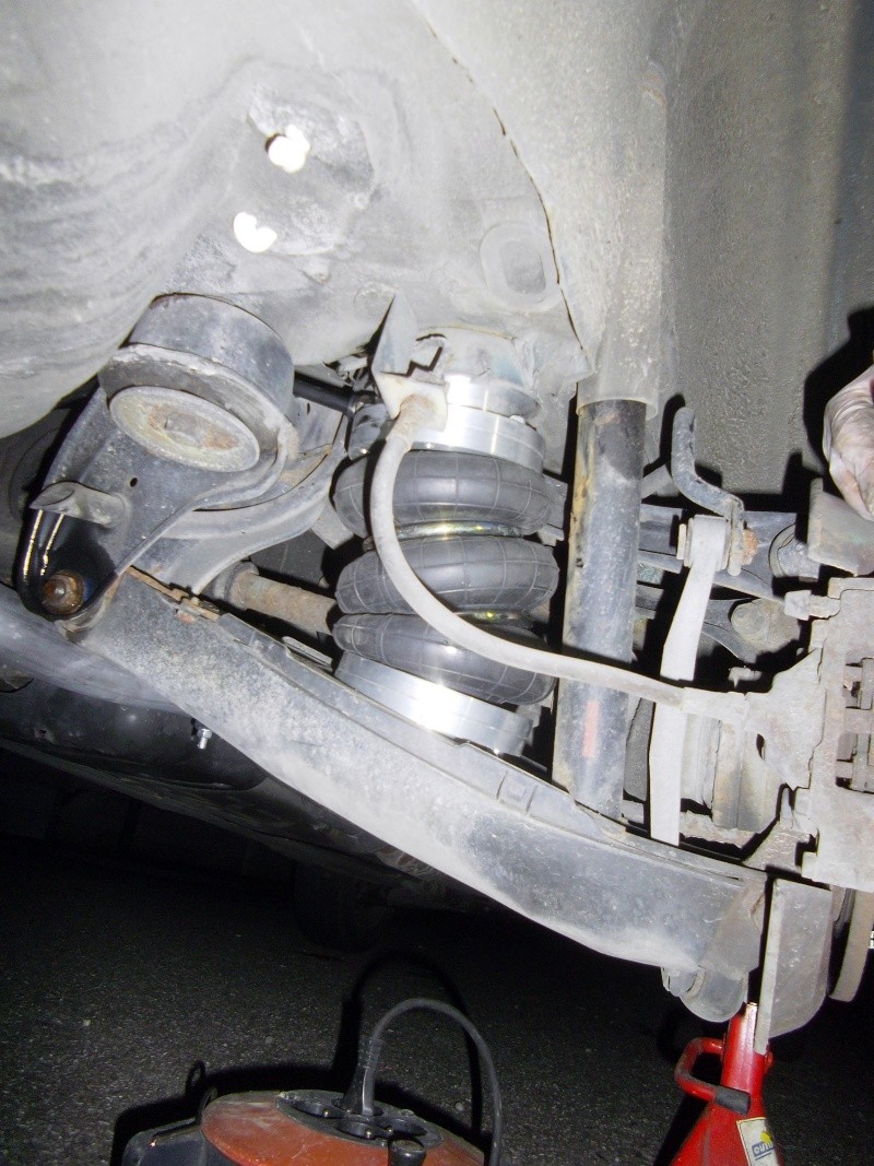

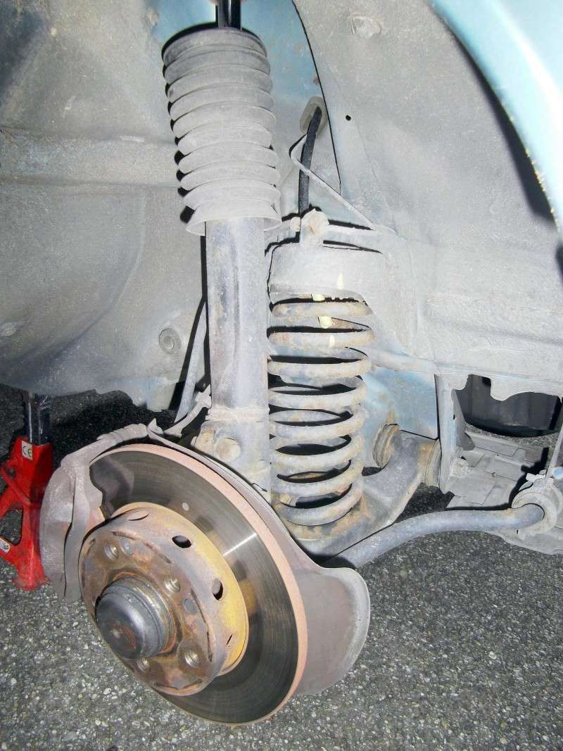

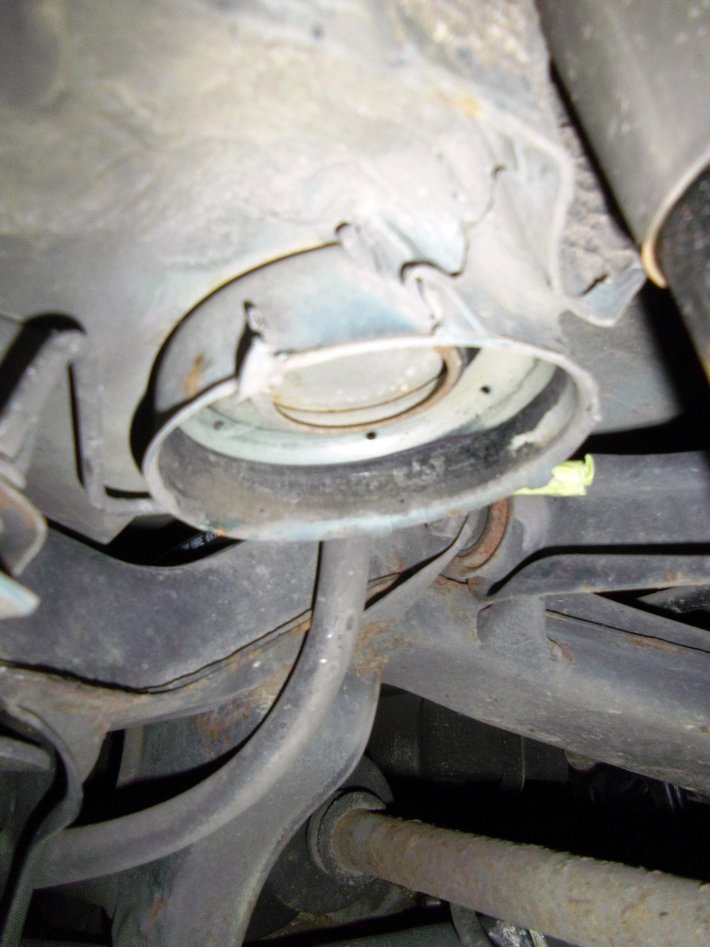

nice build so far, buddy! could you post some pictures of how you fixed your bags with screws to car?
hi, thank's
in the rear the bags just goes right in place of the springs, no screws
in the front there's just a big allen screw and a big shim for attaching to the control arm
here on this pic you can see a front spring and a front bag, at the top of the bag you can see the screw and the shim :

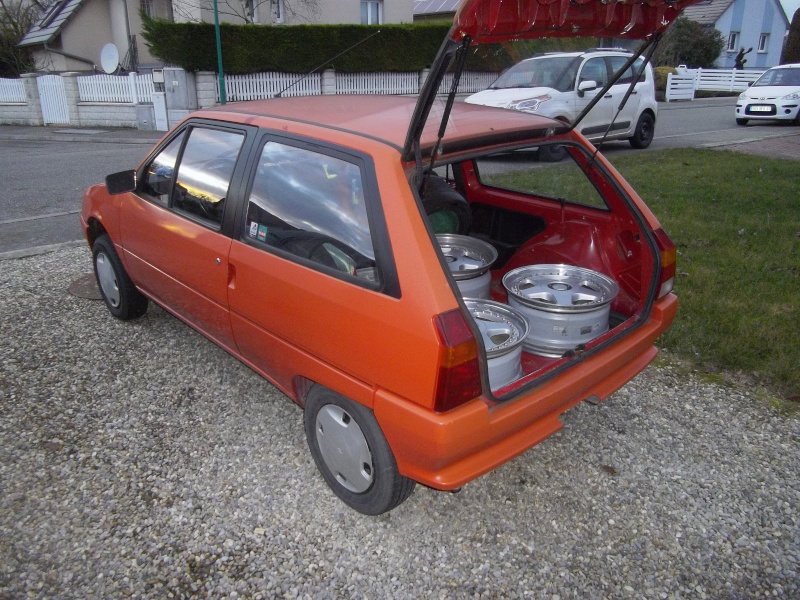

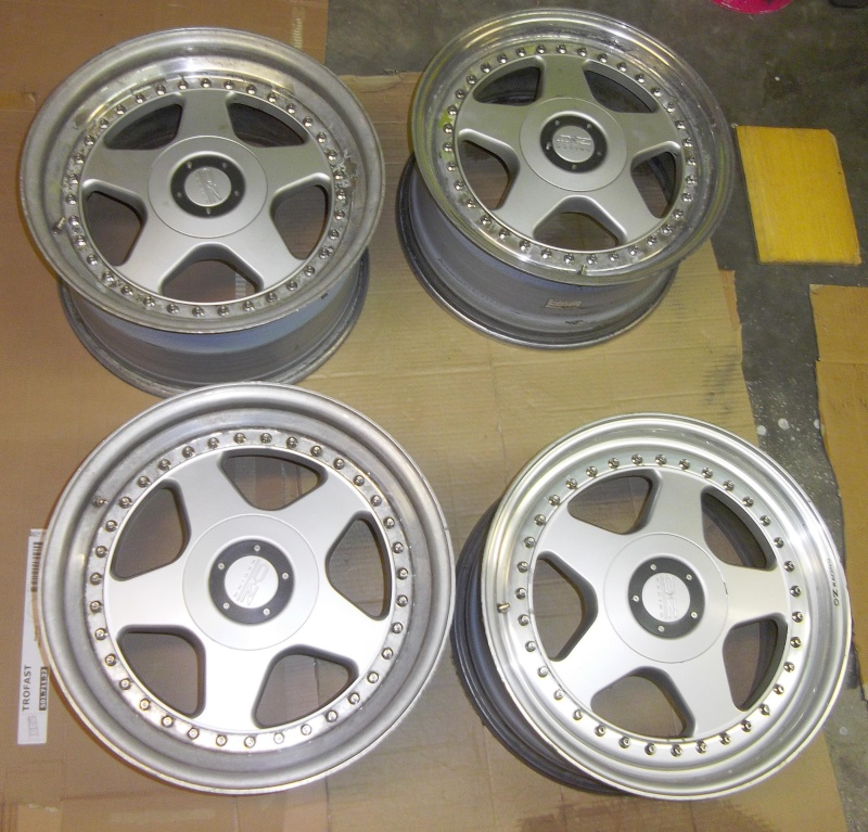

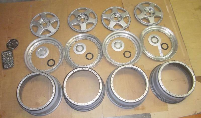

a good friend is selling some lorinser 3 pieces in 19" (centers in 18")... wee just wanted to have fun, it would be 10 times tooooo big for the , car, we wanted to laugh a lot and drink a beer...
but nobody laughed... result was way to nice :
