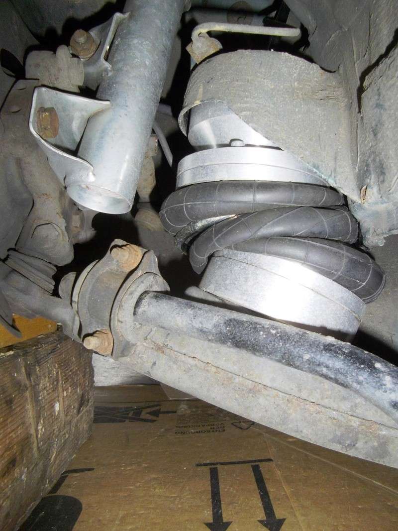

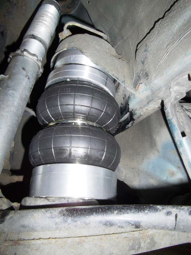

  • loekaaz
    replied
    Originally posted by RENAUD View Post
    So as I said yesterday, I swapped my front bags today : 3 balloons to 2 balloons airbags
    hope that everything is gonna be good and stay good now
    Originally posted by Xavi0n View Post
    is it good for the bags that when aired out the top and bottom of the bag is not centered and the sharp lip of the aluminium corner of the bag holder looks like it`s rubbing on the bag?
    I Think he has a point. Don't you think you should make the bottom bracket in an angle so it sits parallel to the upper bracket? I doubt the bags will last long enough when aired out on a regular basis
    Leave a comment:
  • Xavi0n
    replied

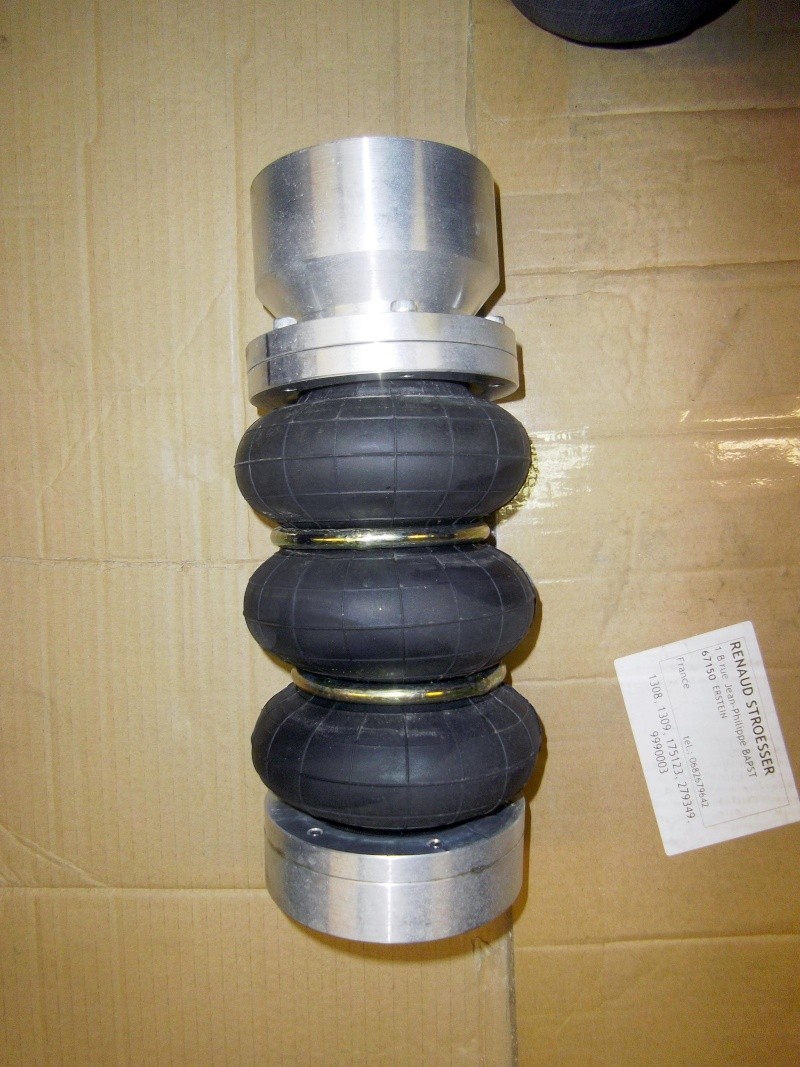

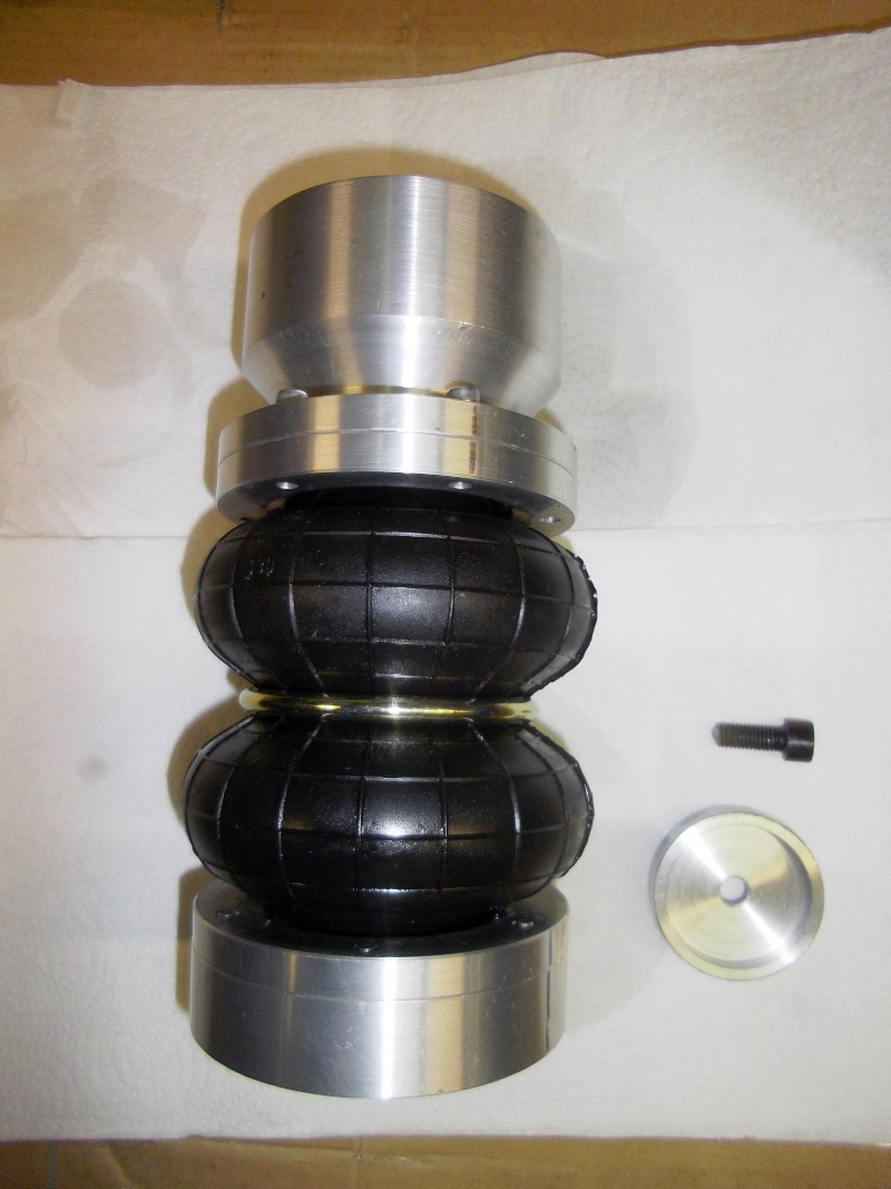

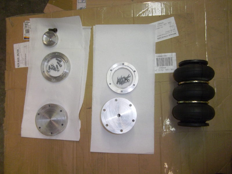

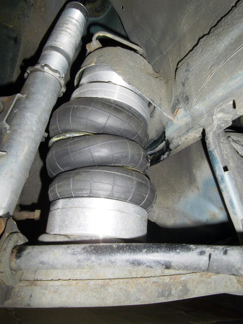

    taking off the 3 balloons airbag
    dismantle
    the stock
    re mounting it with 2 balloons
    re mount it on the car
    a few bfore & after pics (you can clearly see that the 3 balloons bag goes sideways)
    high
    low
    Leave a comment:

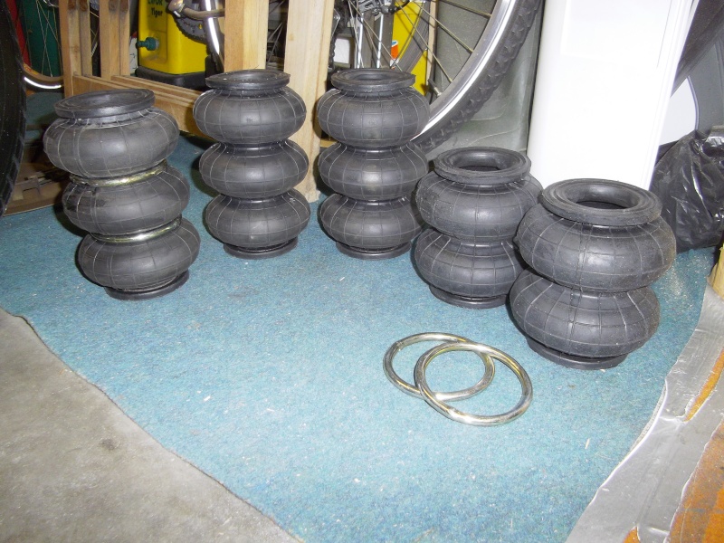

  • RENAUD
    replied
    rear only
    BUT I put them too on the front tomorrow... to see what it's like...
    front shocks (from bmw e36coilovers) are hard, so the car is also harder to lift in the front, it seems that the front 3 balloons airbags are no longer enough efficient with this set up
    the balloon from the middle tends to go sideways...
    so I'll try with 2 balloons in the front tomorrow
