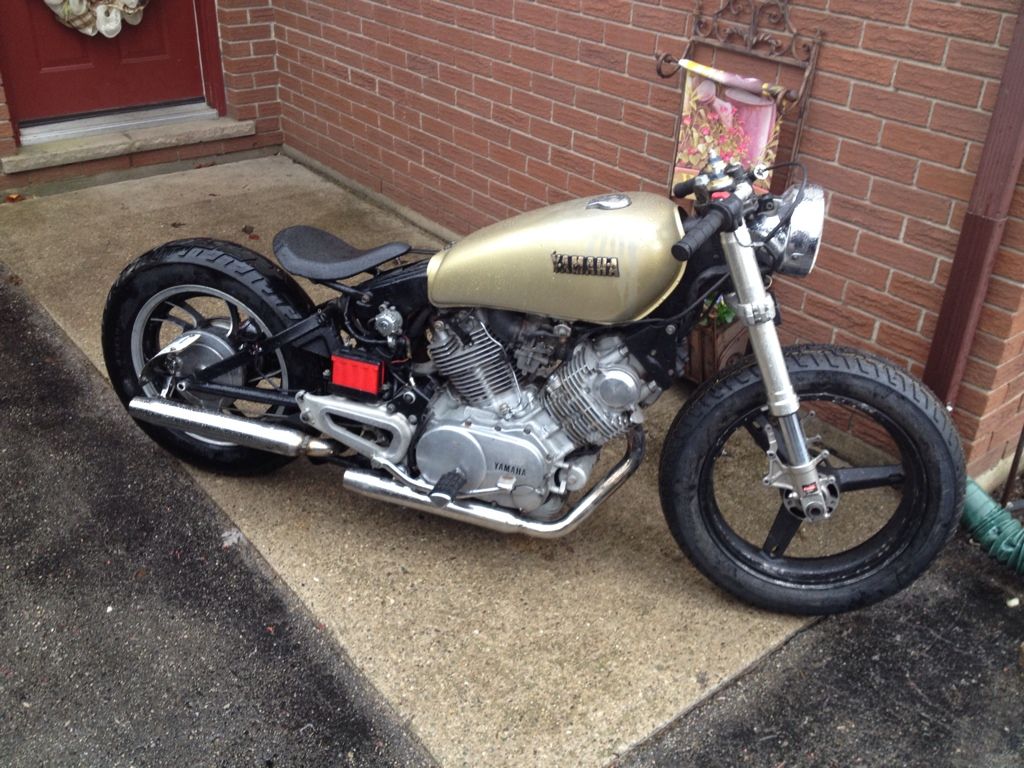

Thanks! front end swap wasnt too bad, I had to have the top portion of the gsxr stem machined to match the virago stem (bearings alone wouldnt work) But I've been told an r6 front end is easier.Originally posted by Static_G View PostIve been wanting to build one of these for a while now. This thread is some inspiration for me to finally start. Will follow this closely. Nice progress so far.
How difficult was the gsxr front end swap?

Unfortunately i don't have any pictures of the machine work that was done..but basically the top half of the gsxr stem was turned down to match the diameter and thread pitch of the stock virago stem...and wiring is just splicing in all the gsxr controls like the start button, kill switch, headlight etc...the wiring can be avoided by using your stock controls insteadOriginally posted by 244Brick View PostWhat was all envolved with this front end swap? I'm honestly, thinking of picking one of these up very soon.. I would like to know what machining was needed on the stem and the wiring? Since, i'm a 1000% noob to bikes.

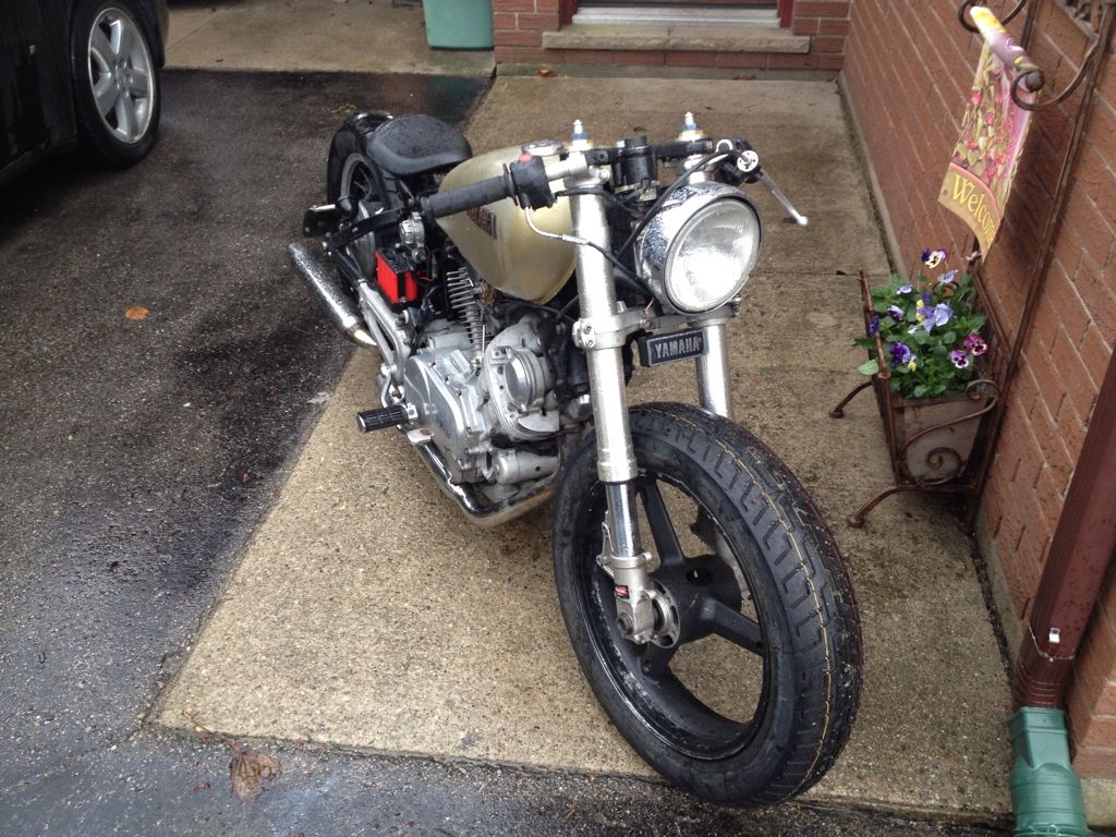

Well I finished wiring everything and did a quick oil change...after that i got the bike started!
Drove it around at the shop for a while. I need a new starter solenoid as it shit the bed..but other than that I'm ready to put this thing on the road!
It drove great, and everything worked like it should. I was really surprised at how well it ran after sitting for a year.
here's a comparison picture of it just to keep it legit (thanks hoowybrow)

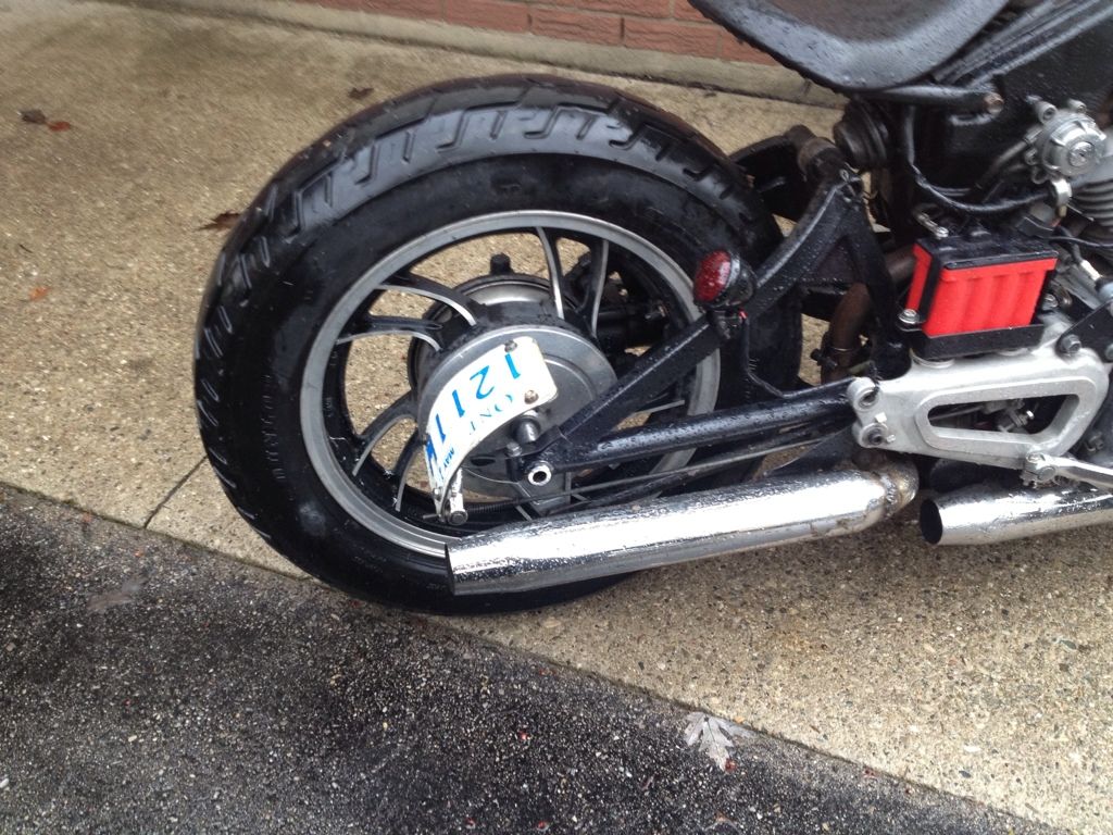

Thanks dude, if you look in the last picture you can kind of see the plate mount that i made..just on the right side of the rear wheel. I'll get several better photos of the bike after i get the new front tire on itOriginally posted by P3Z View Postlove your build man! good work.
I've always wondered, where are you planning to display your number plate?
