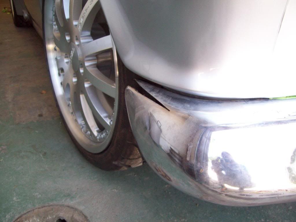

Trim should all go out for straightening and plating this week, but I have to double check fitment on everything now that the body work has been done, because there could have been potential changes... I have the bumpers fitting about how I want them, and I have still have to weld the hiddent bolt studs to the rear bumper, and add a bit of adjustment slotting to the brackets, but it all looks like it is going to fit and adjust well.. In the pics, it appears my front bumper is slightly rolled down in the back, but it does level out just fine, and I was trying to show where I actually pulled the bumper ends outward, in order to get rid of a roll in affect.

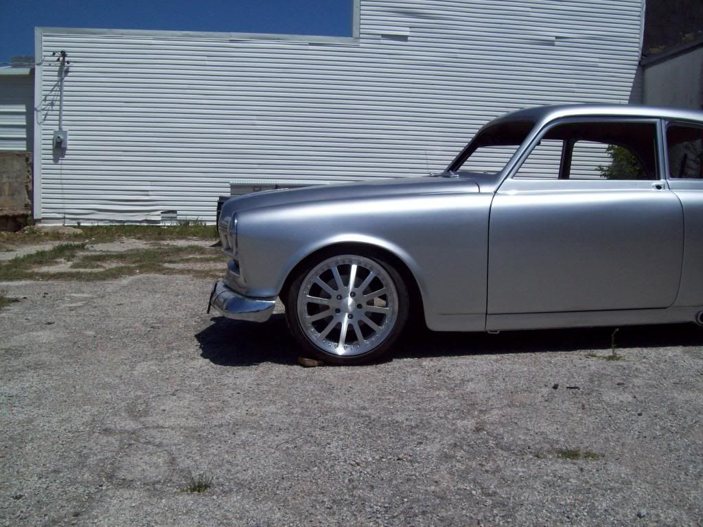

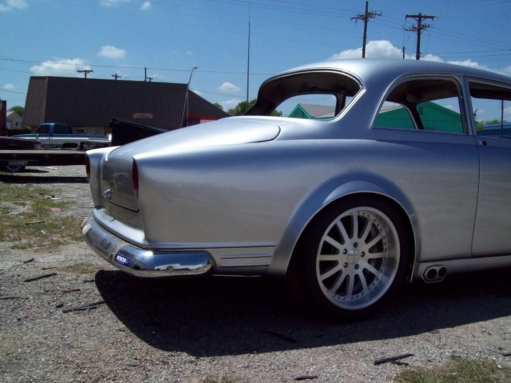

Here you will notice where I had to slice the top corner of the bumper, because I was trying to get that rolling in toward the wheel well affect of it.. I have also made it a one piece bumper, with hidden bolts, so it will give it a clean look. The rear bumper is done the same way, and please excuse the welds, but I was advised not to do any finish welding or grinding to the pieces, because the plater would prefer to do it.
