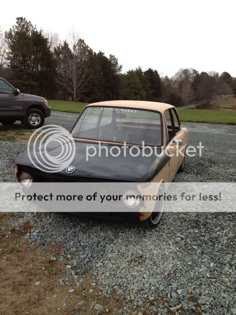

  • tricha02
    replied
    so you'll all shut up, we didnt go to the show, it was raining
    today we got some descent work done
    we got it to run well completely off choke, put better bulbs in the tail lights, and put on a new shift knob
    new shifter, i took a broken breaker bar and ground a flat side onto it then did the same with the shifter, and welded them together, i will clean it up later, but practice is practice
    my welds, this is the thickest metal ive tried to weld, so i turned the heat up a lot, and i could really tell that it was bonding and penetrating, i also put rust proof primer on it now
    alex cleaned the exhaust up really well
    we headerwrapped the exhaust, and also hung the exhaust up better, and higher which involved putting some holes in our beautiful trunk
    air filter we jacked from alex's dad's car, almost fits, but is kinda tall so the clips wont fit, but zip ties are cool
    hood is black now
    it did start to rain before it fully dried
    so it got just a bit of that weird patterning that is on the body
    also i dont care what you say but this car rocks the shit out of a black hood
    this was the point where the car took a crap, we went to restart it after doing the lights, and it wouldn't turn over
    it was getting fuel not spark
    we changed the distributor cap
    nothing
    we changed the coil
    it started for a bit but was running like ass, like it was on 2 cylinders
    i tried to give it gas and it died, it wouldn't restart it after that
    i think we need to tune the points, but i still dont know why it took a crap so suddenly
    any help would be appreciated, but im guessing 2002faq is a better bet for that
    hopefully we can work that out so we can drive it
