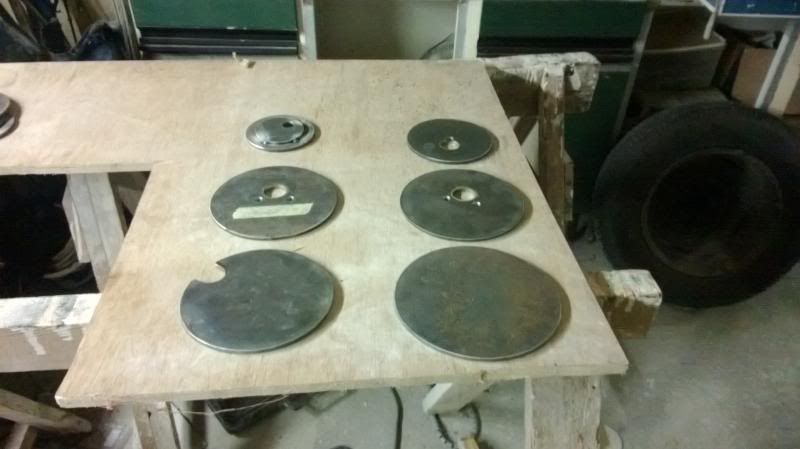

      Just finished wiring the accuair controller into the car. These are the plates I had cut to mount the airbags. The ones one left are for the front and the right discs are for the back, They still need some holes to be drilled and I need to cut and weld some spacers for between the top plates. They'll make more sense when I take more pics, but I'm shamelessly copying Niscort's set up at the front

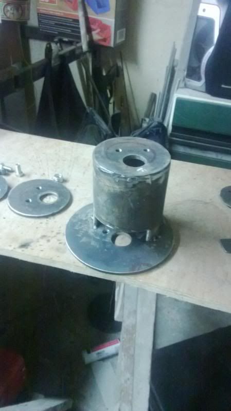

        I started mocking the front mounts, trimmed the subframe and control arms not to rub against the bags. The spacer 2x2 section is just for mock up, I will replace it with pipe of large diameter to have better weight distribution. The length of the front spacers is 127mm (from Niscort's thread) but I still need to figure out the length of the rear mounts. It will be easier once the bottom end of the bags are tied down so they won't move around.

              My aim is to finish front end before starting the rear, even though I've been planning on how to bolt together the rear mounts.

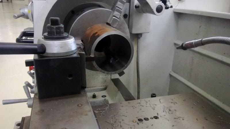

              I have access to a lathe at work, so I skimmed the ends on the pipe to get a total lenght of 127mm. I realise the pipe thickness is a bit of an overkill, but it will take a thicker weld, and its not too heavy :S
              1 mount is almost done

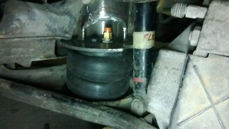

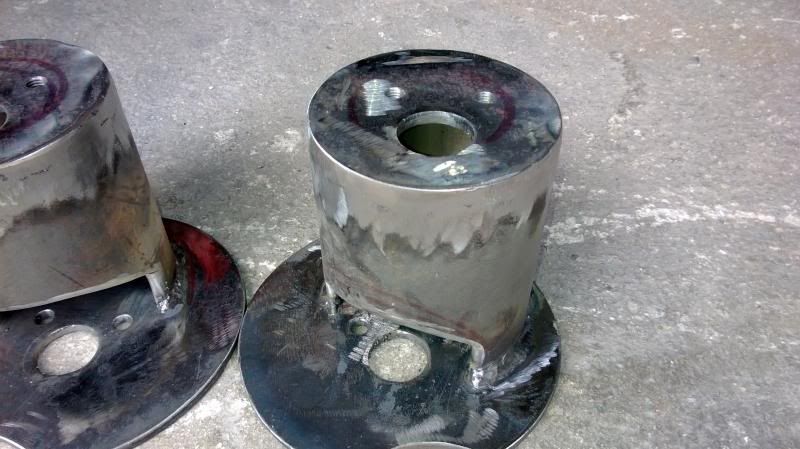

                damn, it was a lot of work to get here, but at least the stock shocks work....I plated the hole on the side after this pic was taken. Just need to grind the welds and paint then mounts, then its on to the back

                  Front mounts are fully welded and ground. I've painted them satin black and installed in place with the bags. Today started working on the rear mounts....pics soon. My plan is to finish the suspension for a show on the 8th December but it seems like there's still a ton of work left to do :S

                        Thanks for the comments, I took a picture of the front assembled. I brush painted, would have rather stripped it down and sprayed the assembly, but time is tight. It will end up covered in dust anyways.

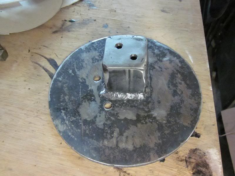

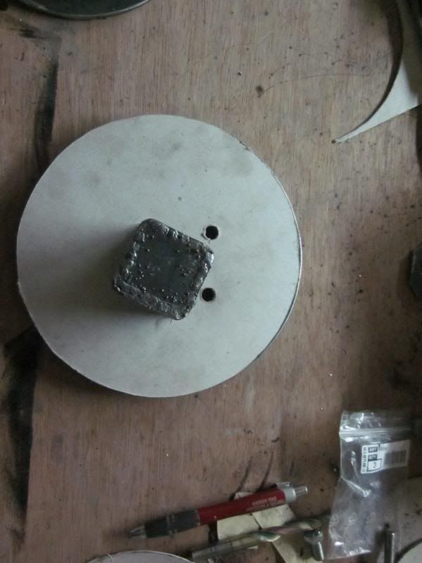

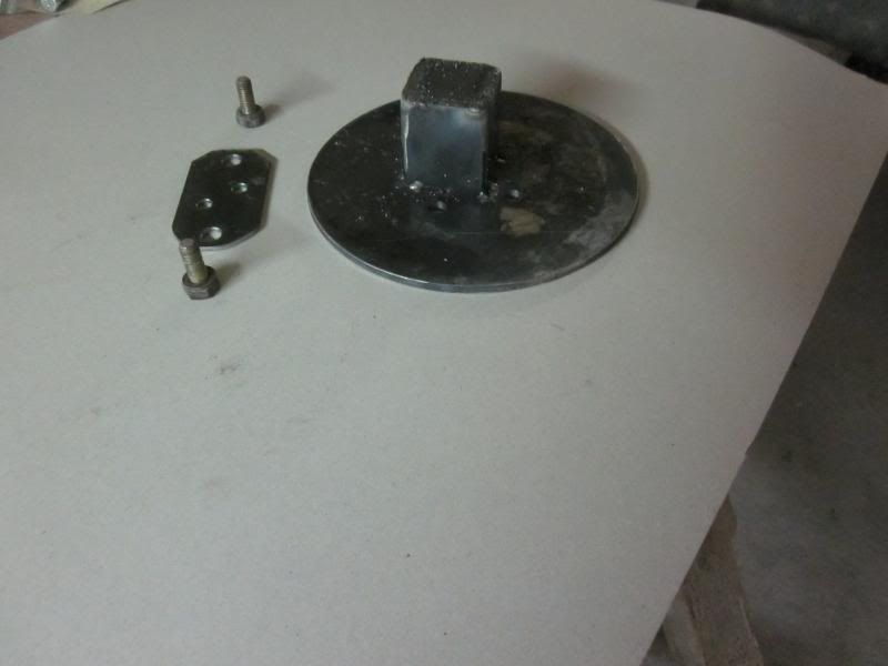

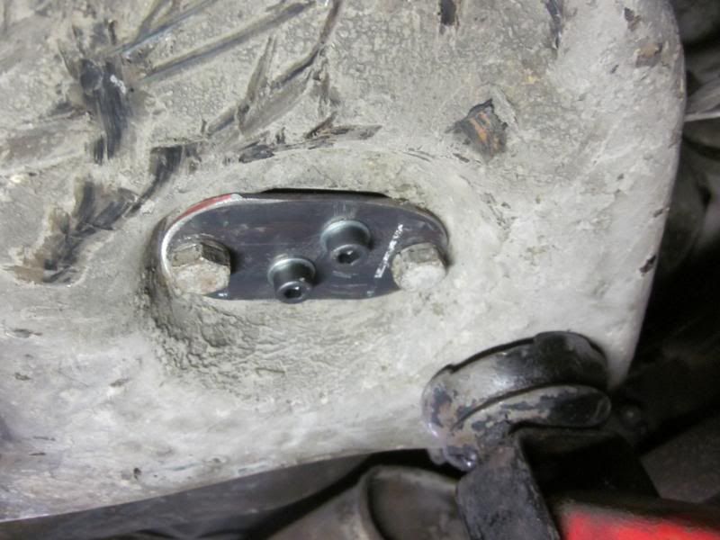

                        Moving on to the rear mounts, I'm trying to keep everything removable so I didn't want to weld the bottom plate to the arm. I made a square to fit in the hole for the shock, this will be bolted from underneath the arm by using the bolts that held the shock in place. I still need to mark and drill the 2 holes on the square mount.
                        I made a cardboard template to copy the right side and the postion of the square.
                        I welded the first square in full as I was happy with the postion. Not the nicest welds on the internet, but they'll do. I'm using a flux core MIG welder that splatters like crazy. I miss my old CO2 Mig

                            Cheers, love your volvo....I copied the front set up from Niscort on this forum but I figured out how to make the rears removable myself I still need to add shocks to the back, as the airbag takes the shock through coil location.
