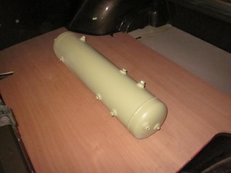

          Finally I have some worthy updates. The car needed some mechanical TLC before I could start working on the air ride. I've been cruising this summer and fixing little problems as I go along. Last week I started working on the trunk install so I'll be able to route all the airlines and wiring to the Accuair controller. I want to enjoy the car till the end of summer before pulling the suspension apart.
          I'm not sure of the final colour scheme for the trunk yet, but I prefared a painted air tank to bare aluminium. I chose a colour that matches the steering wheel.
          Green paint is etching primer for the paint to bond to aluminium
          Final colour, not happy with the finish because I ran out of paint after 1 coat.

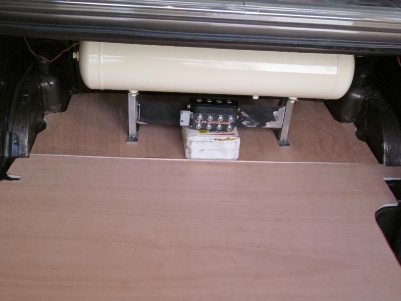

              I started making the mount for the accuair manifold and air tank from some scrap steel. I used a bender at work to form the centre part
              [/URL]
              The legs are just tacked together to check the height and so on
              I want to shorten the legs and raise the centre plate after seeing this....I took it apart after I took these pics to make some adjustments
              The manifold needs to be closer to the tank too..

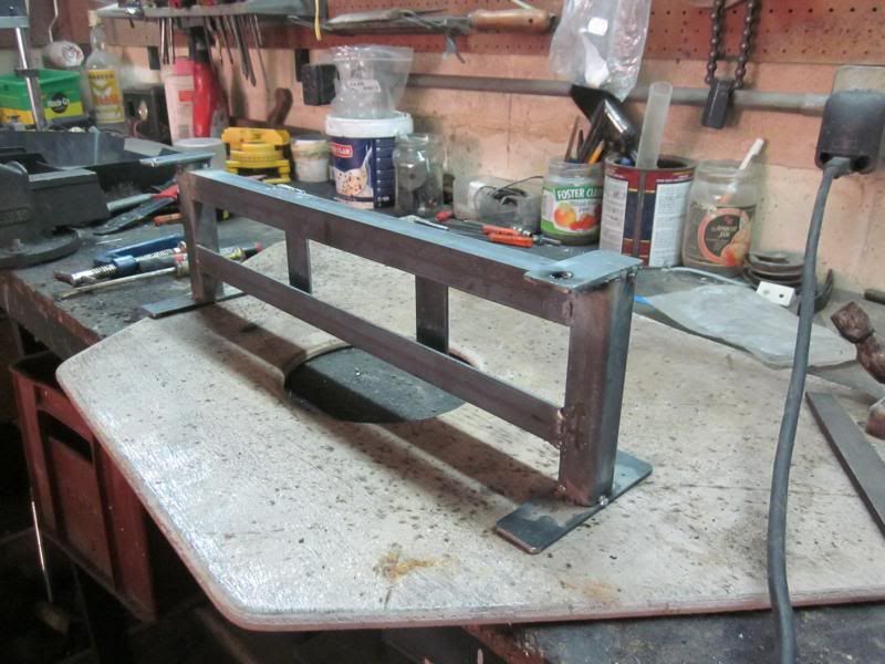

                    I had some time to work on the trunk install. I decided to scrap the first rack I made as it warped out of square after a lot of cutting, rewelding and modifying. I also thought of a better way to mount the e-level ecu (on the flat bars behind welded at the back) this will make the install look more elegant with the wires going through space rather than around the rack etc
                    Here's Ver 2.0, still needs a few holes and painting (satin black)
