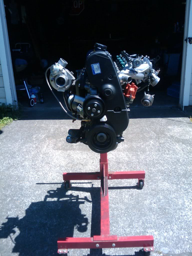

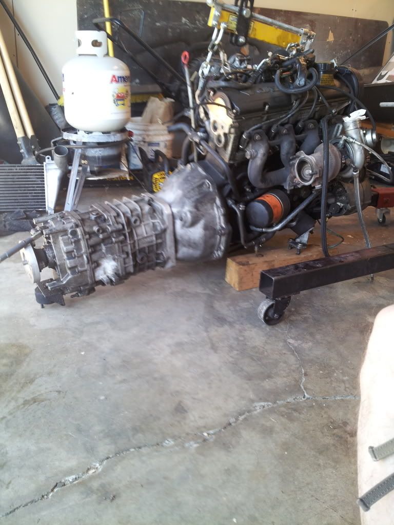

    And a picture of the motor I built for it, before it went in a couple of years ago

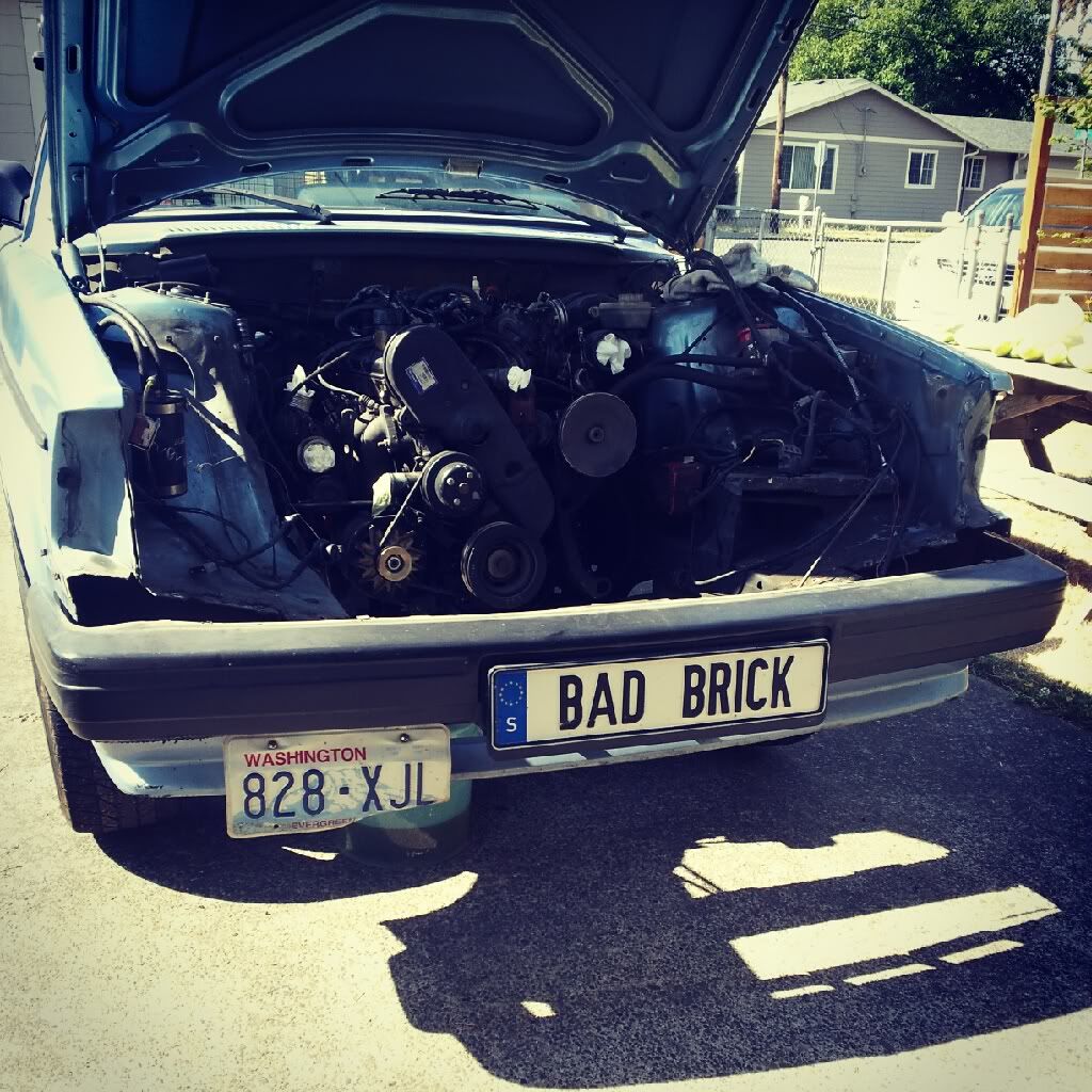

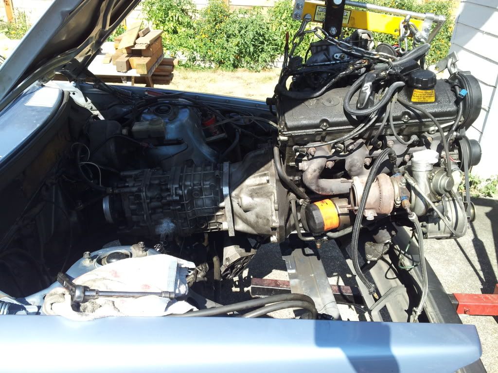

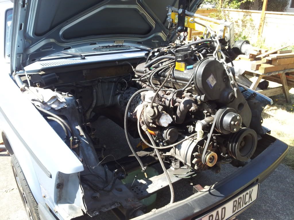

    This weekend I'm pulling the motor to swap out to do:

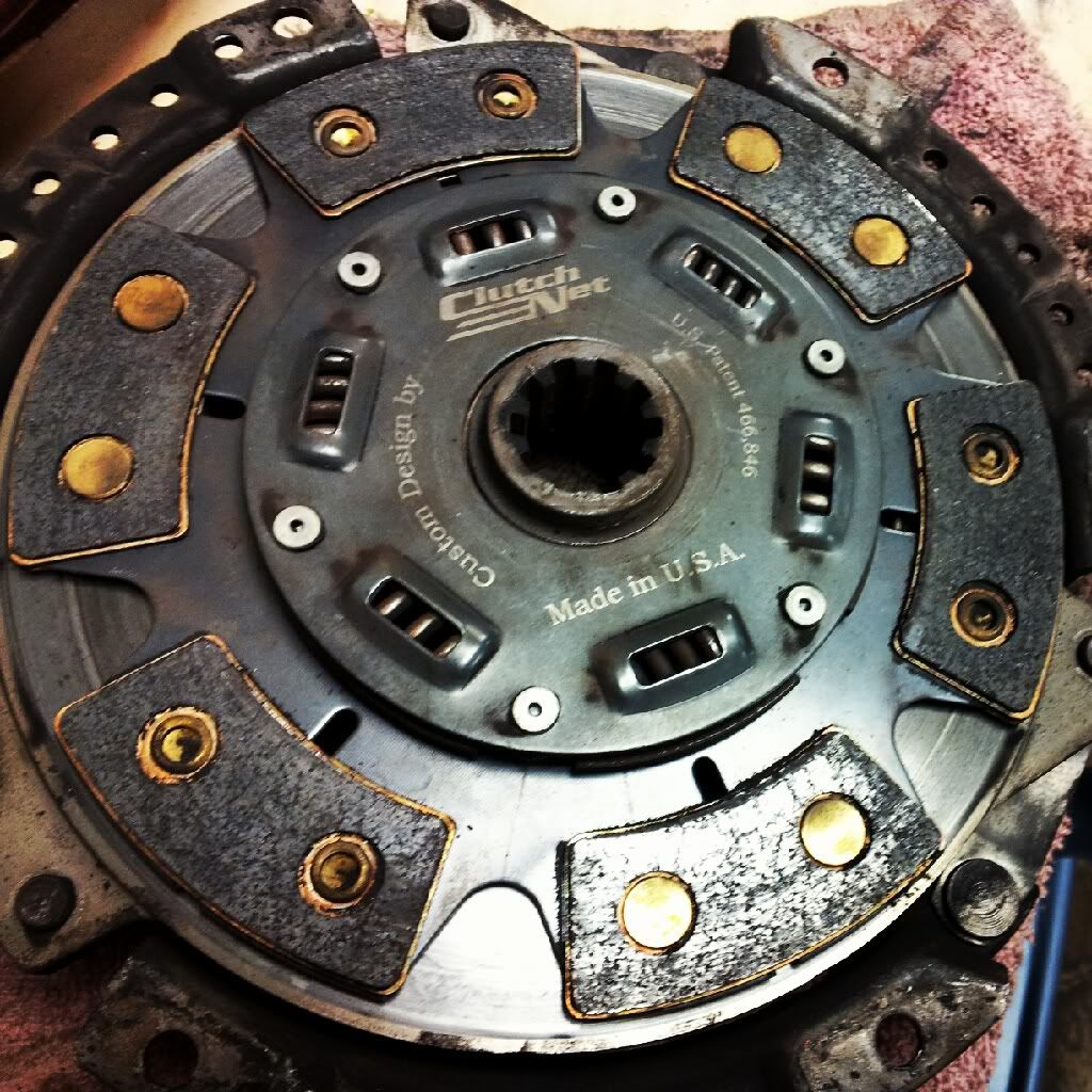

    new clutch disc, fullface/carbon kevlar deal
    redo the mount for the Getrag tranny
    tuck all the wires in the bay
    repaint the bay
    install a different and upgraded ignition system

          got the motor out this morning and the getrag265 wasnt damaged by the clutch fork when it came apart. fuckyes

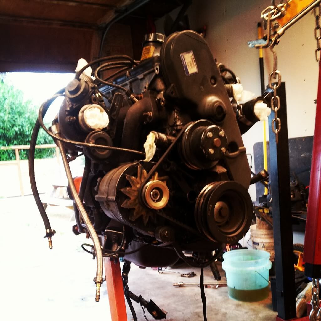

                purple power cleaner and red scotch brite pads, best cleaning combination ever.
                  cleaning, redoing a few seals/gaskets and cleaning up the wiring
                  Worn out, time for carbon/kevlar disc

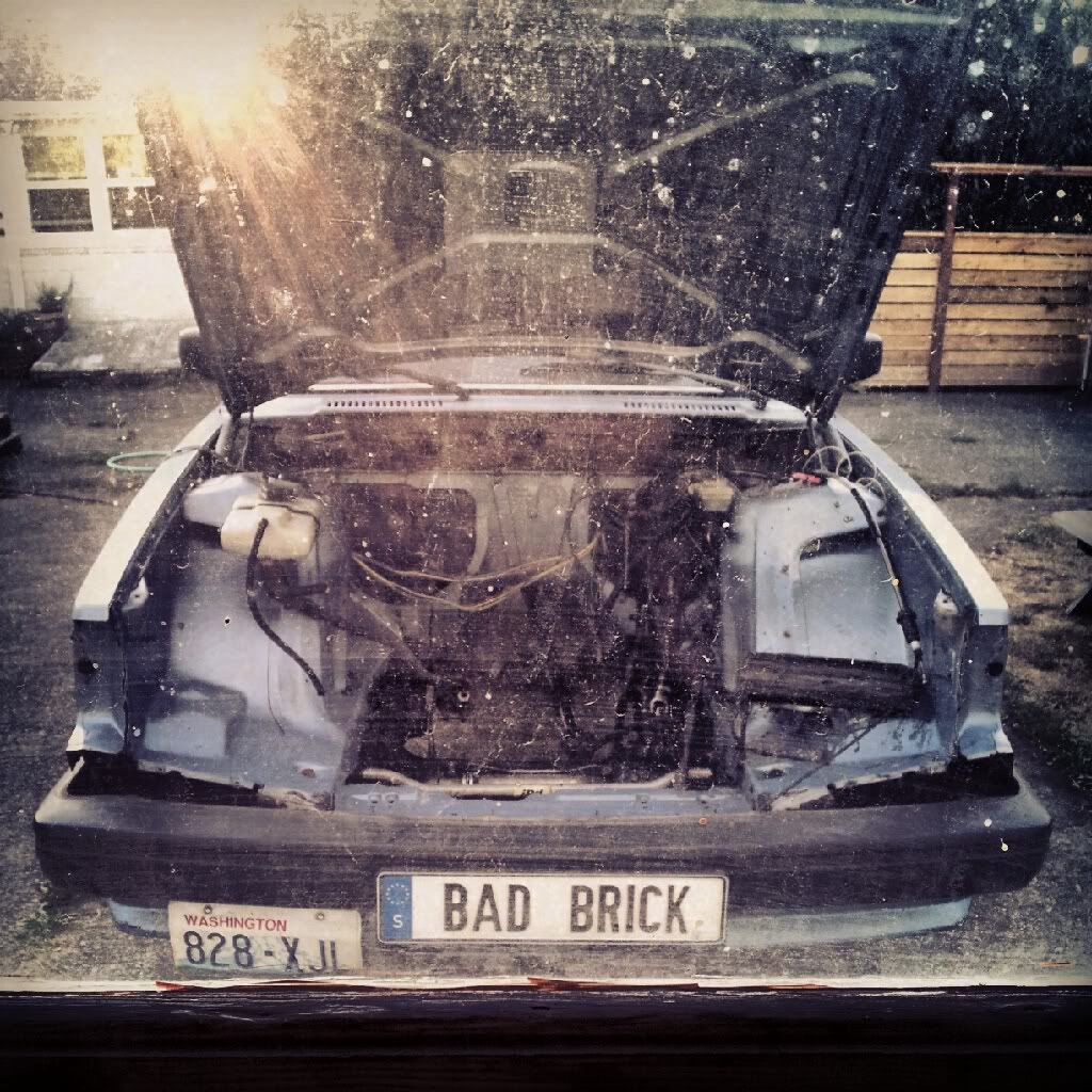

                  In the process of tucking all the wiring so i figured i would take a shot through my garage window.
                    I <3 bricks

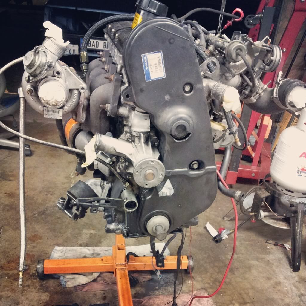

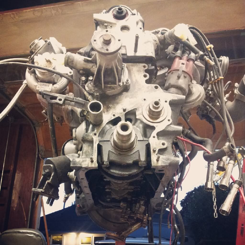

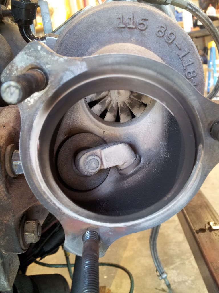

                      got the engine pulled apart as much as i needed, pulled the oil pan so i could change the o-ring in the oil pump and replace the gasket
                      new gasket on the front timing cover, adjustable cam gear attached to a big cam also there
                      and almost ready to put back into the car, just need an oil pan gasket and my flywheel back from the machine shop
