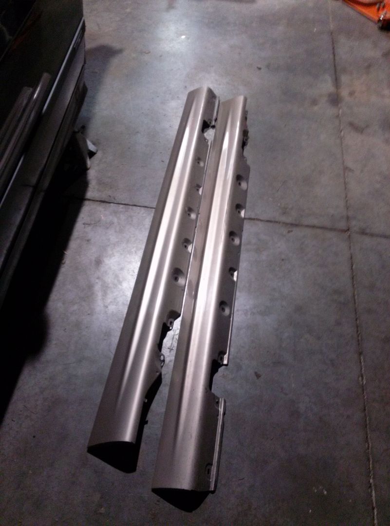

The only plus about Saturday is that I picked these up cheap from a friend and will be trying to make them fit for when I want to run skirts instead of being skirtless.
