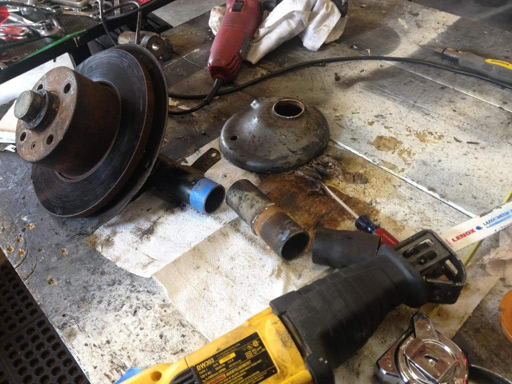

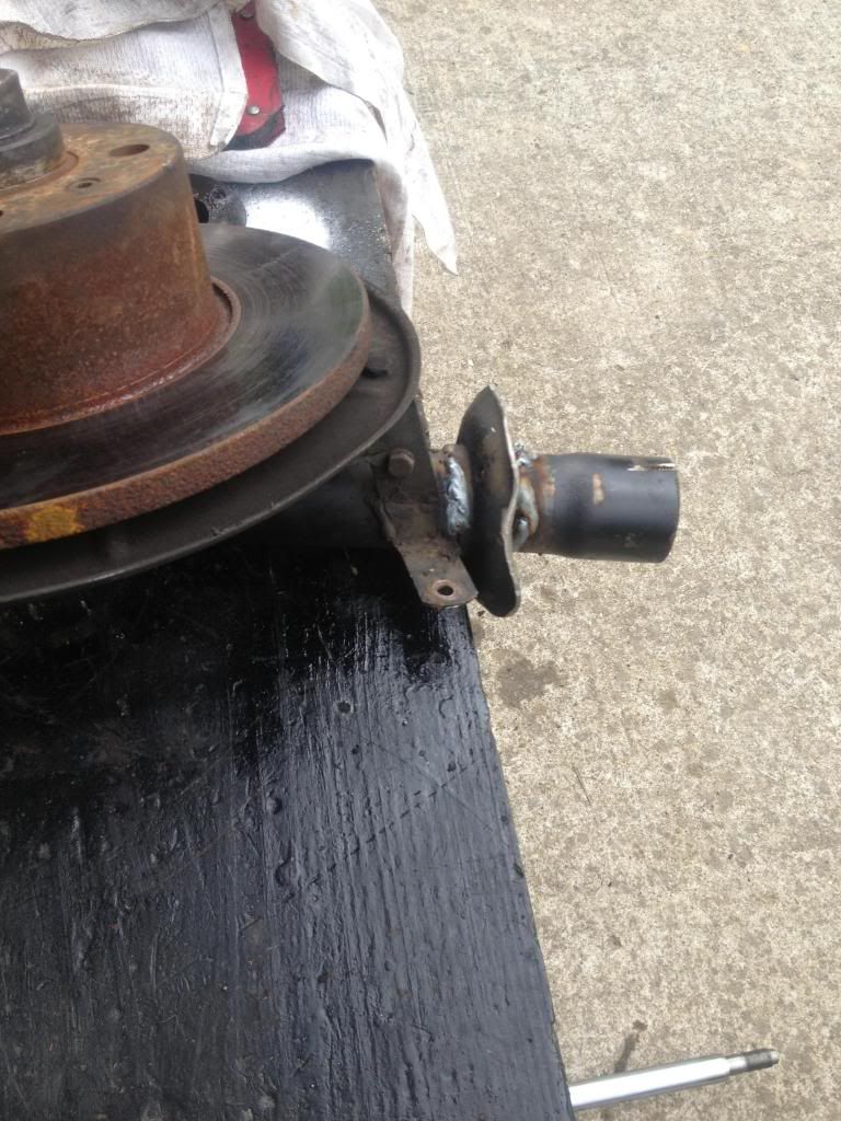

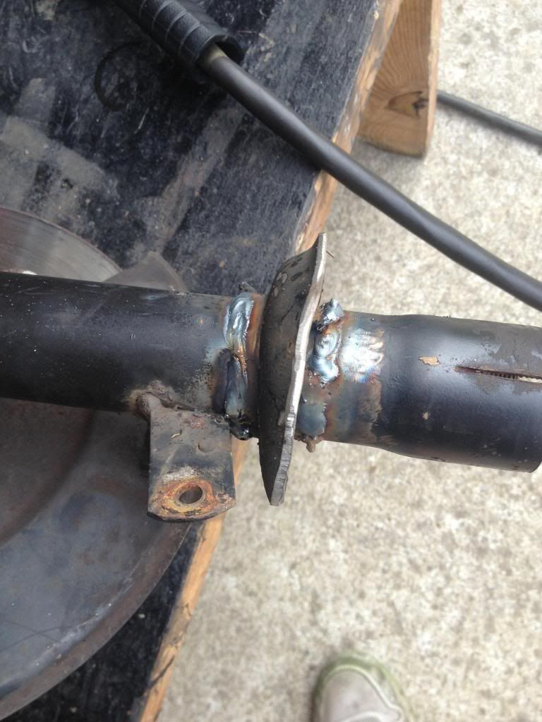

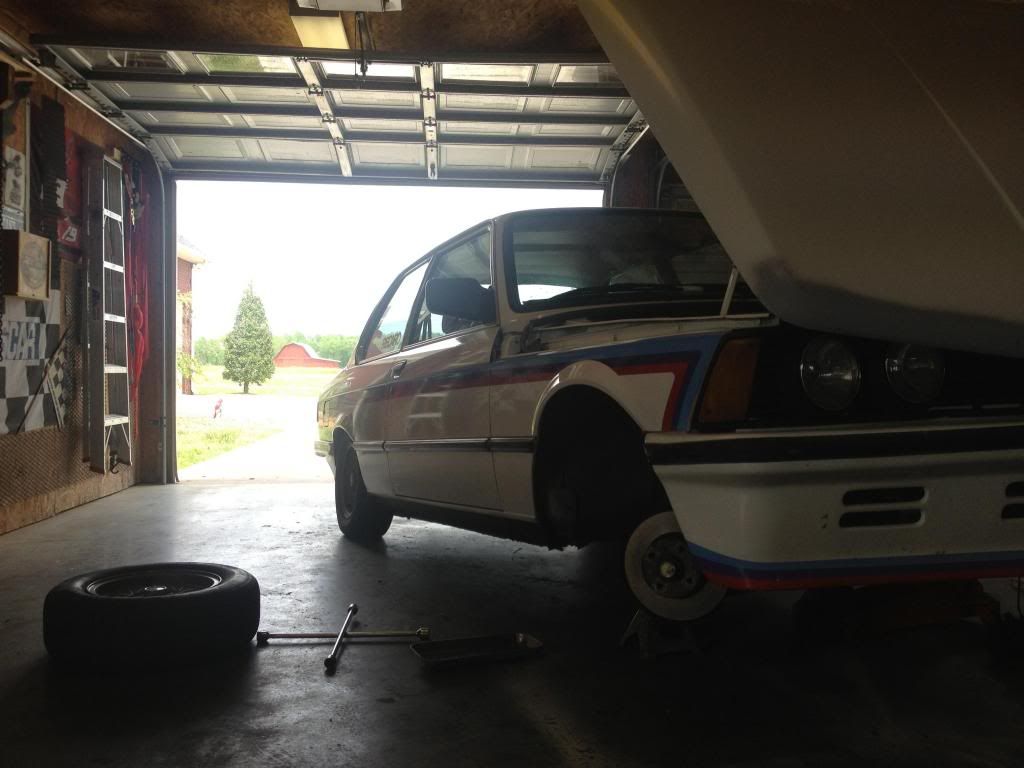

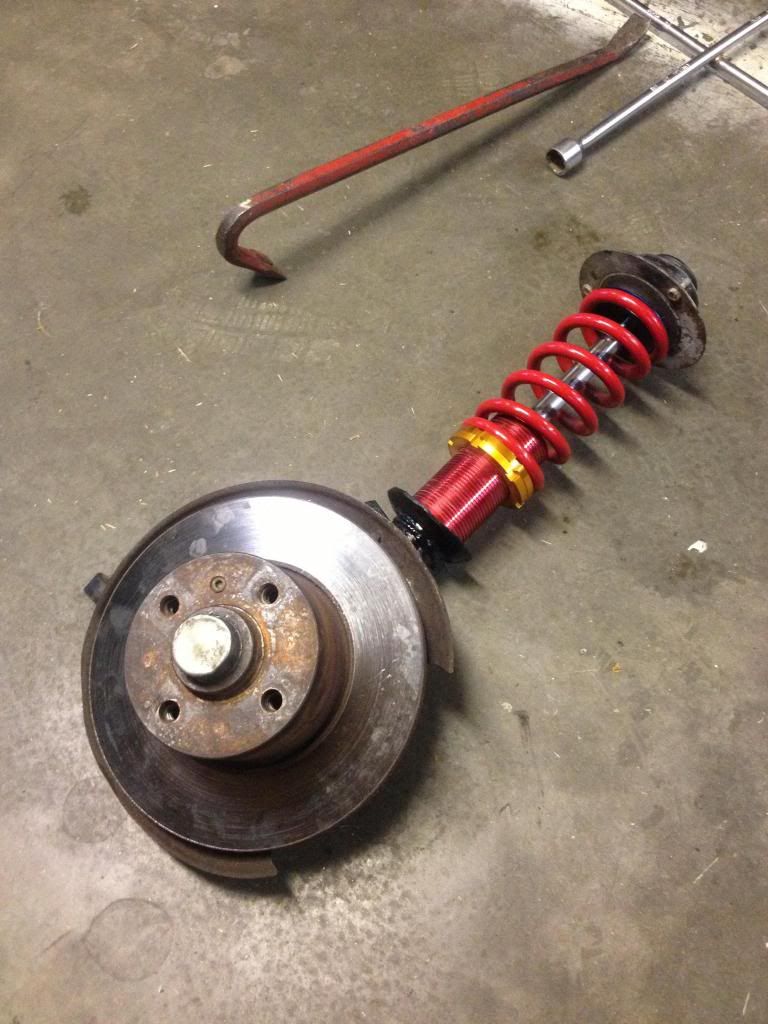

            • well I finally got around to taking care of that LOWER IT MOAR WHEELGAPZ OMG 4X4 STATUS business going on. The idea was to use mk1 vw strut inserts because I read somewhere once that 2002 guys do it, and the strut cartridge outer diameter matched mine. Turned out they were a LOT shorter. To the point that we were afraid it would be too low and the car wouldn't roll anymore. the cartridges had a body length difference of 5.5", which meant I would have to shorten my housing by that length. the fully compressed length of my original cartridges just about matched the fully EXTENDED length of the new ones, and you can't drive around with so much preload that the shock is fully extended all the time without breaking something. But I decided to just go for it. YOLO
              The end result certainly looks handsome. It was high enough to drive without too much preload, and drives and handles better than it ever has. I love it when a plan comes together.

                    • Ahhhh the shit just got real, the newer shock is so fucking short! How's the ride comfort?
                      • UM Ass!!! we need pix of side ride height hahaha

                              • You could've just added a "spacer" at the bottom of the strut housing for the cartridge to sit on so it sits higher. That way you wouldn't have had to shorten your housings by so much. A lot of e30 guys do that and I did it on mine with no problems.
                                I made a video of my e30 coilover build and strut housing shortening, if you watch from 4:20-4:38 you'll see what I mean. [ame="http://www.youtube.com/watch?v=8Q7xUSNRyLI"]BMW E30 Strut Housing Shortening Tutorial + Ground Control Coilover Build - YouTube[/ame]
                                But it seems everything worked out so that's good. In case for some reason you ever decide you don't have enough travel and snag a stock set of front strut housings and give it another go, the spacer might do the trick.
