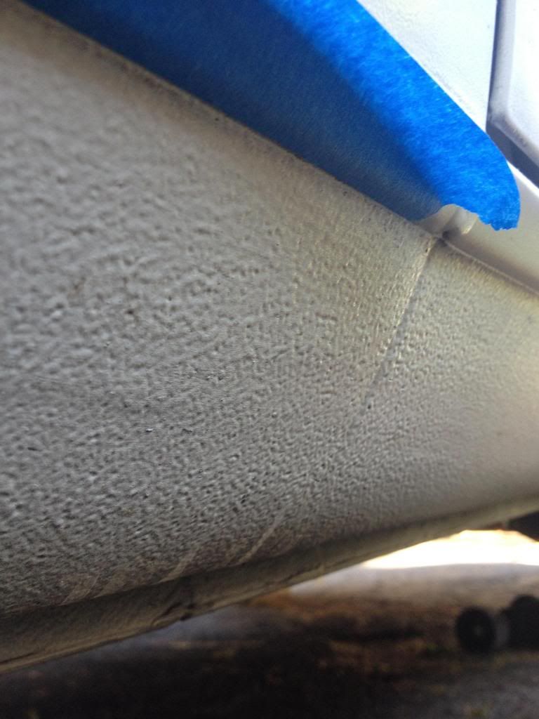

                              E21's have undercoating on the rockers from the factory, and since I painted it I kinda thought the white rockers made it look like a cheap maaco job, so I put herculiner on them. Should help with rust, and the texture is fairly accurate.

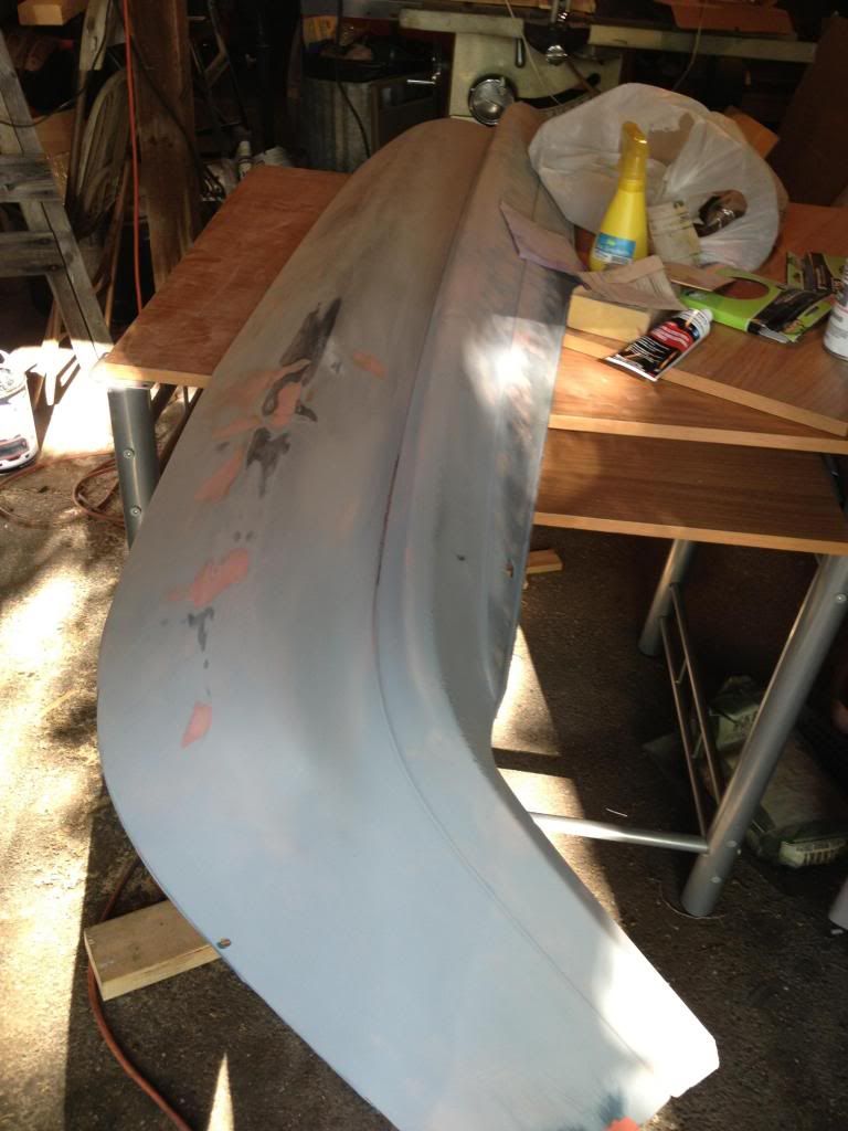

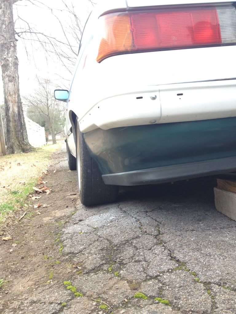

                              And that brings me to this rear skirt thing I've been working on. I picked up a rear bumper from a Honda or Acura something or other in the junk yard that matched the basic profile I was looking for. I wanted something that kind of had a soft curve that would sweep under the lines of the car with a lower "lip" to keep it looking a bit sporty. I found one and cut the top off then sectioned the lower part to narrow it and remove the exhaust cut out, as it was on the wrong side of the car anyways. I cut on either side of the exhaust cut out and grafted it back together. Here are some pics of the fab and some loose test fitting. Should hopefully be painting it this week sometime.
