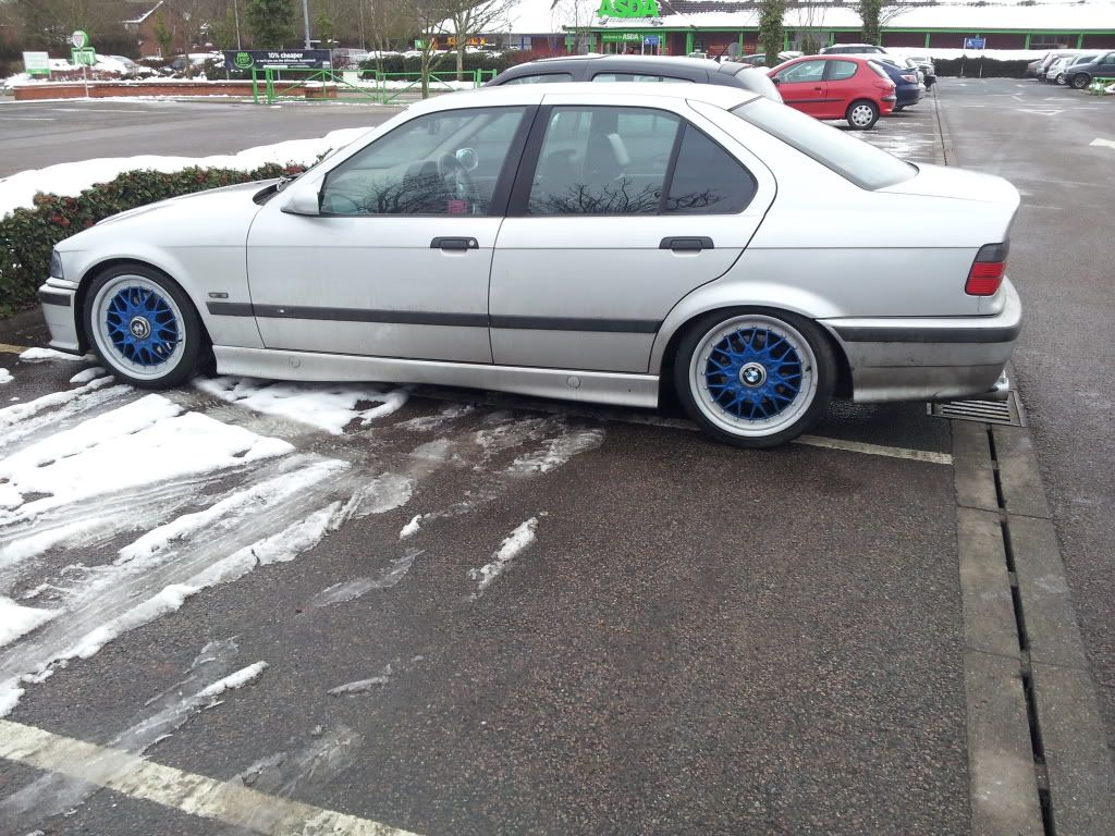

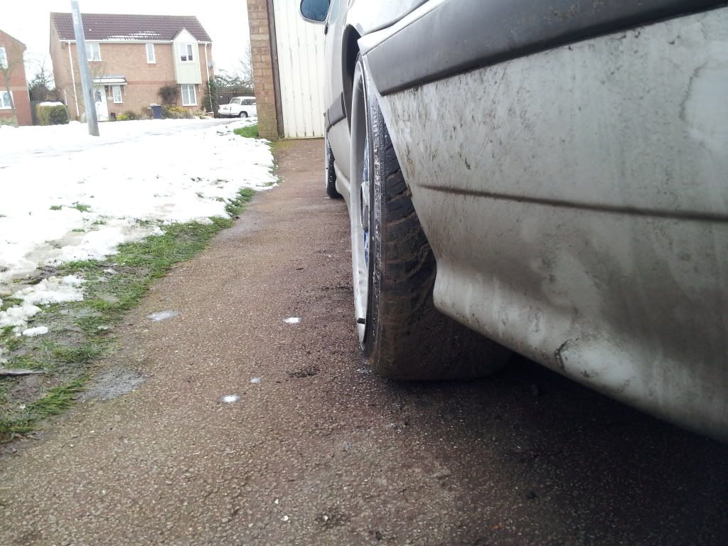

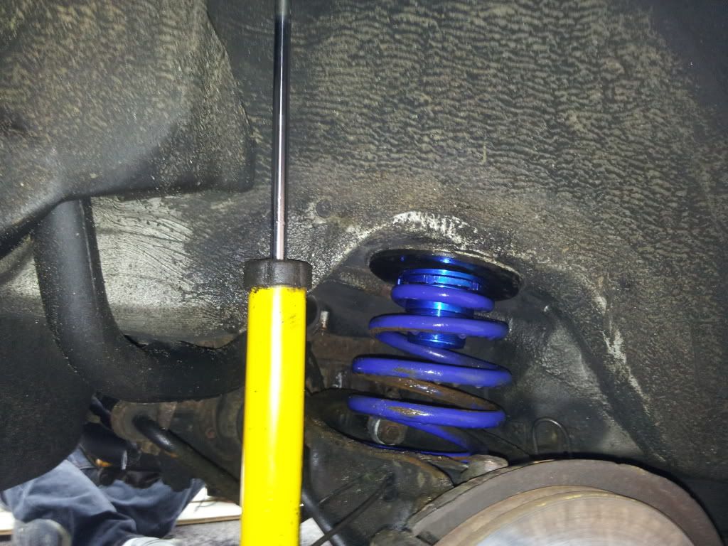

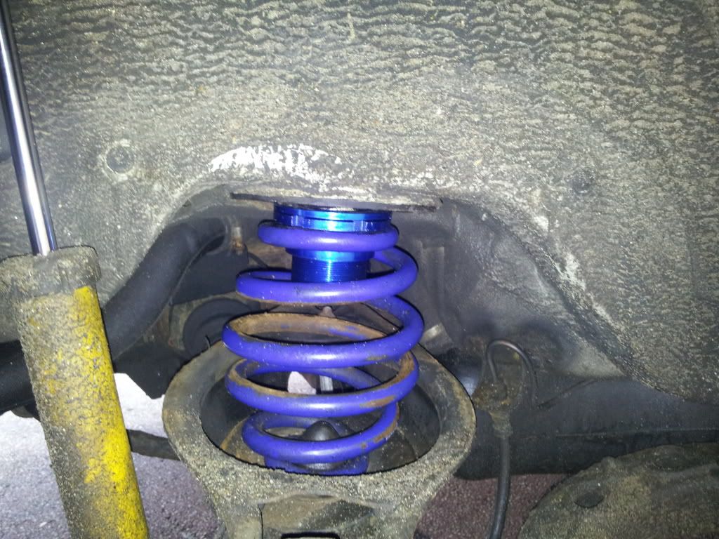

Right before anyone comments shes raised ready for a mot next month as i cant get on any mot station ramps at my usual ride height so please excuse the 40mm raise for now it will go back down after it passes hopefully

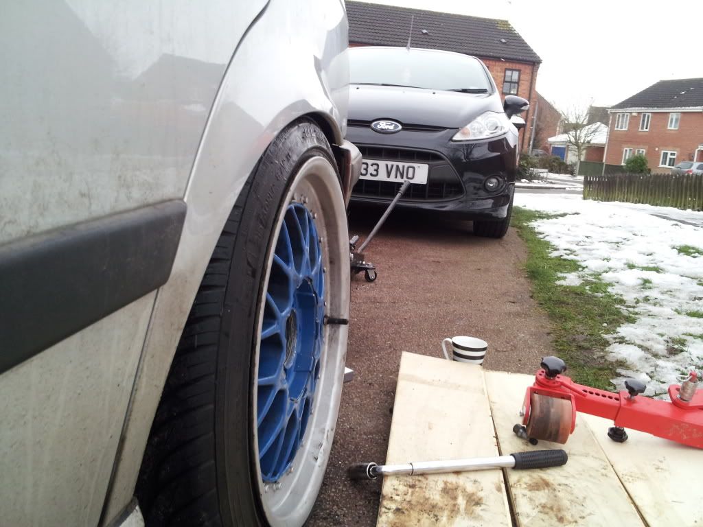

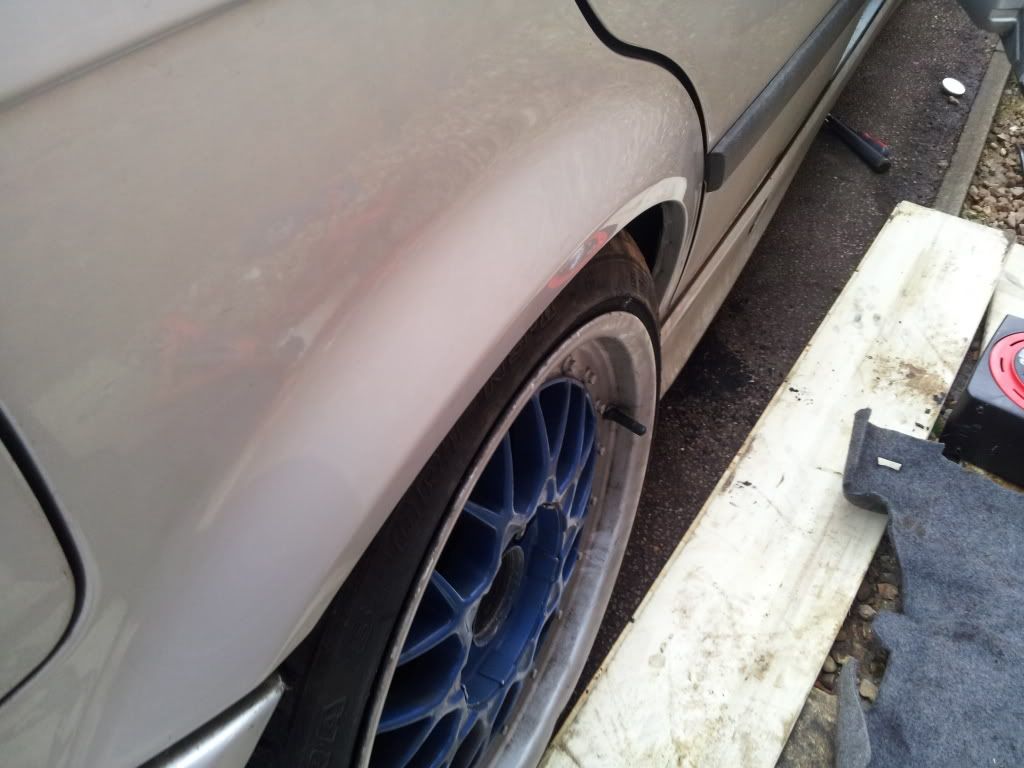

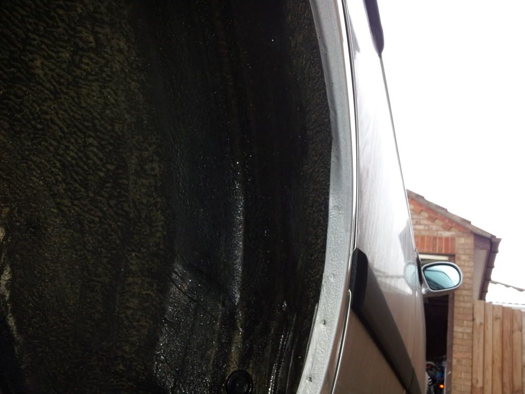

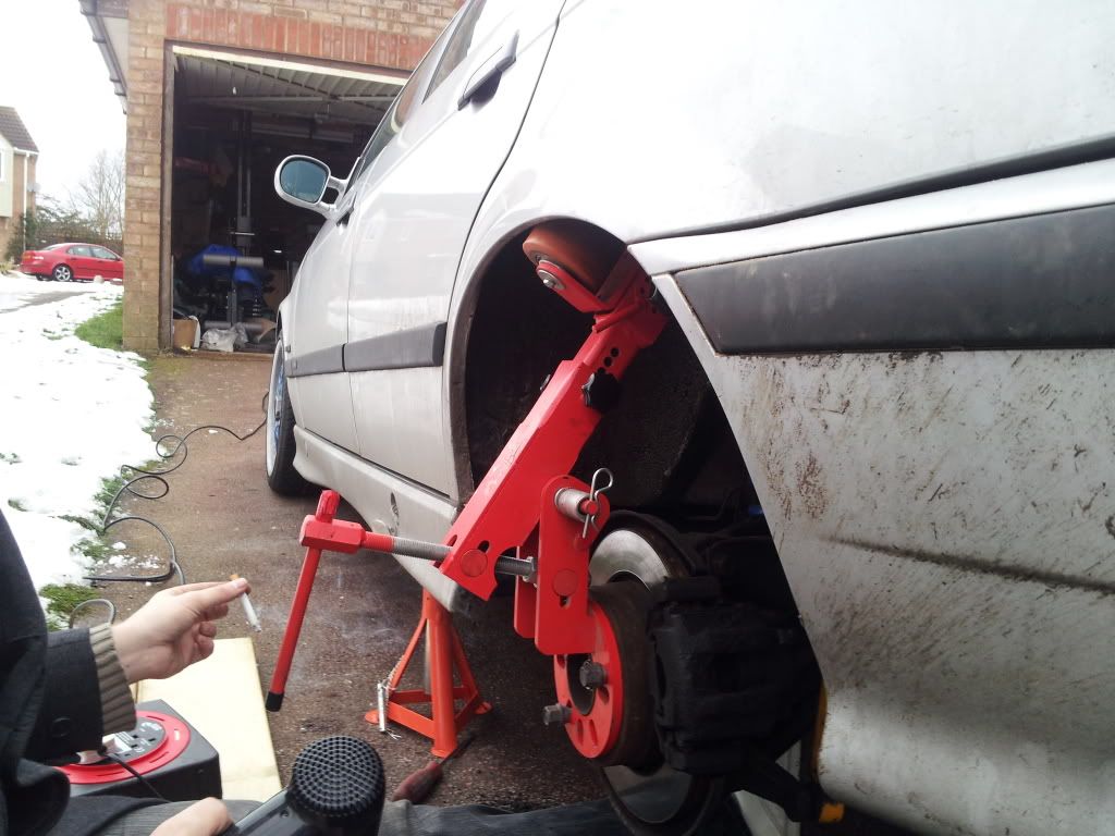

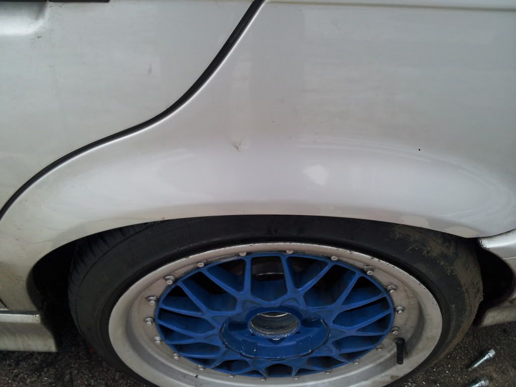

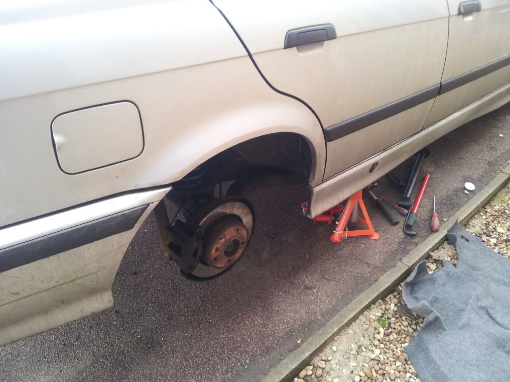

Been planned ever since the beginning of the project and im lucky in that mine are rock solid on the rears and 99% perfect up front so today with help from kev318bmw we attacked the rears with a borrowed arch roller and my wifes hairdyer
and went very very well and no cracked paint or any dramas at all but bloody cold and hard work doing it but heres the pics throughout the day.
9am start

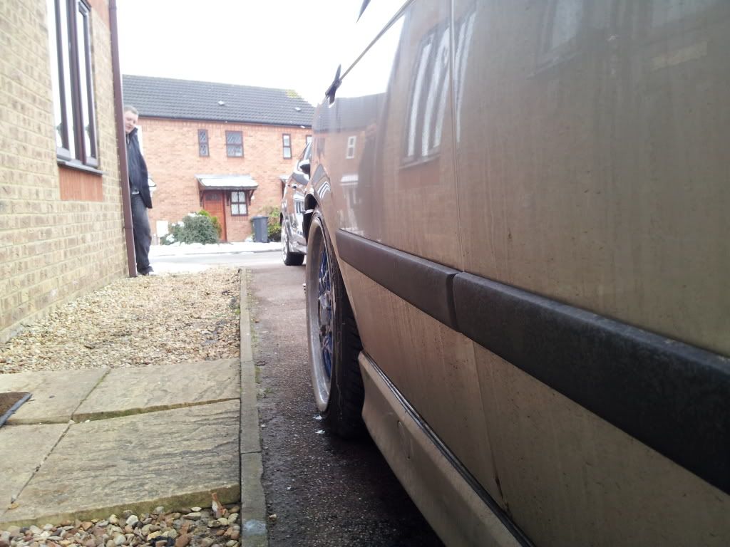

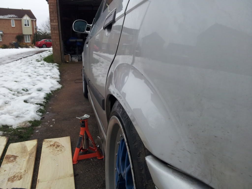

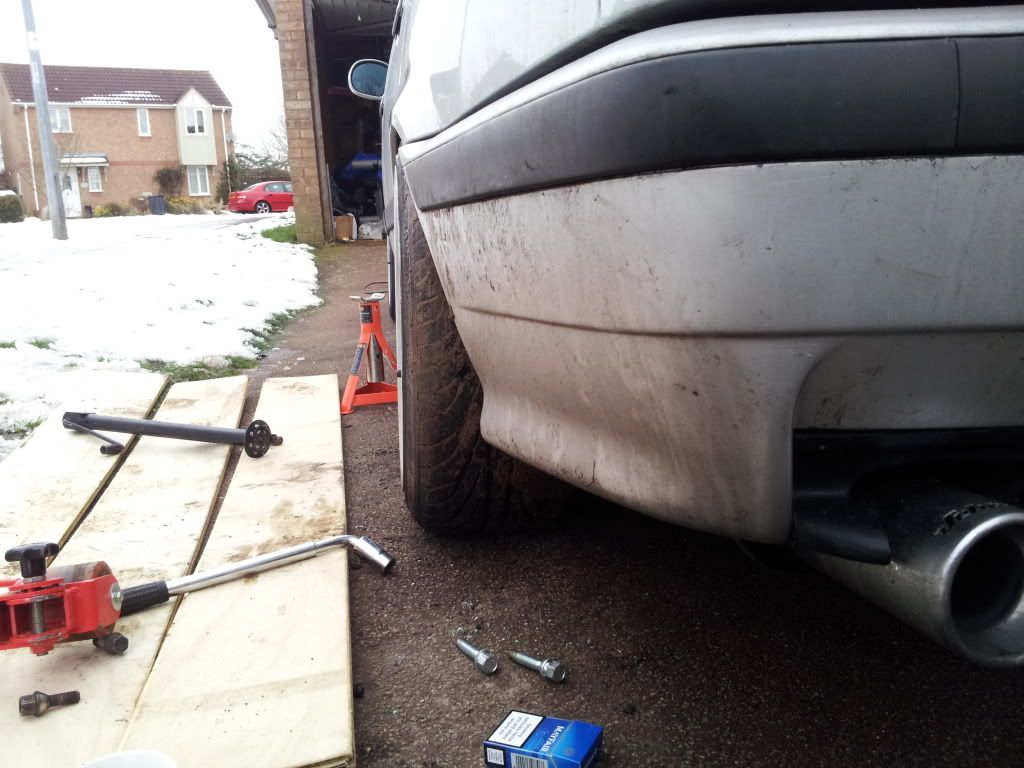

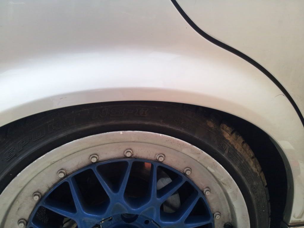

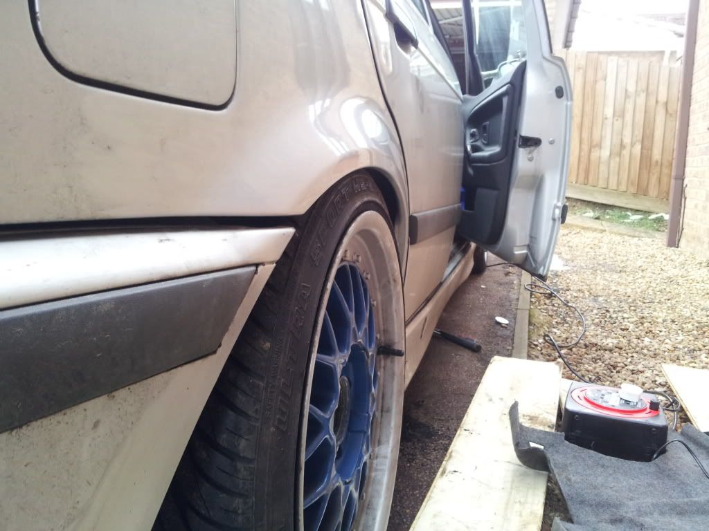

i already attacked the sealant inside the inner arch liner before kev arrived so it was straight to work.my plan was roll to my 8.5 rears with a 215/40/17 Tyre on a 20mm spacer to give enough clearance for any future updates and if ive worked it right(stu,matt,damien,suj please help me on this)possible rear fitments of et10 on a 205/40/17 or et16s ish on a 215/40/17 in future.the arches were deseiled and rolled as flat as we dared with a minimal flare without risking cracked paint or stupid flares to try to keep an oem look as much as we could:thumbsup:thumbsup:thumbsup:thumbsup
think i can run 215s on a 9j rear without catching now or adjust camber to make sure(disco stu mate i need you to sort this out maybe buddy

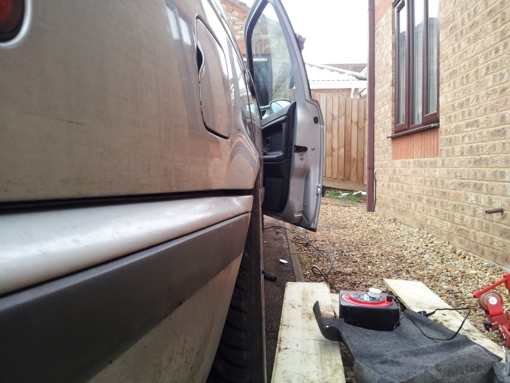

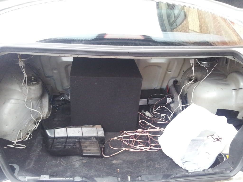

)but the wheels im looking at are et26 or 35s i cant decide yet but now i have more options as i have raised the rears 10mm now to give me this plus a pic for abm to show ive started stripping the boot and temp wiring for now.
right enough crap let the pics do the talking

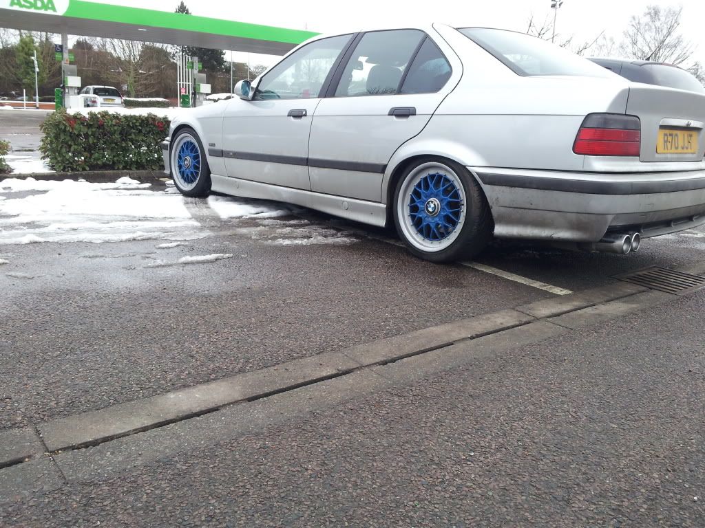

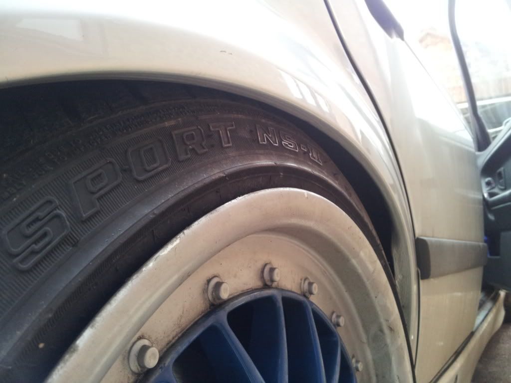

then finished with a 20mm spacers fitted and no rubbing .......just(15mm would be imo safer )

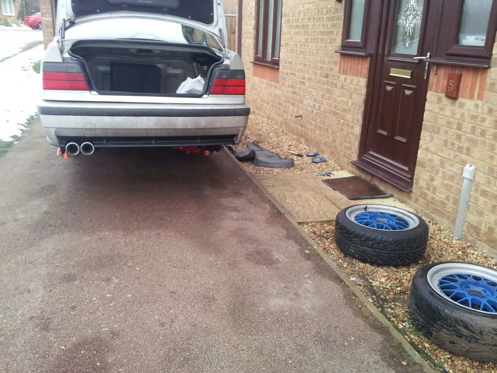

then back to 6mm rear spacers on 215/40/17 on a 8.5 rc042
