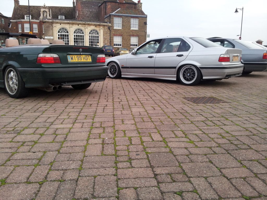

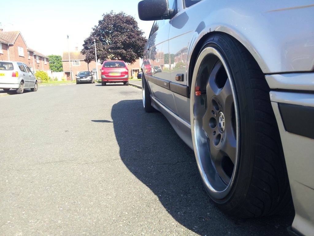

            met up with some lads last night so took a few pics at the quay and will be the last pics for a while as im touching up some body rust imperfections out

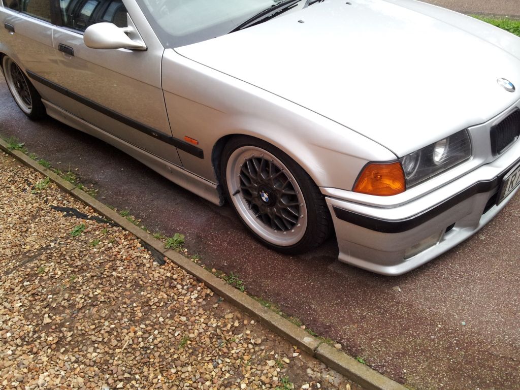

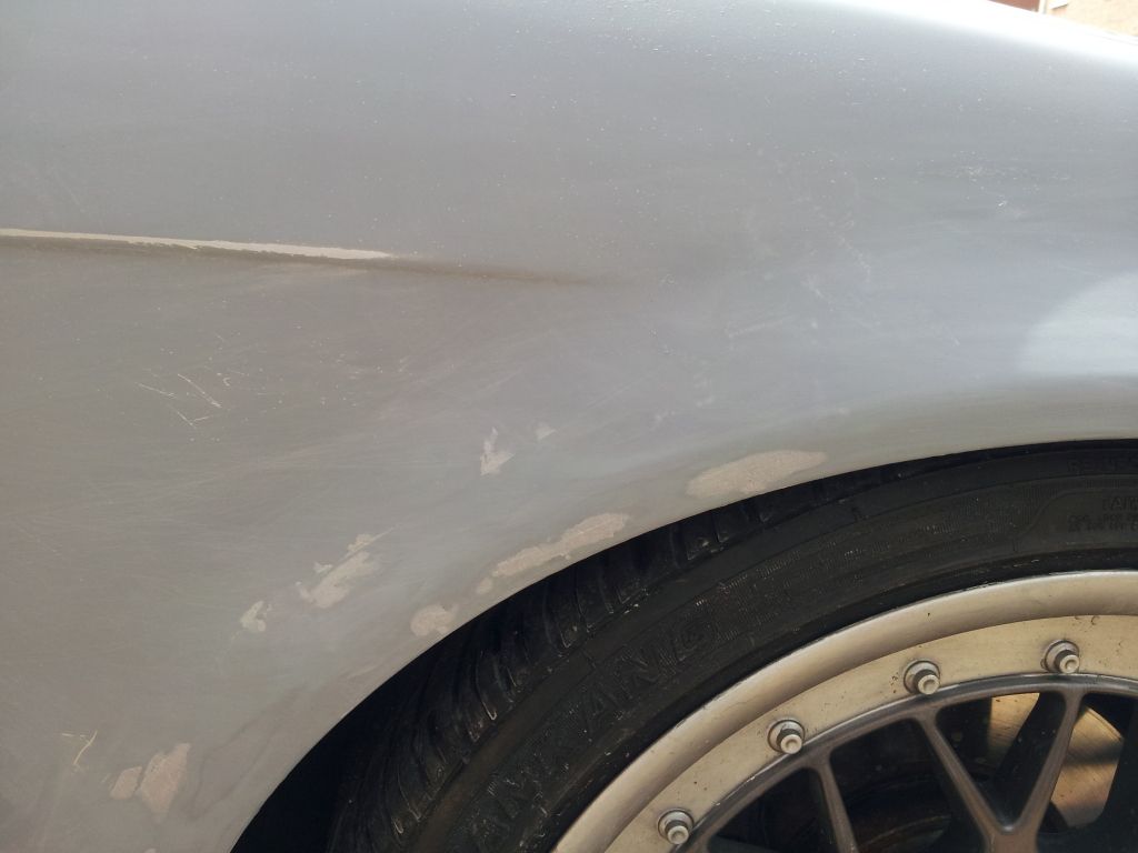

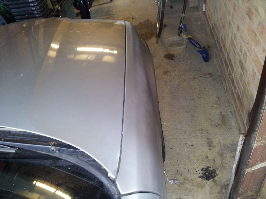

              decided to do the work on the drivers side arch as i had some rust bubbles that bothered me so got cracking on it and ready for paint very soon
              also fitted a strut brace and rear adjusters removed and fronts soon to have the helper springs removed for more lows
              when its time for respray new rims will be fitted hopefully once i make my decision 100% and some other bits planned

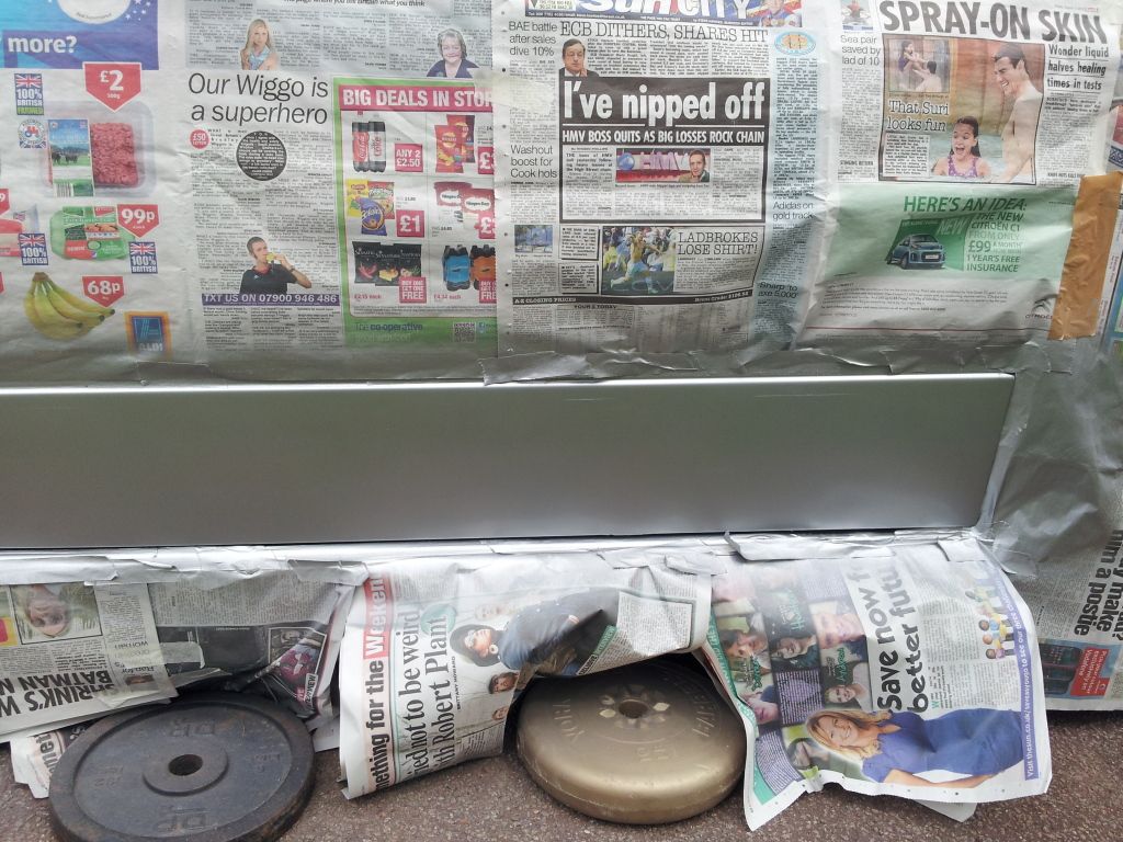

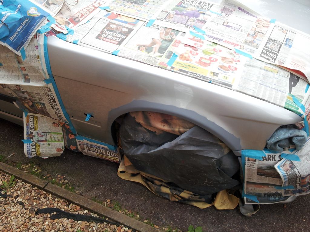

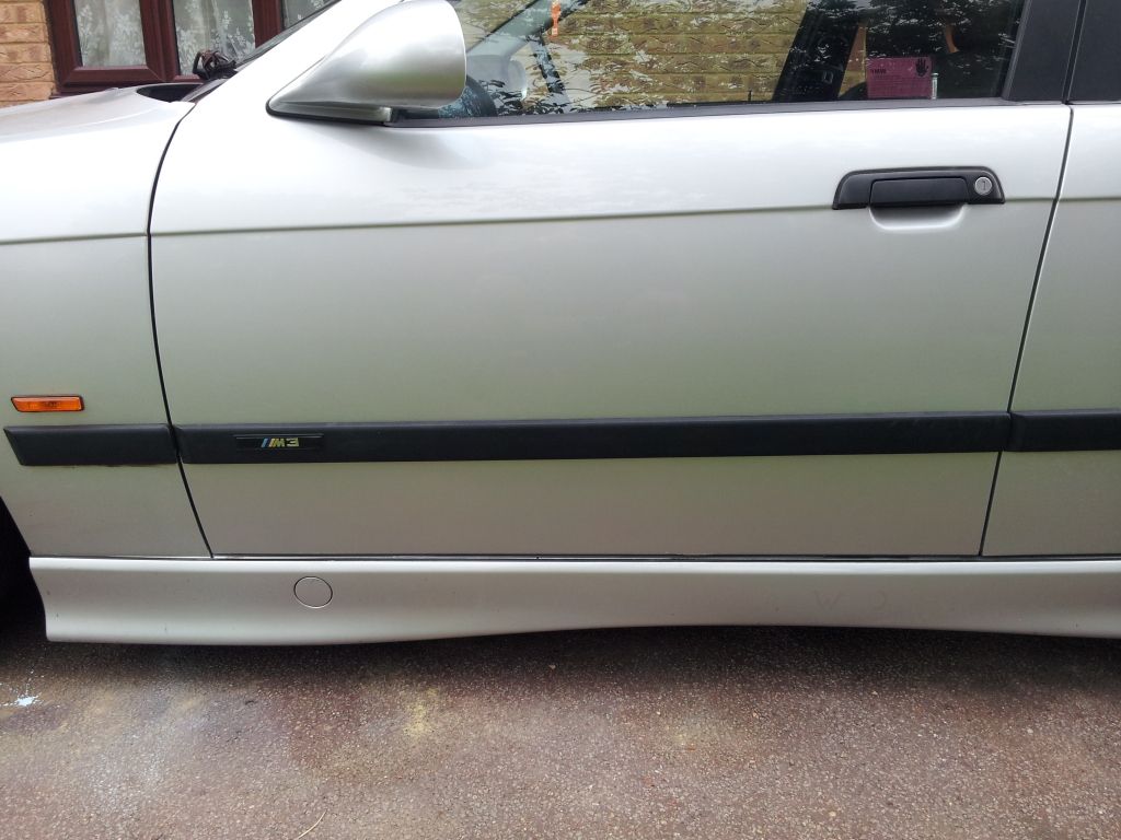

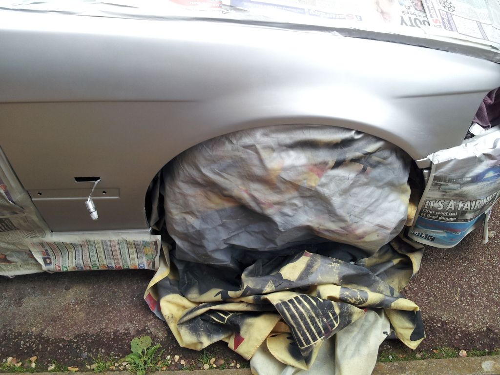

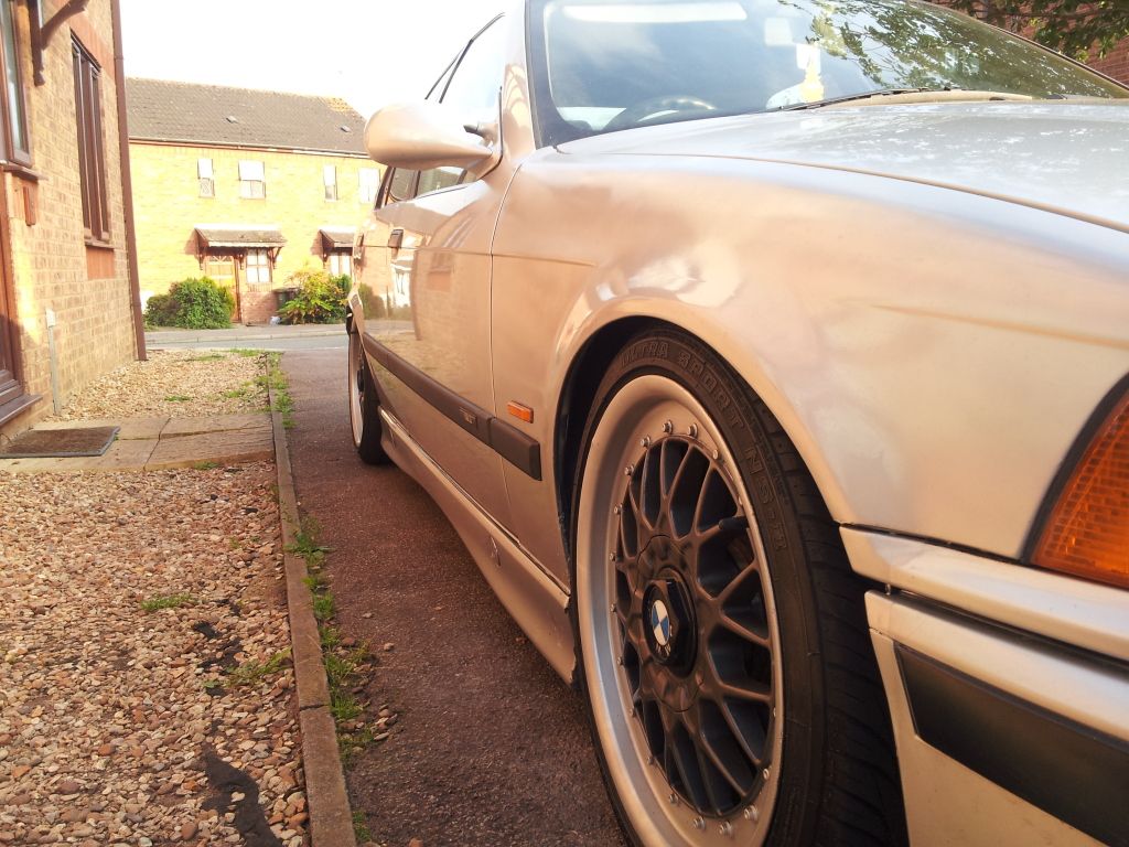

                saving the pennies for new wheels and a respray so i rattle canned the wing and came out ok

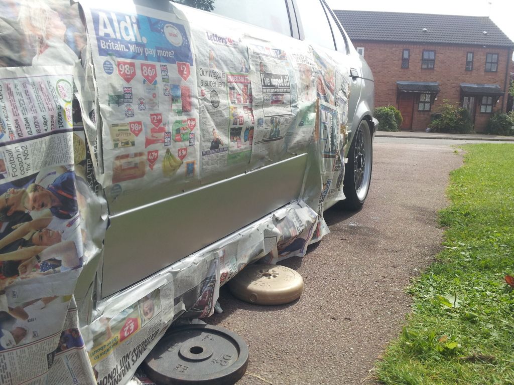

                Well did the family thing at sunny hunny and won 40 quid at the amusements before the heavens opened royally and the headed home and low and behold it started being nice for a while so see a few hour gap and thought stuff it lets hit the final coats of paint and went to work.
                miles better than before but not 100% happy with it as the arch is pretty messed up anyway and you can only do so much with it(ill replace it at some point with a spanking new one) but it turned out ok and a pretty good match,needs 48 hours to settle and i shall rub it down super smooth ready for the lacquer(wed is meant to be nice weather)so thats the day i shall do it.
                for future reference to any who have a go-do not try to blend it in and do the whole arch first as i can still see the original join slightly when i first decided to do it and as good as sanding blocks are use a electric sander(i shall invest in one soon)
                halfords paint as good a match is the silver does get streaky(disco stu recommends paints for u stuff)
                quality sandpaper works miles better as i found out very quickly
                spend more time taping it all off to prevent overspray(now sorted but very annoying)
                dont buy a silver car and rattle can it
                one door to go what looks to be a right bitch to do and im really not looking forward to doing that one
                so far ive done front/rear m3 bumpers,bootlid,wheels,drivers front arch out of a can but its no substitute to proper job but for now it will do
                Anyway enough waffling and heres todays pics

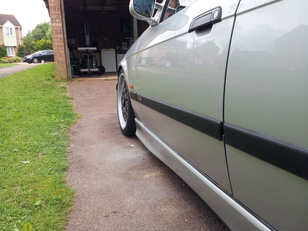

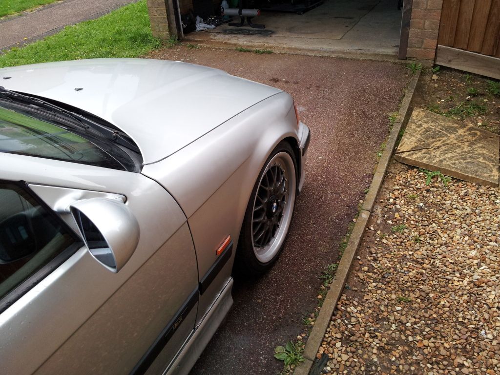

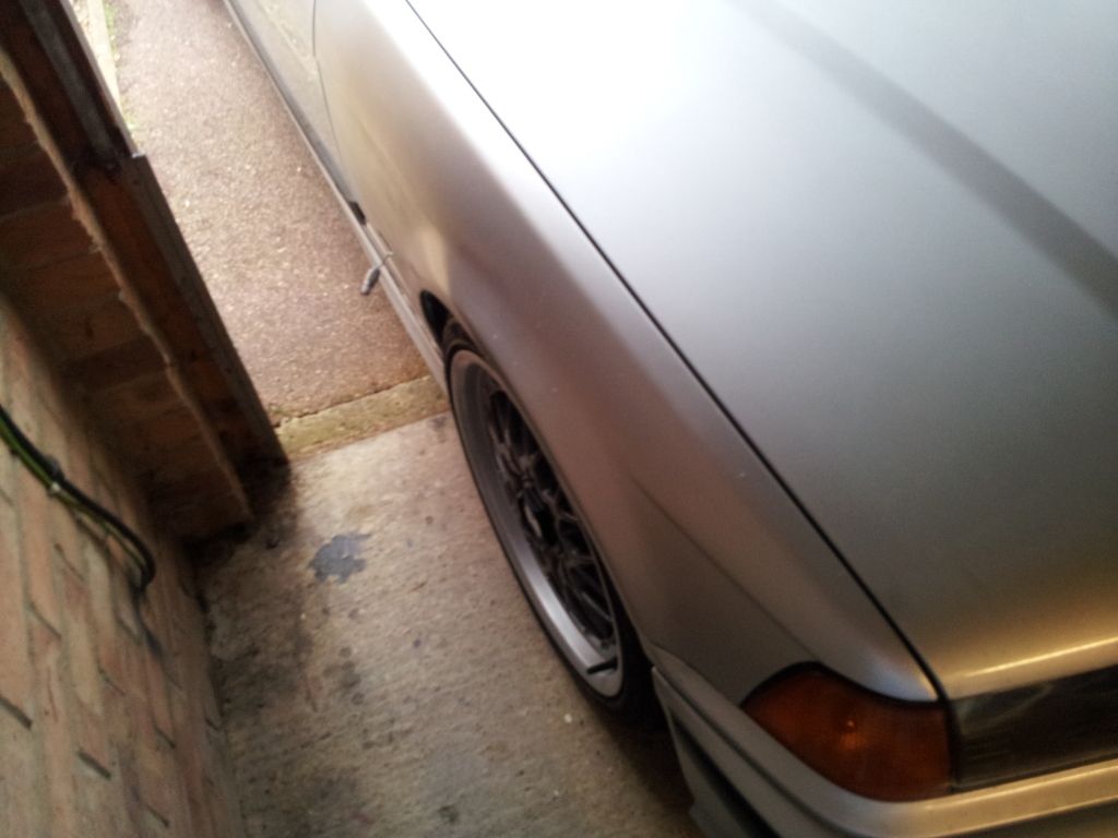

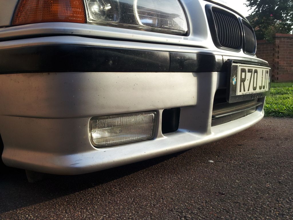

                      Finally fixed all the bodywork imperfections as of today bar a respray thats planned for early next year and then get the arches rolled front/back then hopefully some new rims
                      planning on 8.5 fronts and 9 or 10 inch deep dish rears
                      Anyway a few pics on my drive as im waiting on some bits too arrive for the exhaust

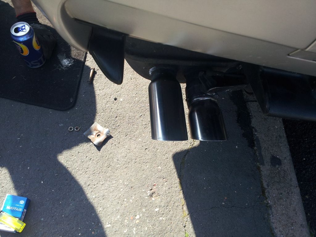

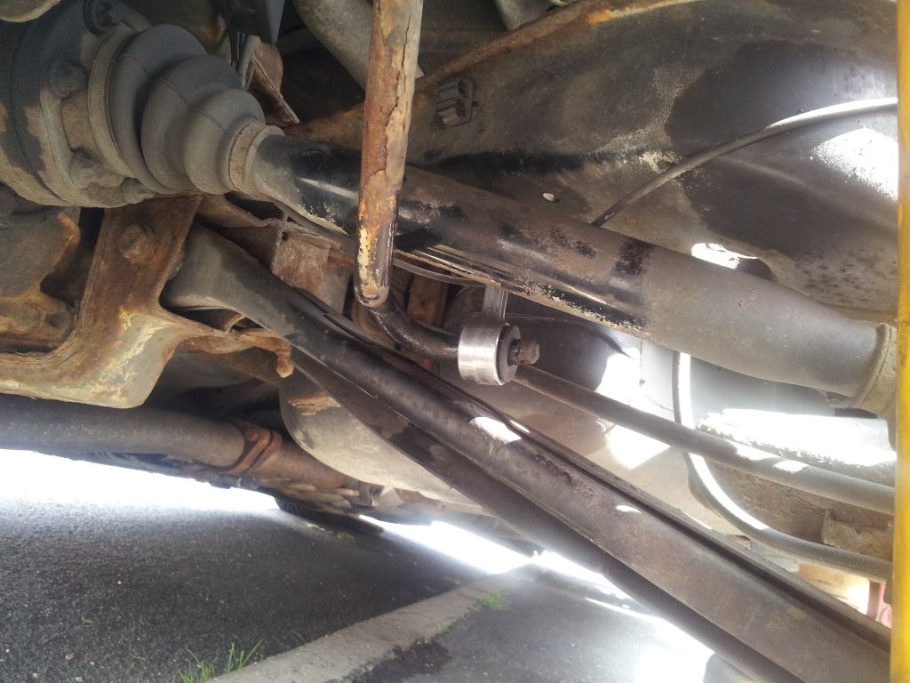

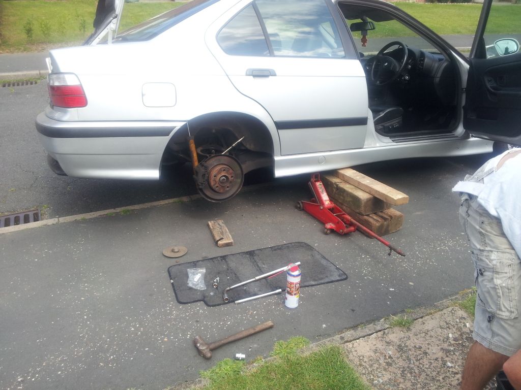

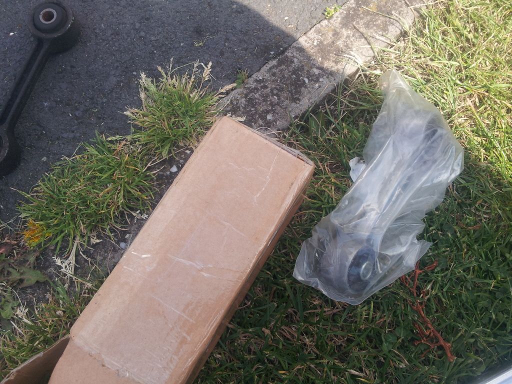

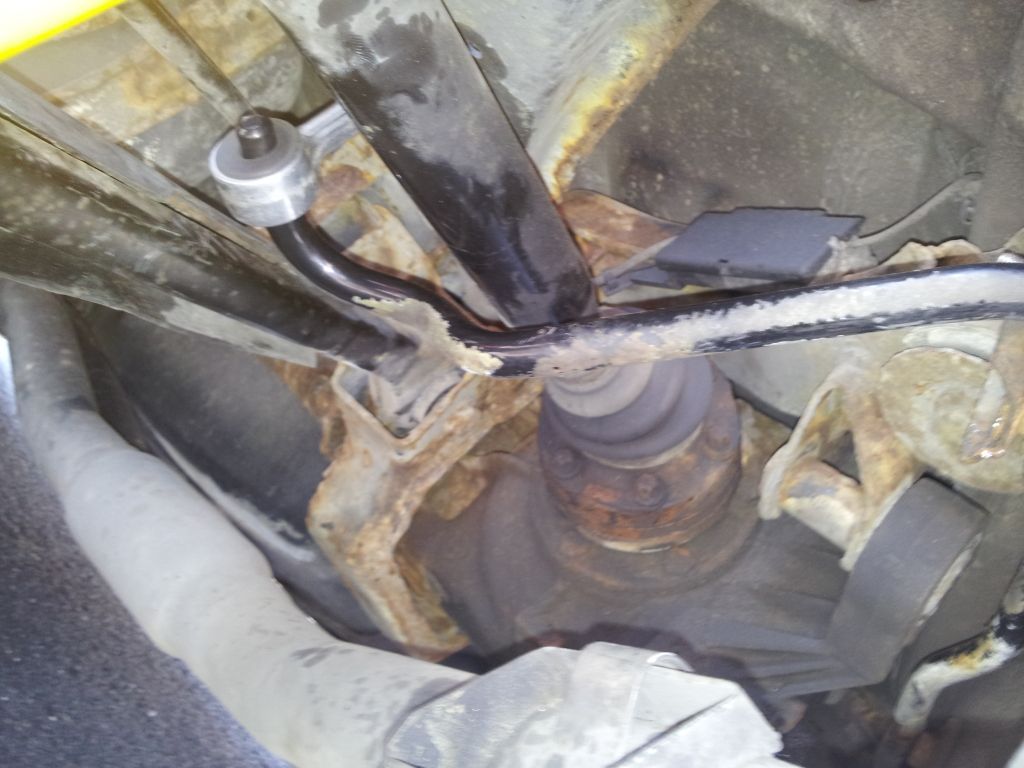

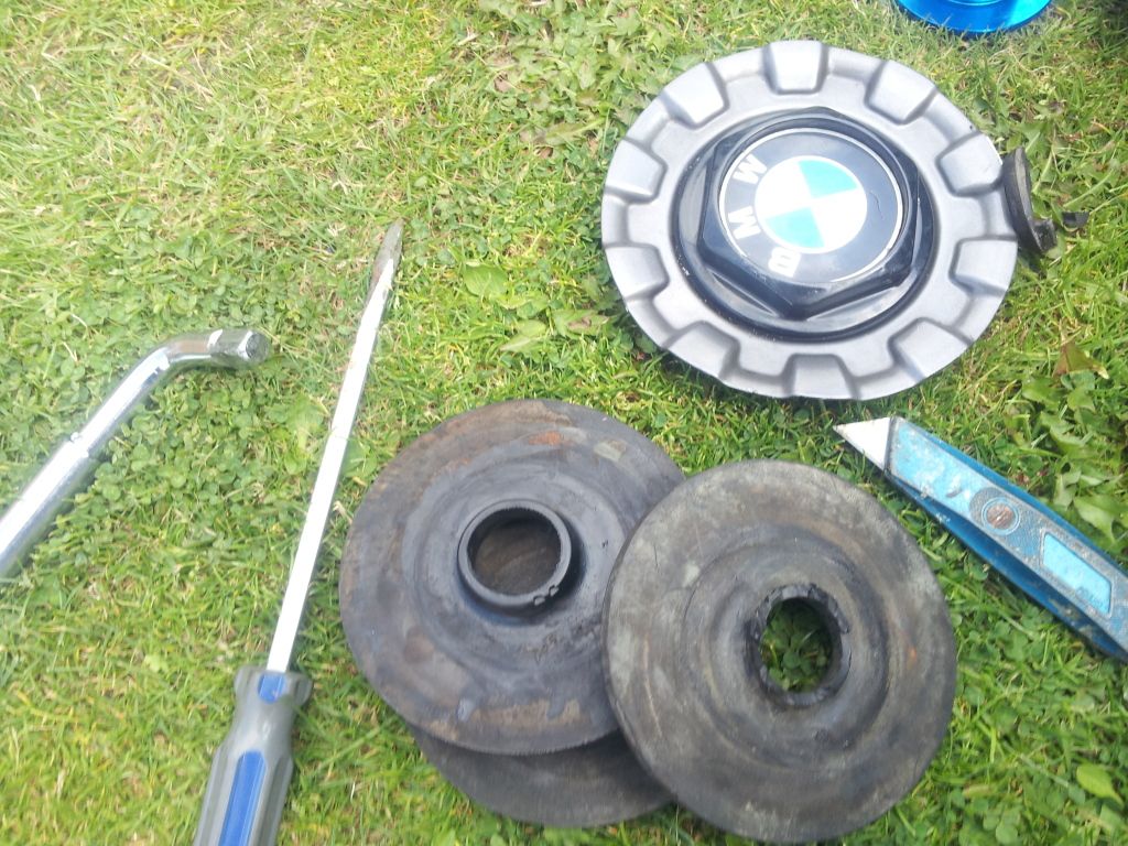

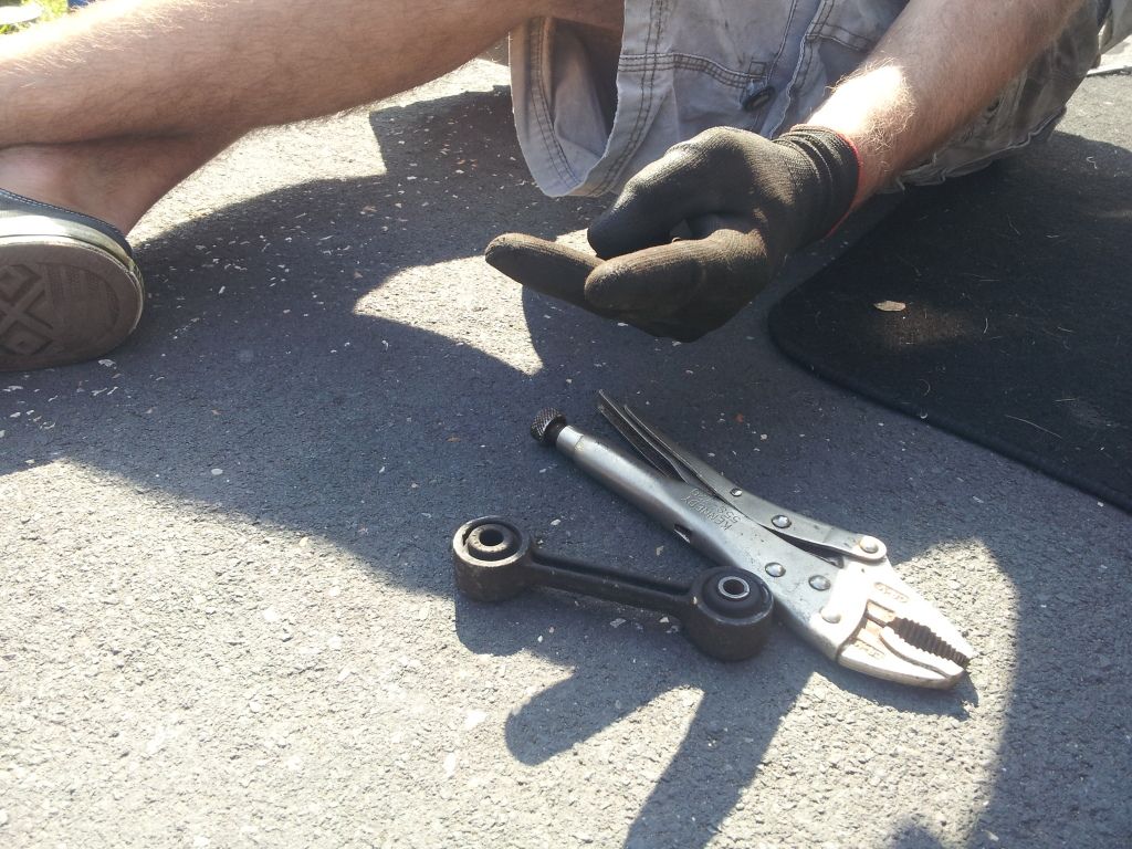

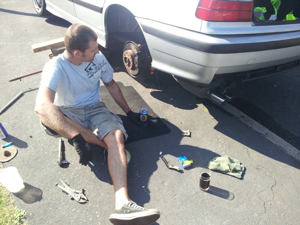

                        Well were can i start as today thanks to the weather and a lovely drive to sunny wells i met up with disco stu and the guys a diamond in nothings too much in helping and we got a lot of work done inc the rear droplinks finally done and my my what a transformation in how it drives now and feels so much more planted now to the road and no more knocking at all and so so happy in how it went today:thumbsup:thumbsup:thumbsup:thumbsup
                        dont think stu will be any hurry in future though to remove a 328 exhaust
                        some initial pics of various stages and a few pics of stus crazy dish on his wheels
                        and work on mine
                        and we modified the rubbers on top of the spring as since i removed the adjusters i had some banging and movement going on so we cut the lip out of the top mount rubber as it faces downward and mounted the rear adjuster in now minus the adjuster collar so it sits totally flush and taped the thread up so absolutely no movement in the spring now(top tip it really works and i keep it still very low)

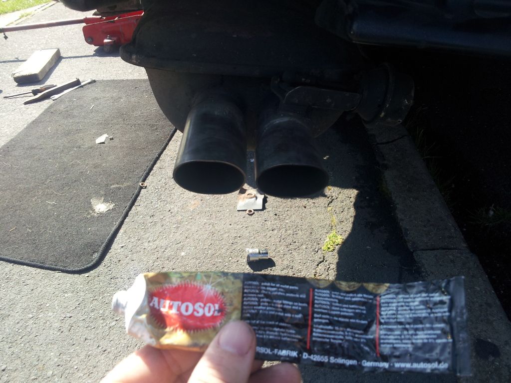

                        And finally attacked the tailpipes with autosol
                        thanks for looking and once again thanks to my mate stu
                        :thumbsup:thumbsup:thumbsup:thumbsup:thumbsup

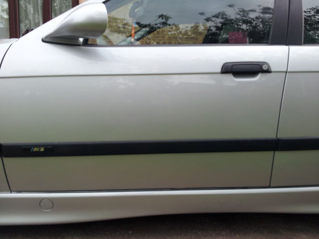

                        Hope the link works meant to upload these as well,wasnt happy with the colour match so sanded it down and used the halfords cans and lacquered it also now
                        Much better
