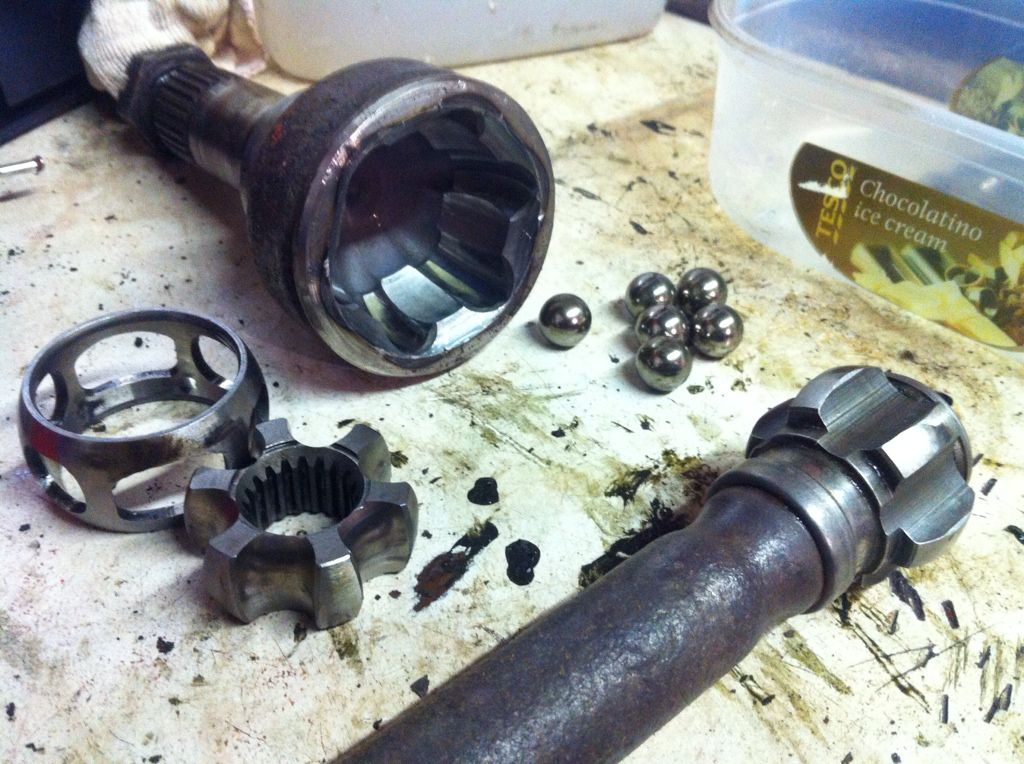

Another evening down. More good progress.

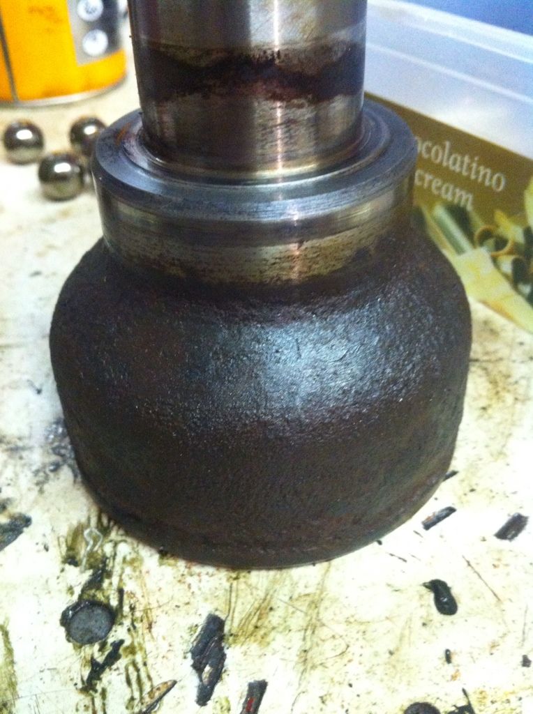

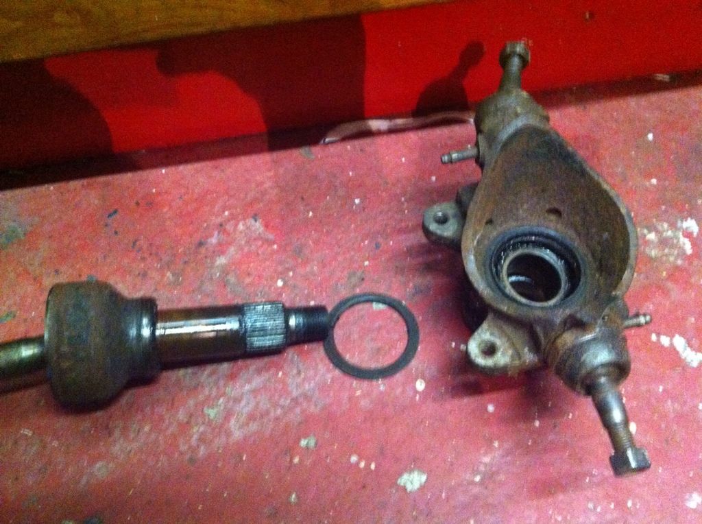

Continued on from the other night and got my second driveshaft separated from the CV joint. Then cleaned it all out again, thoroughly coated it all in Deox gel, left for an hour while I cleaned other bits and degreased and painted them!
So this is after wire brushing...
and this is after deox gelling. Doesn't appear much of a difference but theres no rust to come back through the paint now
and the CV joint cleaned. See above post for the before!
and painted everything up. I know some paint is on contact surfaces but I'm going to scrape that off with a new blade before reassembly. saves time masking up etc.
Also when everything was under deox gel I tried to get my ball joints taken off the hubs. Unfortunately that ended in me snapping the vice clean in two......its safe up to 1 ton too!

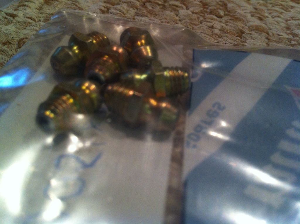

) for radius arms, wheel hubs etc etc to keep everything greased up easily!
