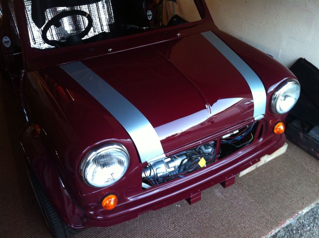

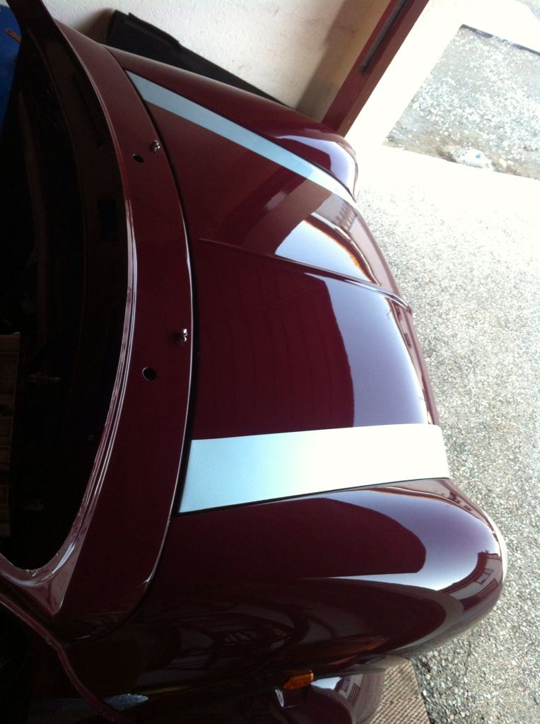

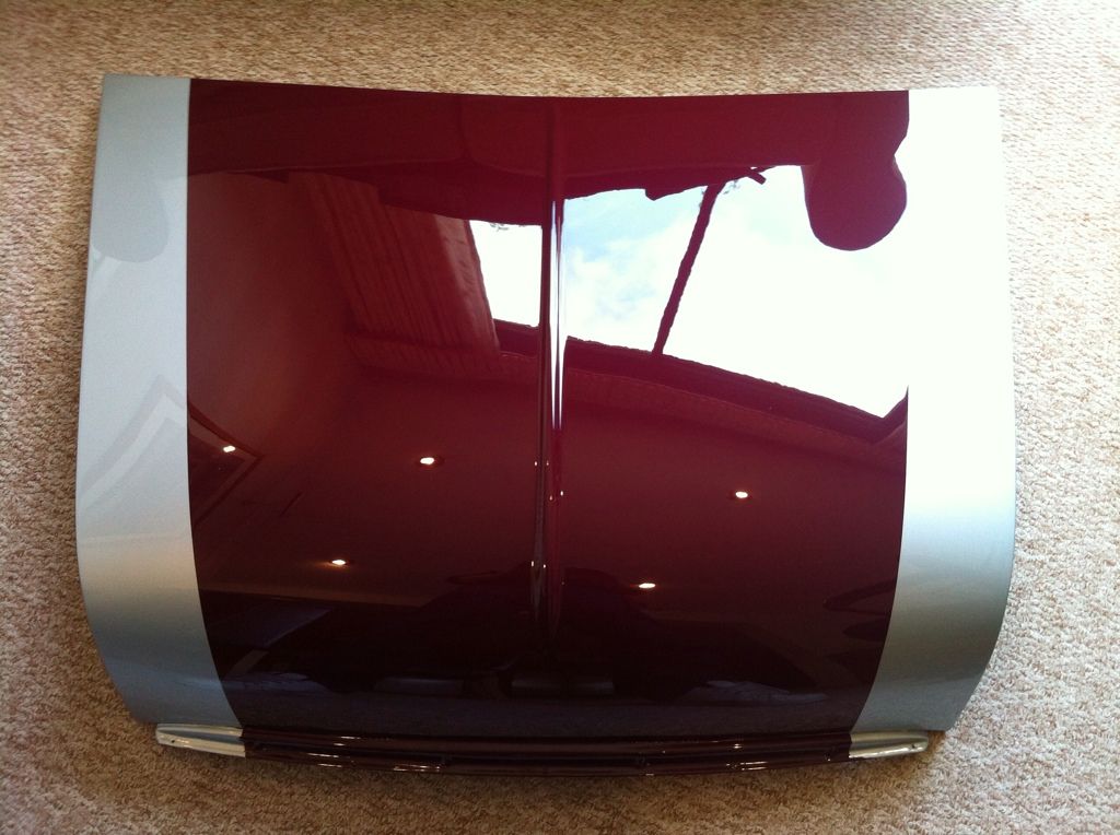

    Small update. Got my bonnet I am most pleased with it
    Sharp colour change line which you cant feel. Epic paintwork!
    and dropped in place for a test. One shiny motor!
    Looks a bit lost with no grille/grille surround but that will come once the dam electrics are all done.
    And a reflection shot just for fun...
    It has a unique paintjob underneath but that wont be revealed until show season 2013

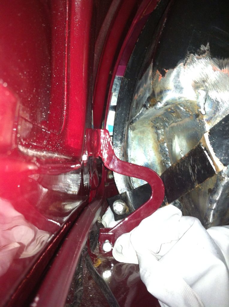

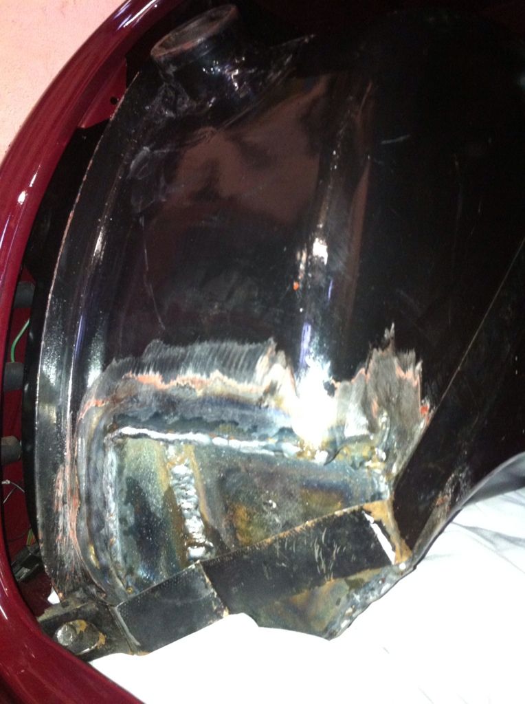

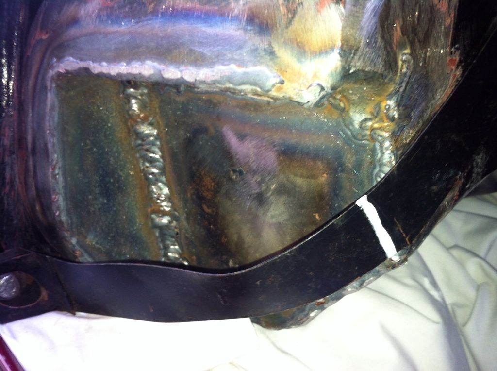

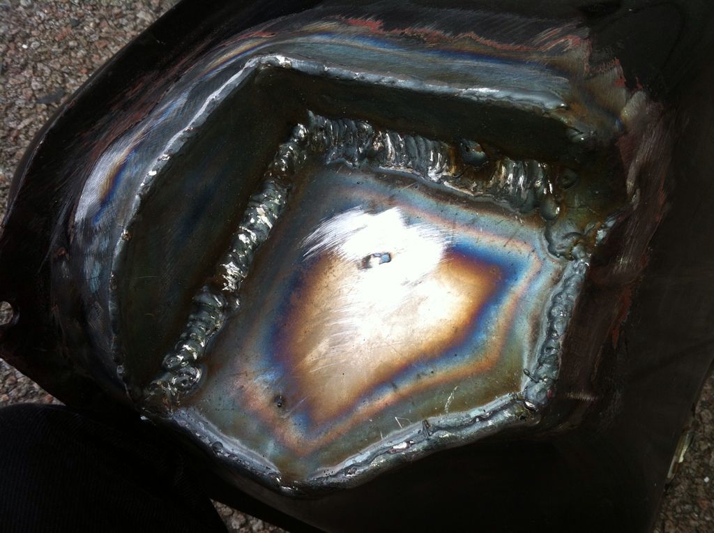

    I test fitted my tank and then bootlid at the same time and immediately struck a problem. The lid hit the tank with its internal hinges! Megafail! So I took the tank to Kirkton MBR to get it modified (again)
    Didnt need much, just a couple of inches and it clears.
    However! The strap that holds it in place now fouls the hinge! So I modded that too....
    Bent into a passable state...
    It still hits, so needs more modding/bending. Its getting close though.
    Once its done the tank needs sealed, fillered and smoothed. Lot of work but worth it!

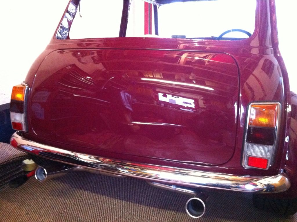

    So I fixed on my latch and got the lid fitted. ITs a crooked fit so need to bend the hinges about a bit to get it sitting nicely and the boot seal is stiff and almost preventing the lid form closing. Need to try and soften it up a bit.
    I covered the bit of paint where the pin goes into the latch with a bit of 1mm thick Laminex I had sitting about. Prevents scratching and indeed rust!

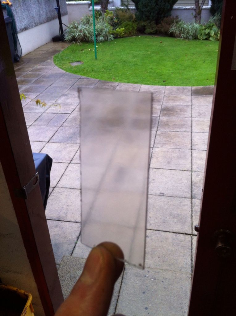

    So due to me having a huge selection of glass I decided to go with factory tints all round for a more modern look. Very subtle but its enough that you can just see it.
    Got the glass from a donor door. As I took it out, it dropped and I heard glass......thinking the worst I slid the glass out to find it was in tact. Turns out the window had been smashed before and obviously just left in the bottom of the door!
    So with that, I cleaned up the glass and put the door together. Took an age but glad I took my time as its perfect now.
