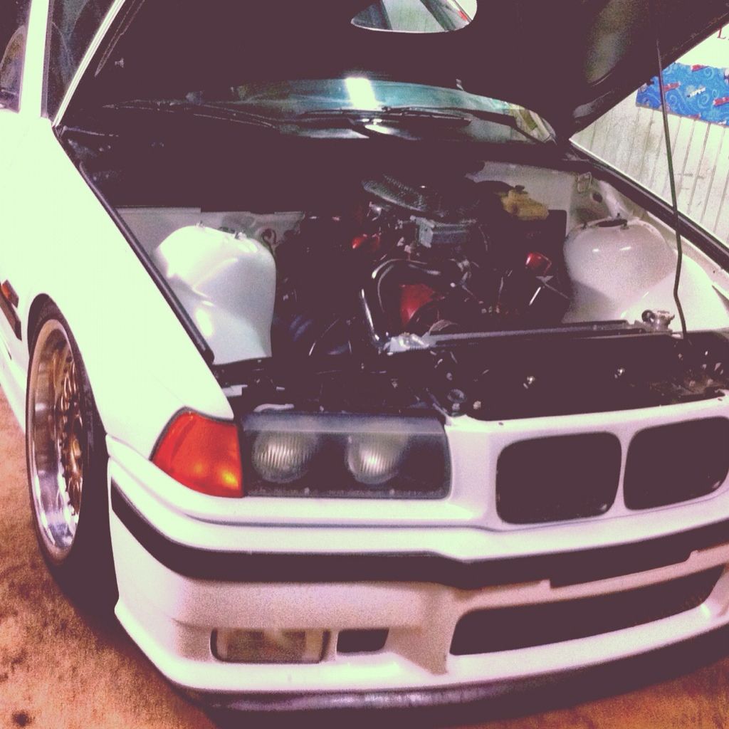

          • that looks so amazing! love the style 5's. howd you get the hood to clear everything?
            • There was a carb spacer on there, removing that and trimming my filter housing down gave me just enough room.
              It's a high rise intake as well, so a lower intake manifold would make things a ton easier
