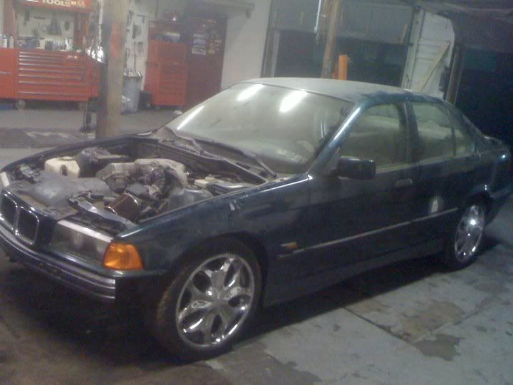

    The car arrives, and as you can see it's seen better days.
    Tearing the car down and mocking the v8 up... one sleepless night.
