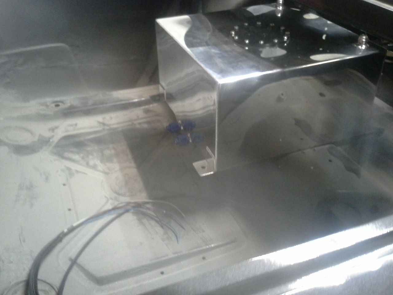

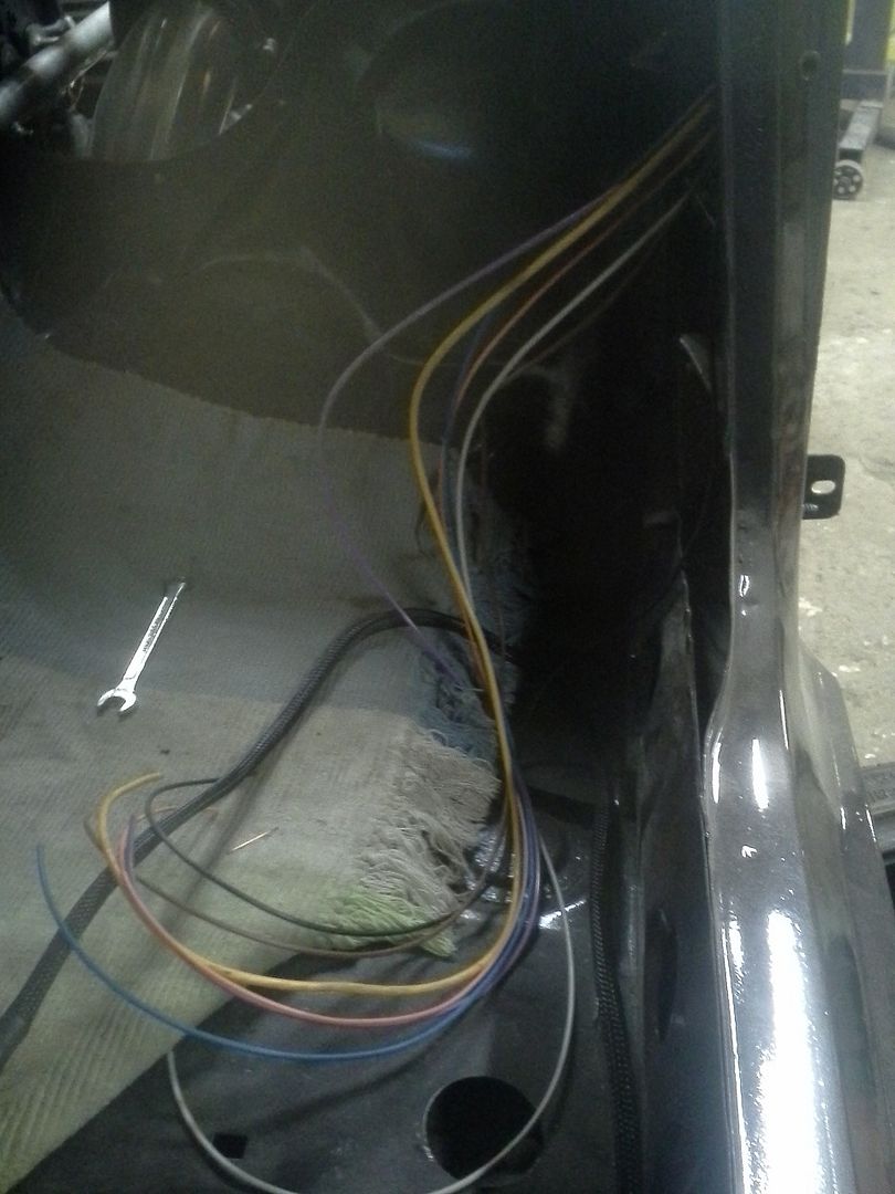

    center consol made of a alu frame with a carbon sheet!
    also, finished laying out all cables for lights, fans, servo, waterpump etc! hope to get some connectors in the mail soon, i orderd some Superseal connectors from ebay a few days ago

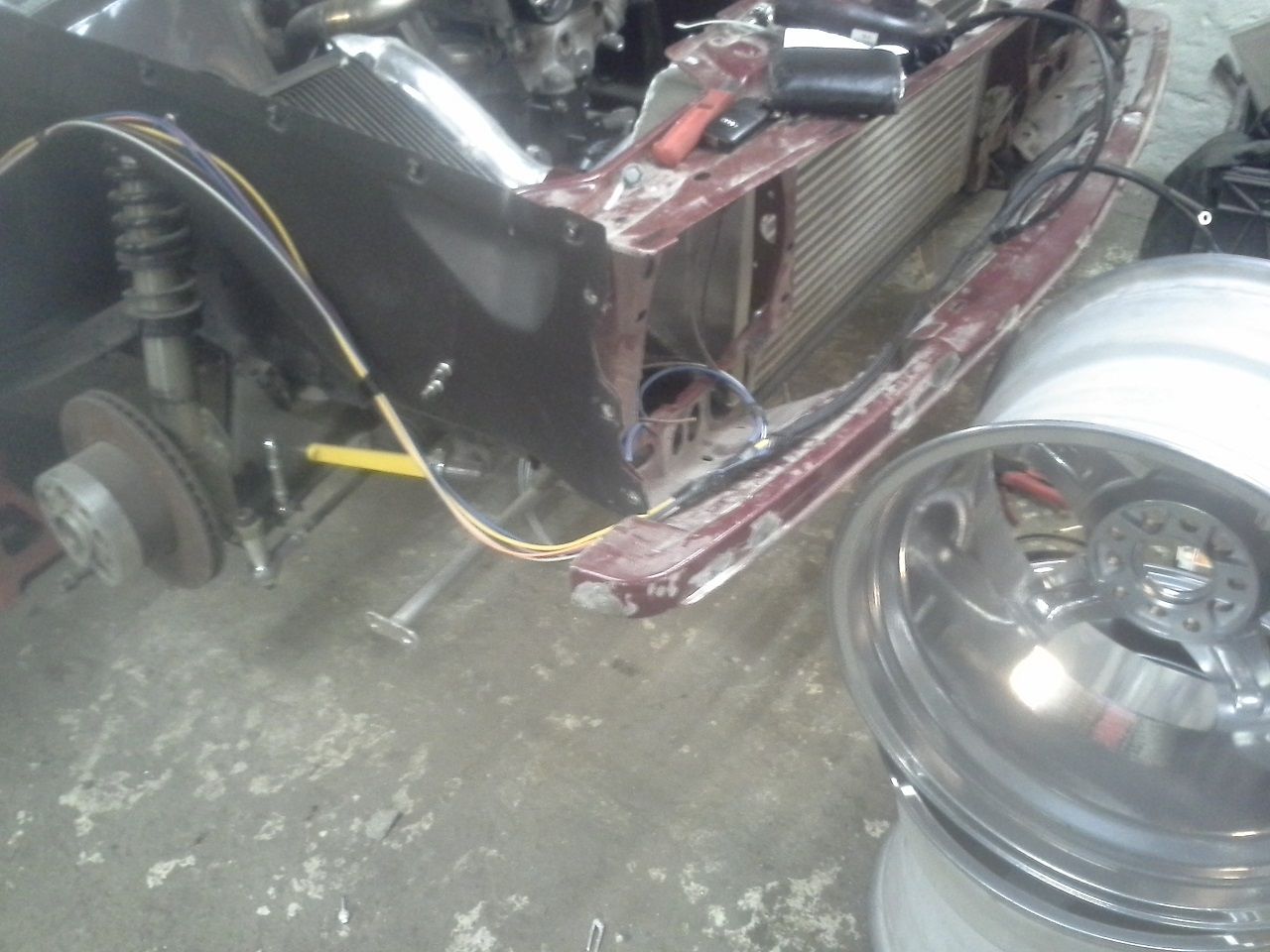

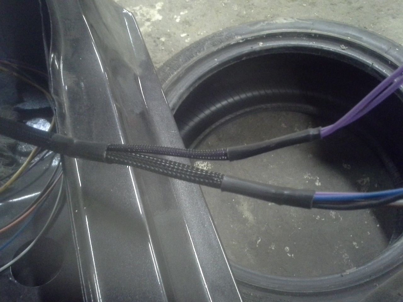

    well ive started ;P
    this is for lights and servo. there will be another harness for waterpump and fans
    oh btw, the harness is moved out of the engine bay looks cleaner
    this is the braided sleeve
    harness for rear lights and fuel pumps is also in place!

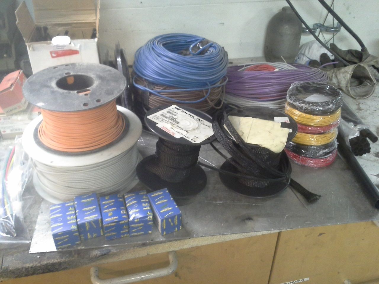

    well, lets just get this over with... :P
    yupp, new wiring harness for the whole car has to be made.. the stock **** is way to heavy and looks like crap ;P

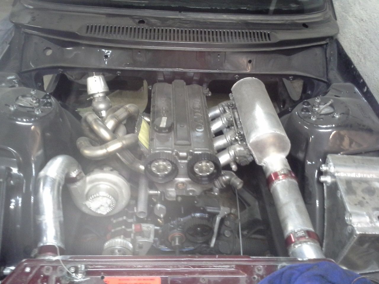

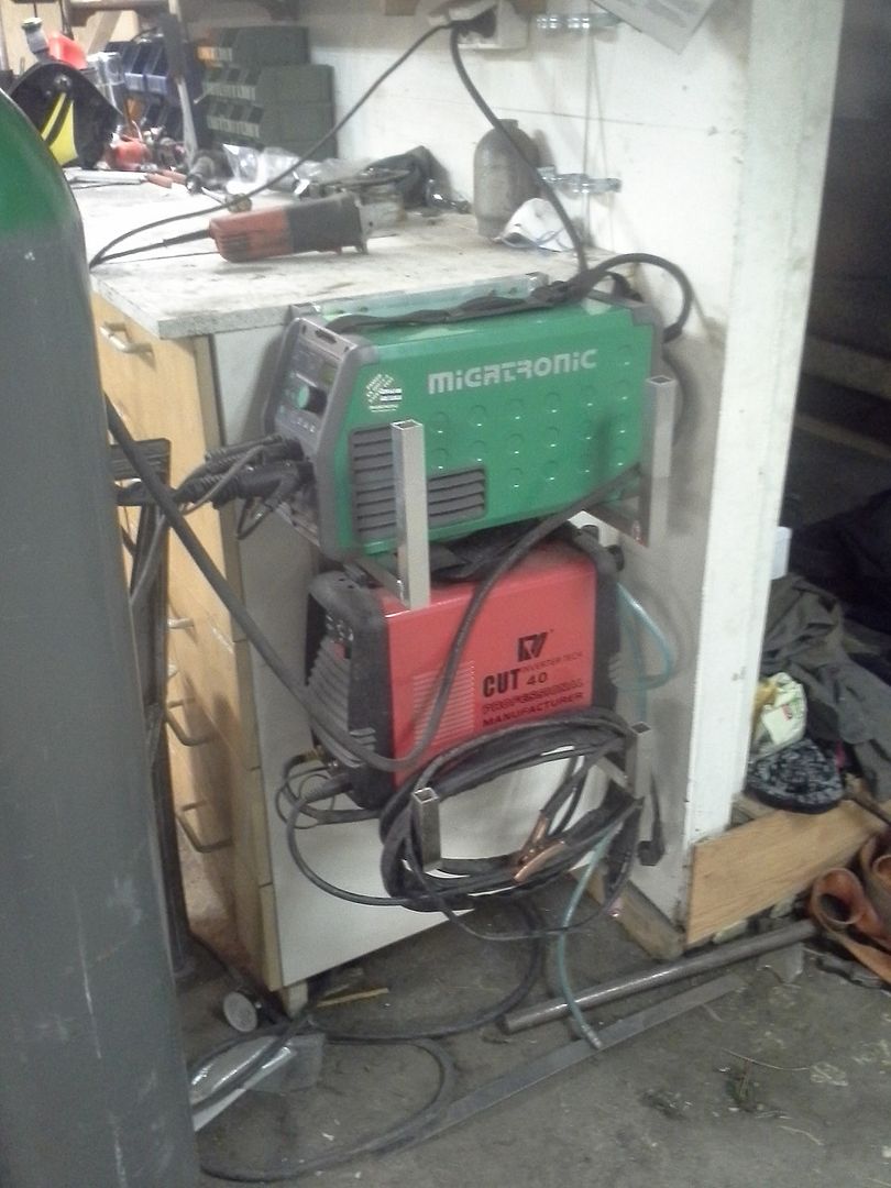

    first job with the new welder:
    make a rack to put the welder and plasma cutter in so it dont have to stand on the floor
    cut and welded some 25x25 mm alu square tubing.. this gave me a chance to test the new welder and figure out the controls before welding car stuff
    after that i welded on the last wiggins clamp on my turbo - IC pipe , so now the pipes is finished to
