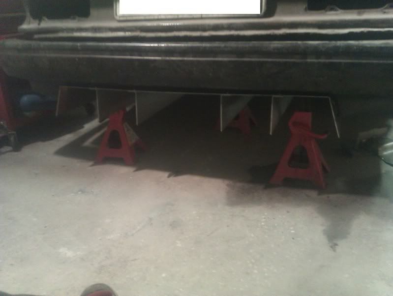

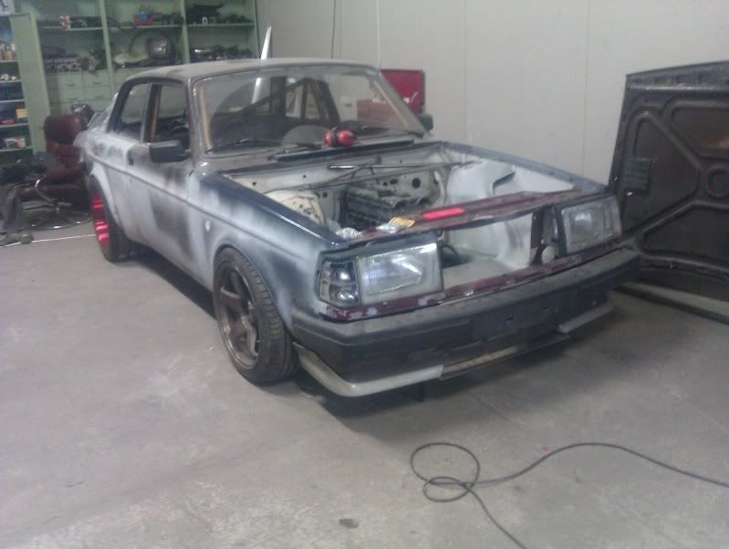

                        well, my camera sucks balls.. but ill get a friend with a decent cam to take some pics soon
                        yes, downforce is needed.. thinking of NOT having any rear spoiler on this!
                        had to remove the wheels when i was working on the car..
                        Starting to look ok
