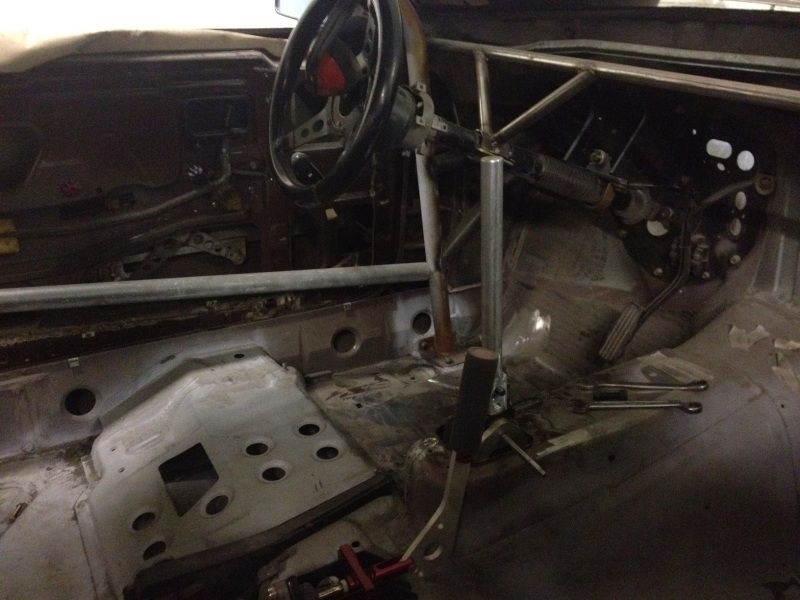

  • between painting in the workshop and cleaning today, i managed to start making the gearshifter! :P

          • i saw the dry sump, and i fell in love
            • fitted the other pully today!
              started with this
              a few hours in the lathe later :P

              • !!!!! you're a magician

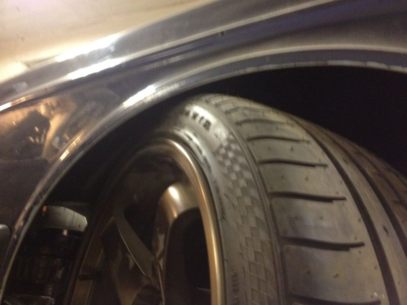

                            • cut out some steel on the inside of the front fenders tires was rubbing :P
                              left 3mm that i hamerd flat for strength!
                              so, "plenty" of space now!
                              if you look closely, you can see where the next problem is, the tires is just 2-3 cm from the top of the wheelhouse! but since this car is a registered road car, im not tuching it! :P

                              • Whoa, coming together sweet!
