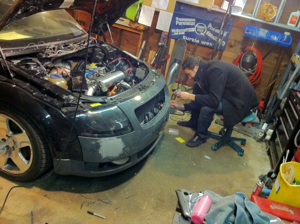

          oh and by caught up, i mean some fun finishing the big turbo build on my good buddy Dougs audi tt. thats me doing some bumper shaving in a pea coat and loafers after we finished all of the work to the motor on tuesday. Turbo came back from precision today, so it should be running within the hour
          yes pea coat and loafers. since they are like our girlfriends, we build cars in style. haha

            you take a skate break in those loafers and peacoat?
            • haha, friends garage in that pic, and the skateboard is usually holding up a motor of some sort. easy way to slide a motor in when doing an install. we made some time lapse video of the motor install in the tt a few weeks ago, but have yet to see it. the skateboard comes in handy for those events..
