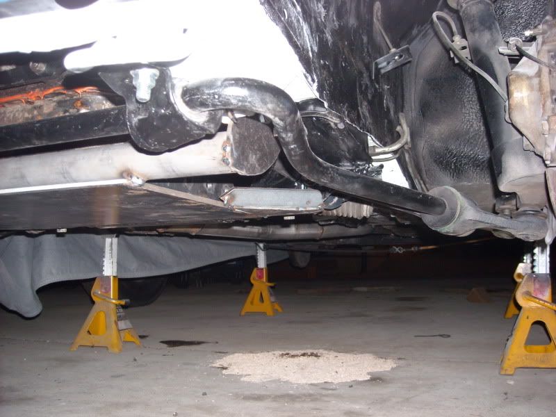

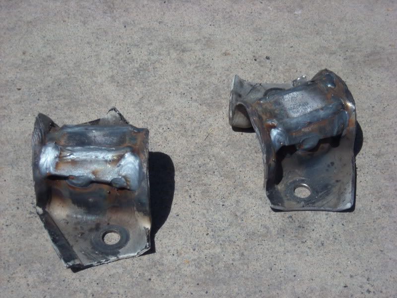

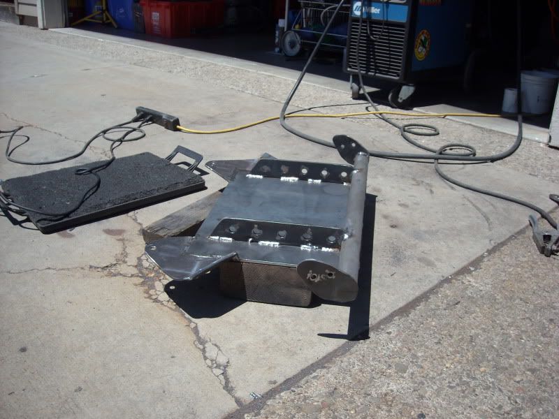

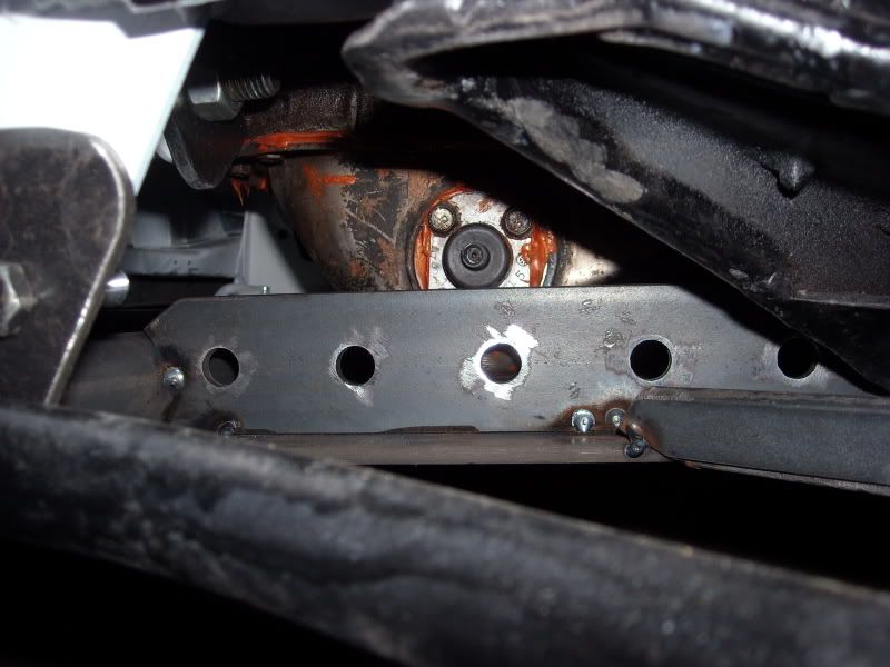

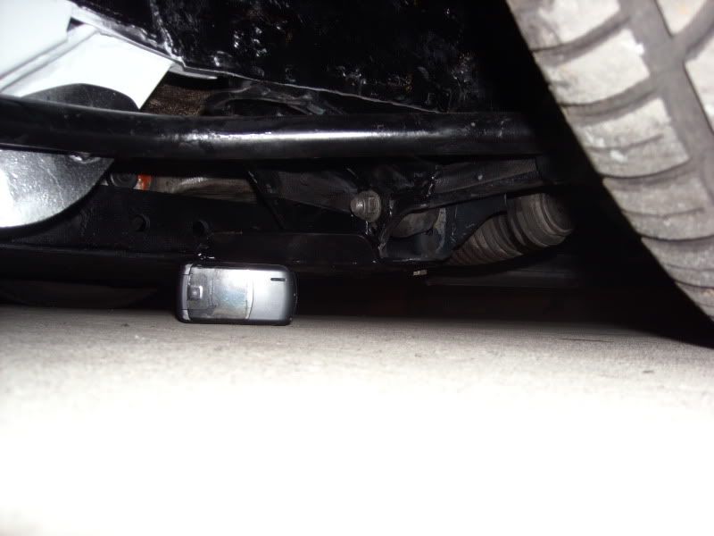

made quick work of armoring my sway bar mounts to prevent wearing though them. I haven't hit them much, but I figured it wouldn't hurt since they were already off. the edges aren't armored really, but now that the center has the reinforcement from the plating, it won't be the end of the world if/when the edges wear away since they are apparently just there for support. not the best pic, and they aren't the prettiest things ever, but they'll be functional.

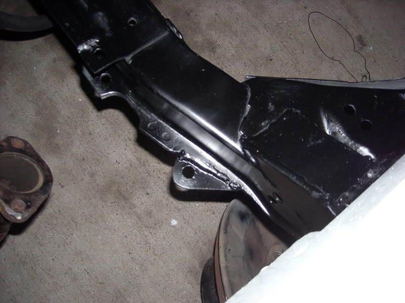

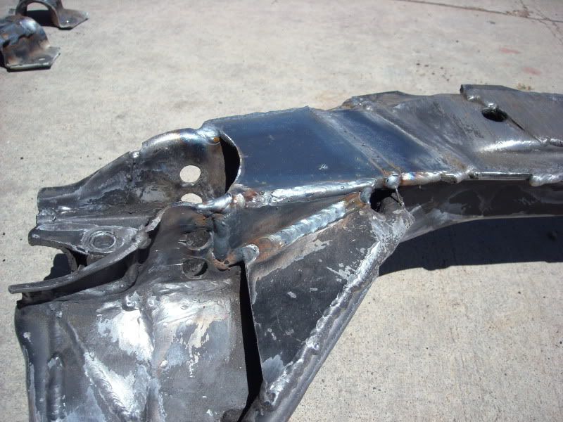

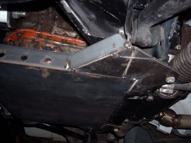

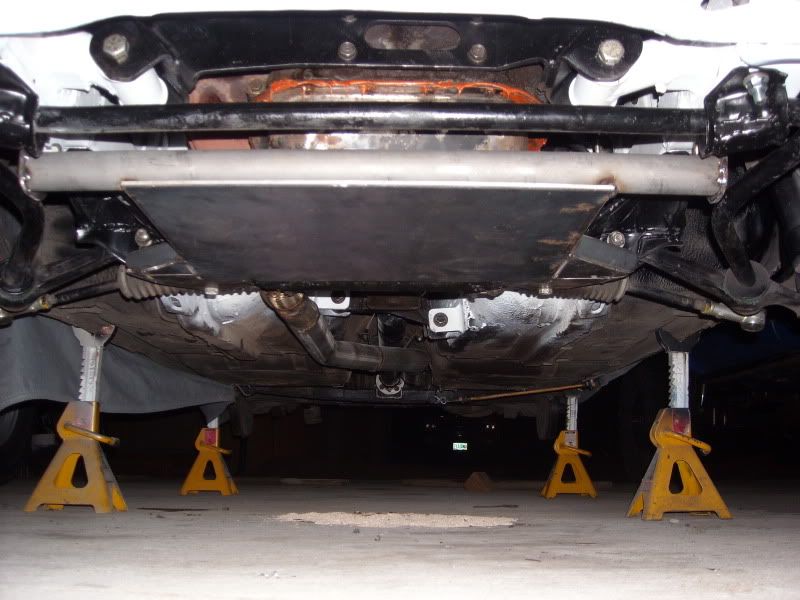

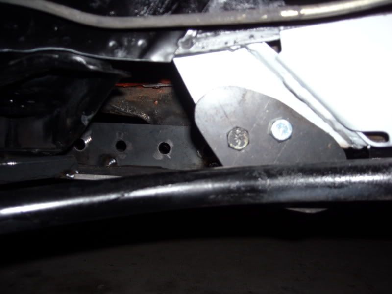

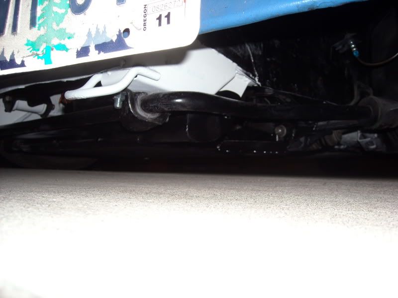

sub frame repair. I had to basically cut out the bent section and re-do it. some hammering and bending was involved as well to get everything in ship shape. you can perhaps notice the triangular piece that replaces a missing chunk and adds reinforcement. I'm considering adding some plating so the sub frame is thicker where the control arms bolt through, especially since the driver's side (depicted) took quite a hit. Opinions on that are wanted and welcome. besides making up my mind on that detail, I just need to figure out what I'm doing for skid mounts on this sub frame and then I'm going to paint it up and install it.
