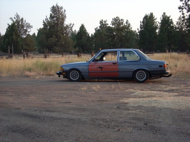

I had a little more fun with the car before I was done with it

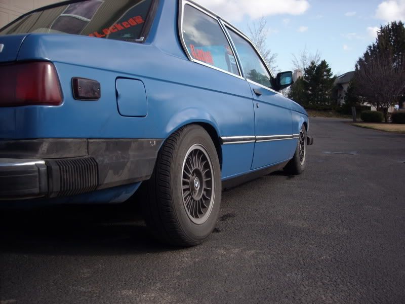

anyways, before realizing that the engine was crap, I had to lower it since it was such an eye sore. wouldn't want to upset the neighbors

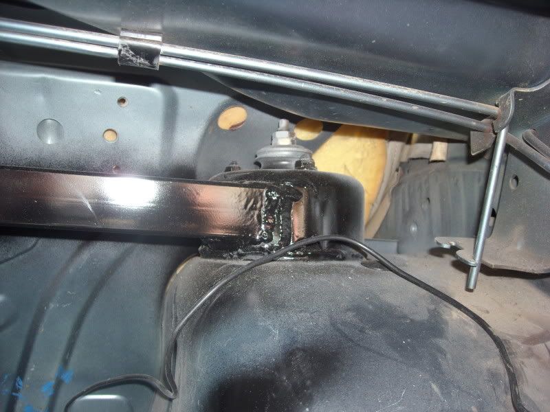

had to grind down the deal on the upper threaded cap piece on the strut housing to fit the free coilover sleeves. I used old toyota spring bushings as bump stops, they work great!

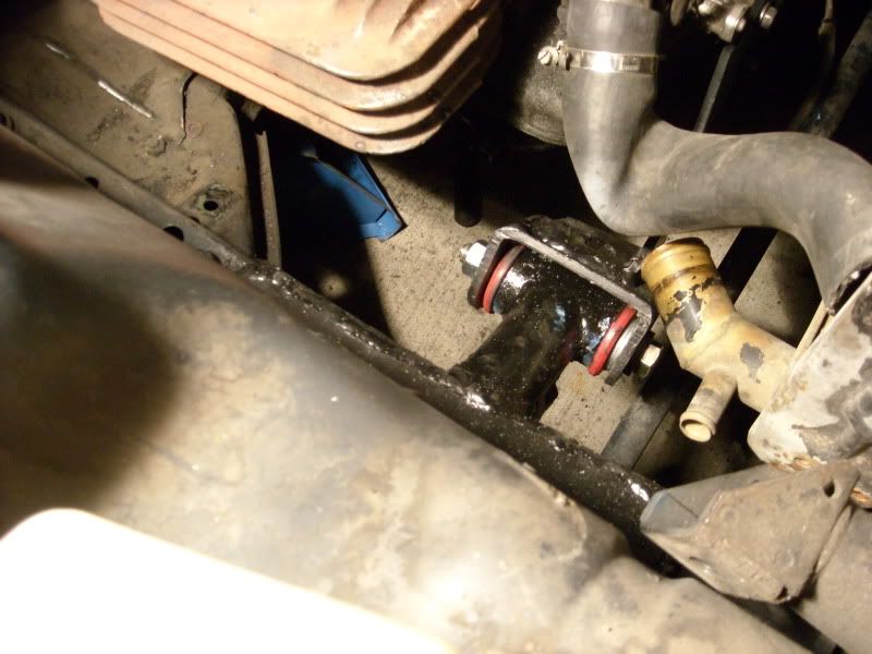

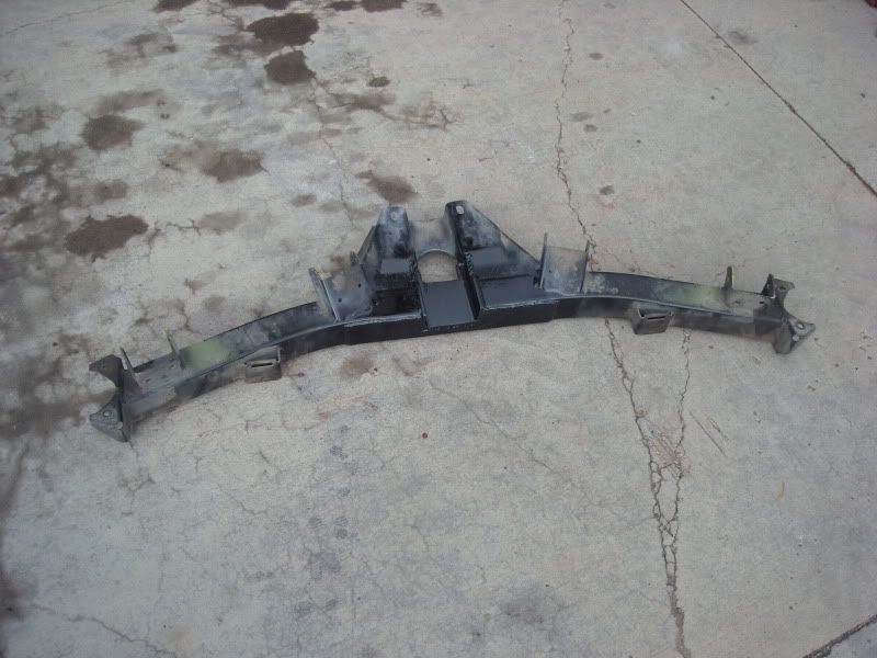

the motor mounts consist of plating on the "frame rail" with .120 wall HREW tubing that fits poly chevy leaf spring bushings
the engine mounts in action

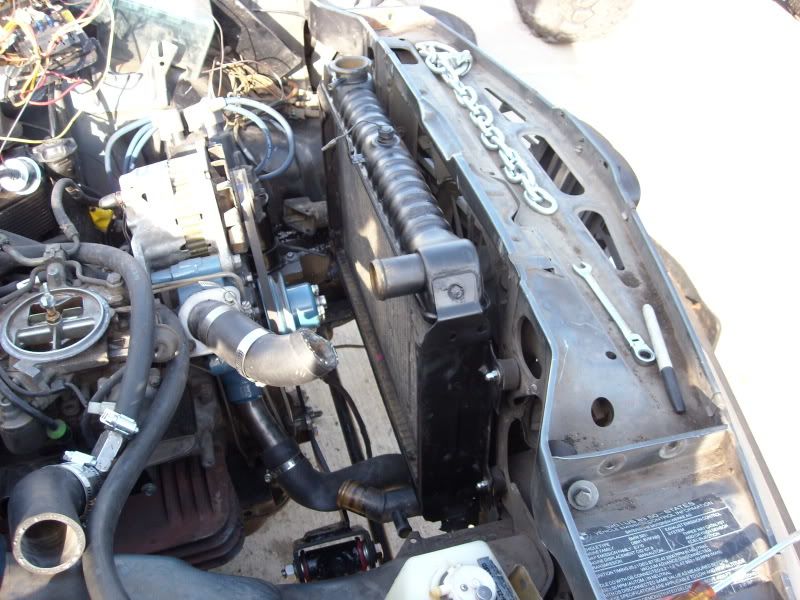

Quick and dirty radiator mounting with rubber air box mounts from both E21's

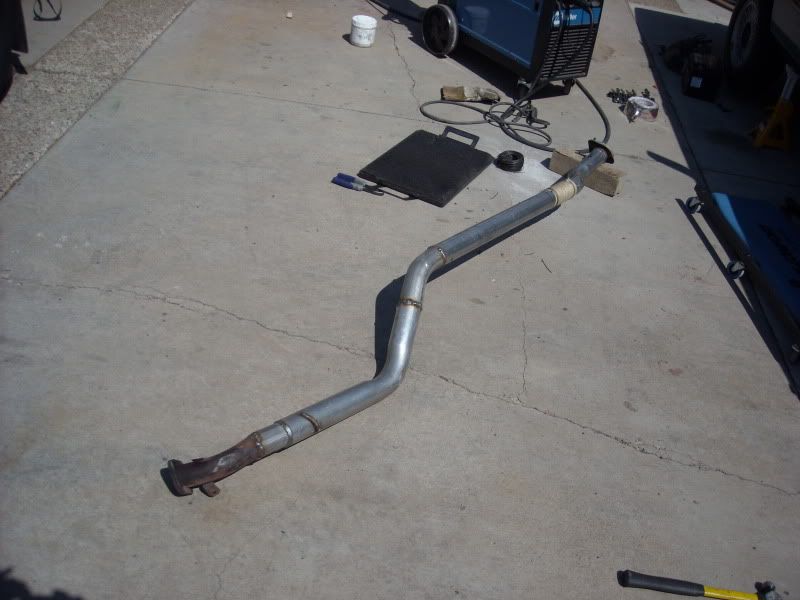

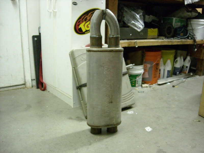

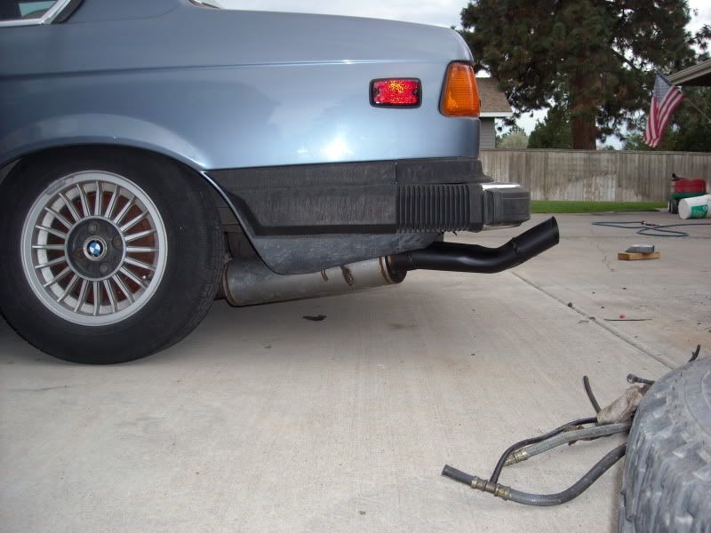

Dumpster rescue muffler with a home made adapter

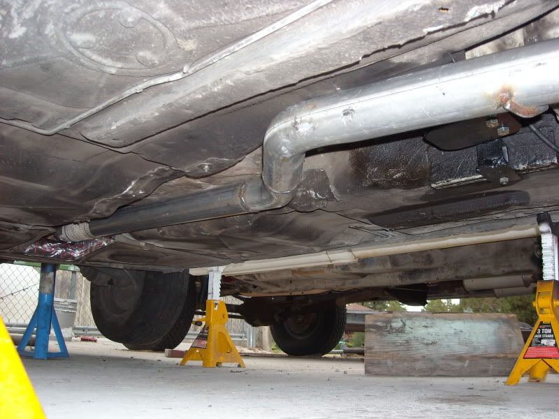

this phase of the exhaust cost me nothing besides welding supplies.

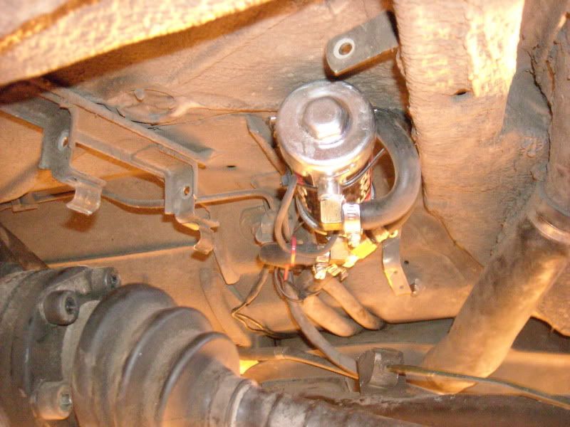

aftermarket fuel pump

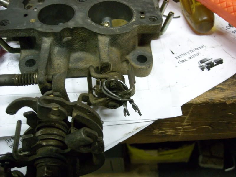

Mechanical secondaries on the carb, the free way. A lot of people use bread ties, I 1 upped them with bailing wire.

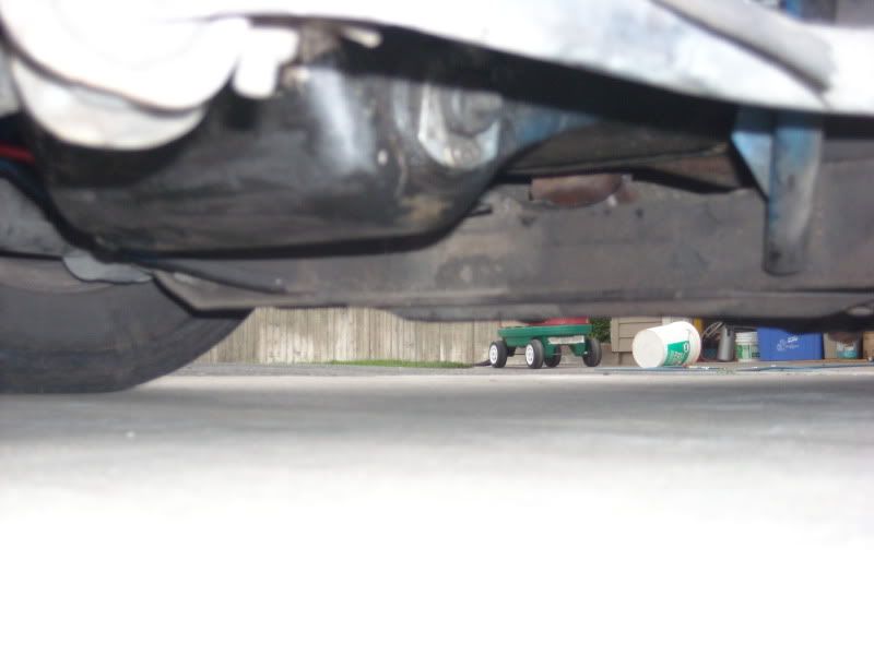

the car wasn't low at this point, but I had the oil pan at a ways above the sub frame. I have yet to hit it on anything.

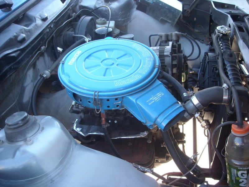

some pics of it when I first got it running all ghetto like
sloppy engine bay:
