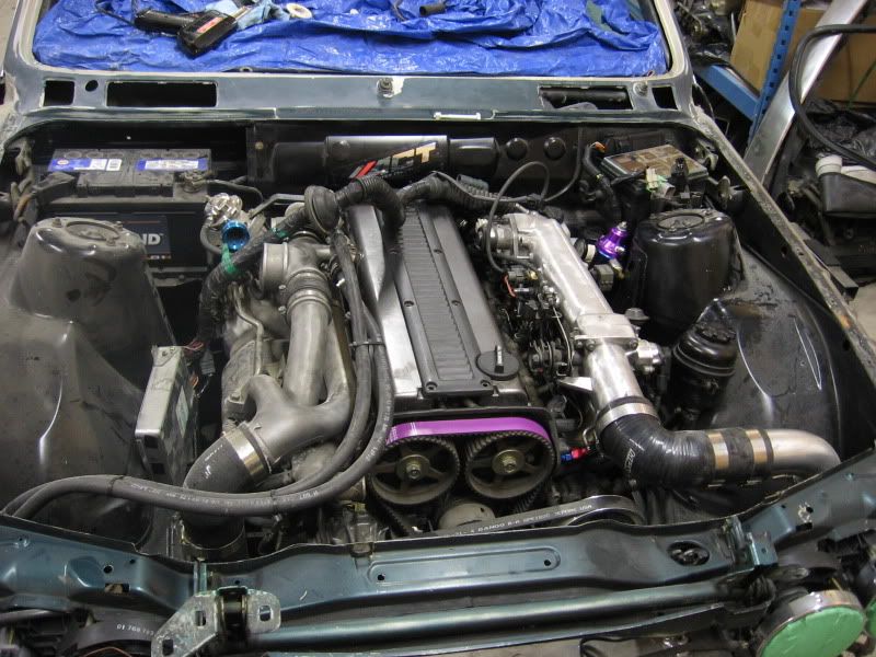

      1984 BMW 318i- 1JZ-GTE

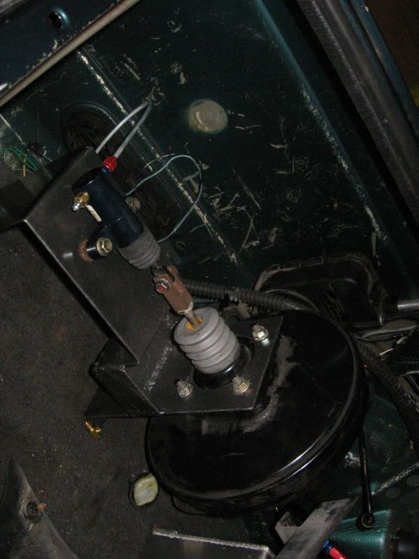

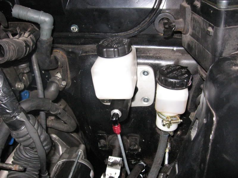

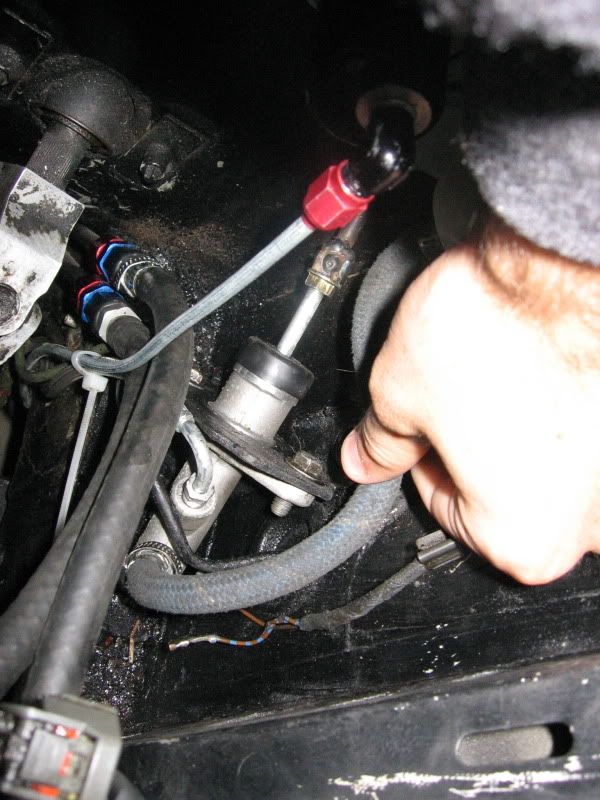

          So after bleeding my clutch I discovered that it was not going to be functional with the stock 3/4" master, so I bought a 5/8" master and made a bracket to install it inside the engine bay, and using a rod from the pedal to actuate it...works a lot better now!
          (for some reason photobucket wouldn't let me rotate these photos)
          And due to lack of room in the engine bay, I engineered a solution to still utilize a brake booster, but to relocate it using 1:1 master and slave cylinders.

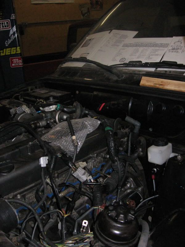

          And Some progress is being made once again with wiring as I finally received new core harnesses to start with.

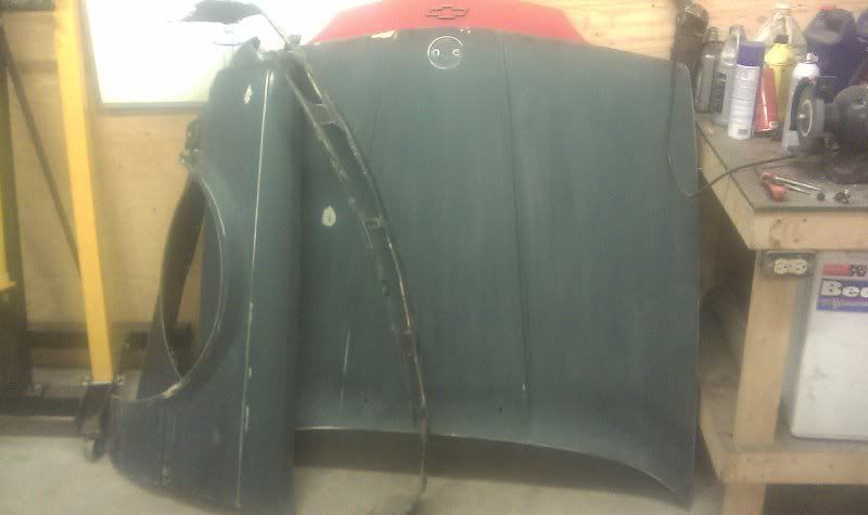

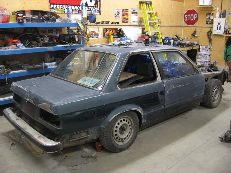

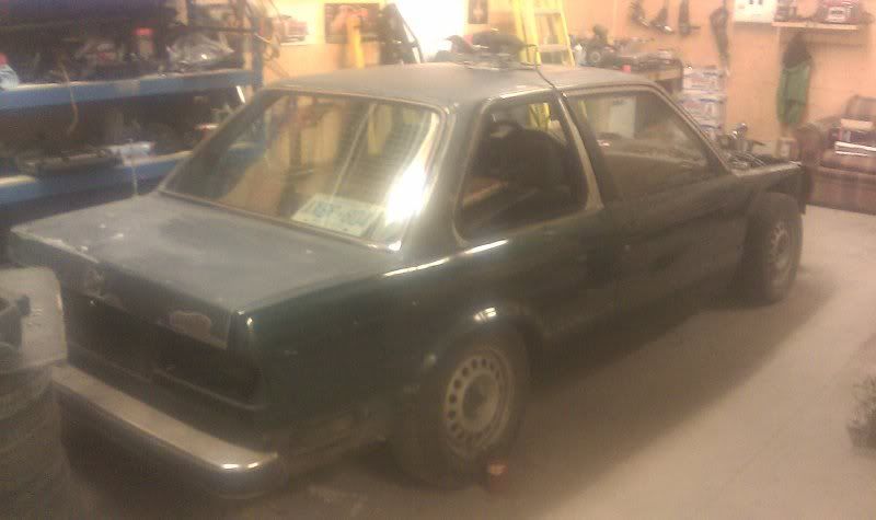

                  So the car is apart (for the most part) and paint prep is well underway...
                  Hood, fenders, and valence almost all prepped
                  roof and trunk prep
                  I forgot my camera so please excuse the crappy quality camera phone

                              • in true "doing everything at once" fashion...working on mapping out the wiring to finally get that started
