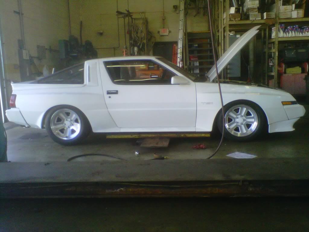

Side on, this thing looks the biz, even with those stock wheels. I like the concave rears, your future wheels should definitely be concave as well to maximise the effect those boxed arches have over the wheel.
Nice work thus far.
I am always having nagging thoughts in the back of my mind to redo the fronts so I can lower it more...I can go another 1.5-2 inches down. Problem then becomes tires hitting the fender well, because these old cars just aren't meant to have body lines an inch off the ground
body just doesn't come come down around the fender to eat up the wheels like new cars. Anyways, i'd love some deep concave, but there aren't many true concave wheels that can go 10.5 -20 with full concave.. I want to find a set of wheels where I can get a nice deep safe concave, with the rest of the offset in lip instead of a chunk of metal on the back of the center pad of the wheels, if that makes any sense.
10.5-20 rear, 9.5-6 front is my idea right now, I am going to mock em up with washers on the lugs to see exactly what I want. So, straight concave seems to be out. I've heard that the extreme concave that these specs require are unsafe for the rigidity of the wheel (IE those crazy concave ADV1, ect). I think a concave + lip would be awesome.

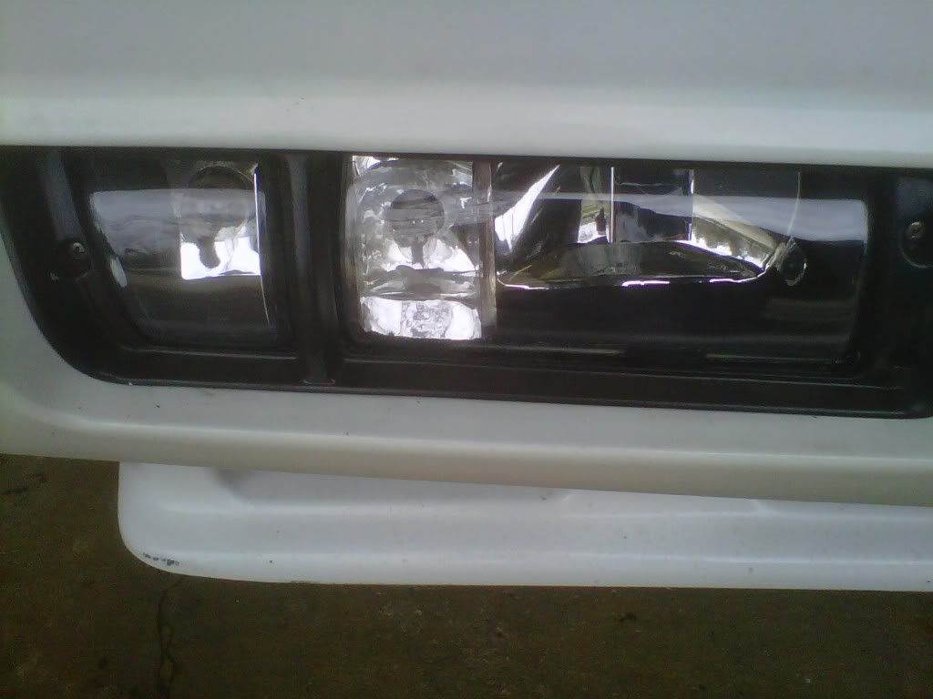

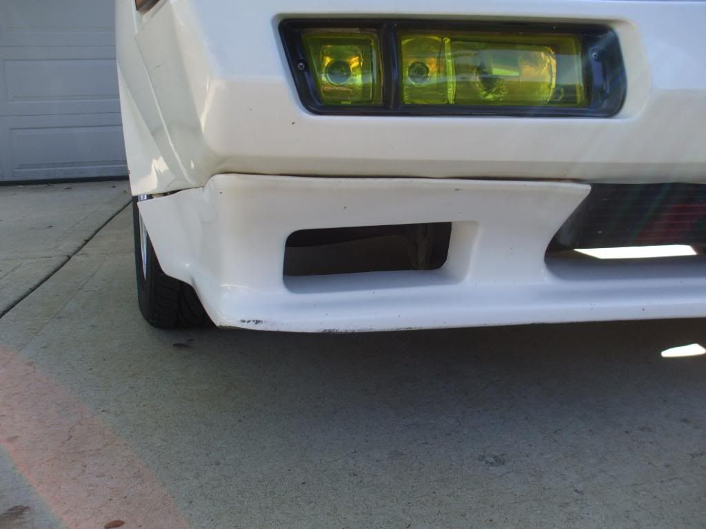

also finished my fog lights.
before:
after:
I have DDM 35w 3000k HIDs sitting next to me for the fogs, and DDM 55w 5000k for the headlights. I need to get around to putting them in soon.

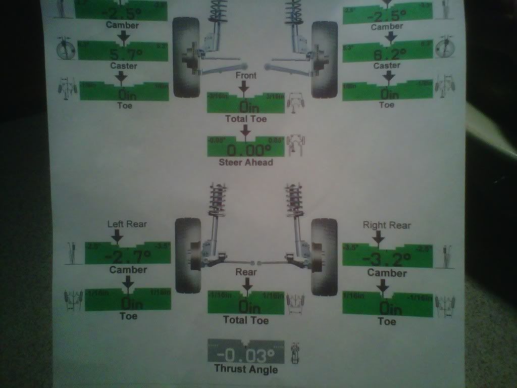

no adjustments. Fixed offset pillow ball camber plates...the strut tower bolt pattern is too small to a pillowball adjustable plate, there are a handful of sets that use a bunch of plates sandwiched that adjust in the fenderwell instead of the trunk, but they are very rare. The only adjustment in back are eccentric toe boltsOriginally posted by Hondamonster View Postwhy such a difference in rear camber?
