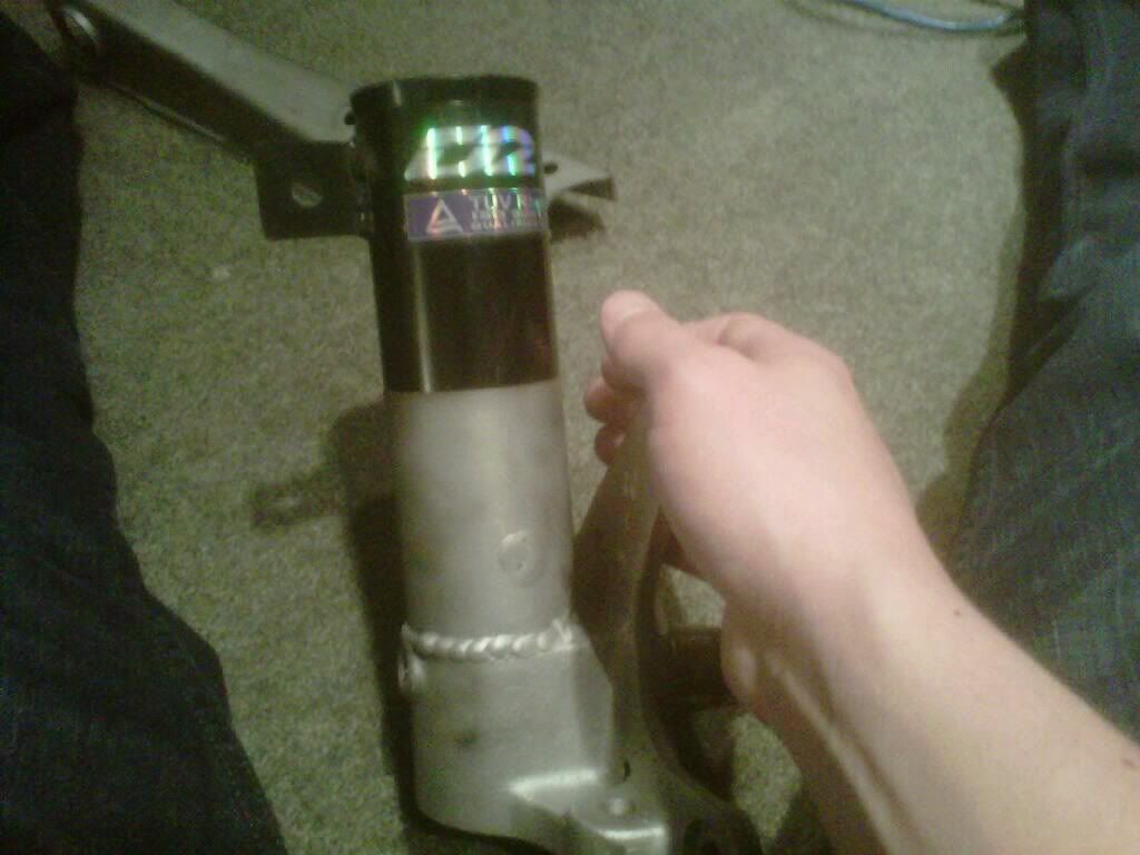

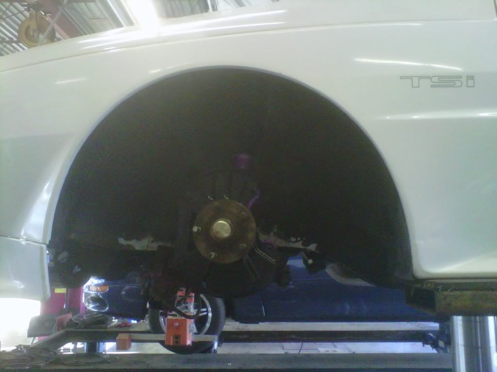

Well I stopped by D&M and they said they would love to do the finishing on em, but want to see all the parts in their shop first before they give a price on it. I am close to that stage, but I need to get my damn rear hubs apart. I got the big nut holding the hub axles in off, but now I can't get either side off to get all the bearings and seals out. Also, the lower bolts on the A arms won't budge. Put em in a 7 ton press at the shop and the A arm started to spread! it pulled itself back though.
Then, they go to D&M. D&M will remove the bushings, stamp everything for left/right, get those lower bolts out, and glass bead everything. then they will send em off to their powdercoater for a nice coat of bright candy purple
I'm thinking this shade, with a candy sparkle in it.
then, assembly. all new hardware or refabbed/cleaned. poly bushings. D2 coilovers. I need to figure out a design for custom rear camber plates. The strut top hats are really small and don't give much room for adjustment, plus D2 mounts the strut to the top plate via 4 little hex bolts rather than just the top gland nut, soooo I need to make away to adjust it at those 4 bolts. Any ideas?

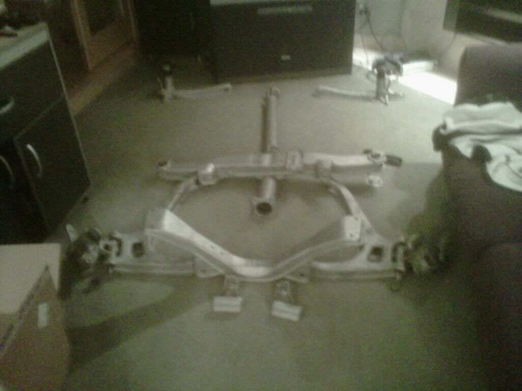

updates!
glass beaded:

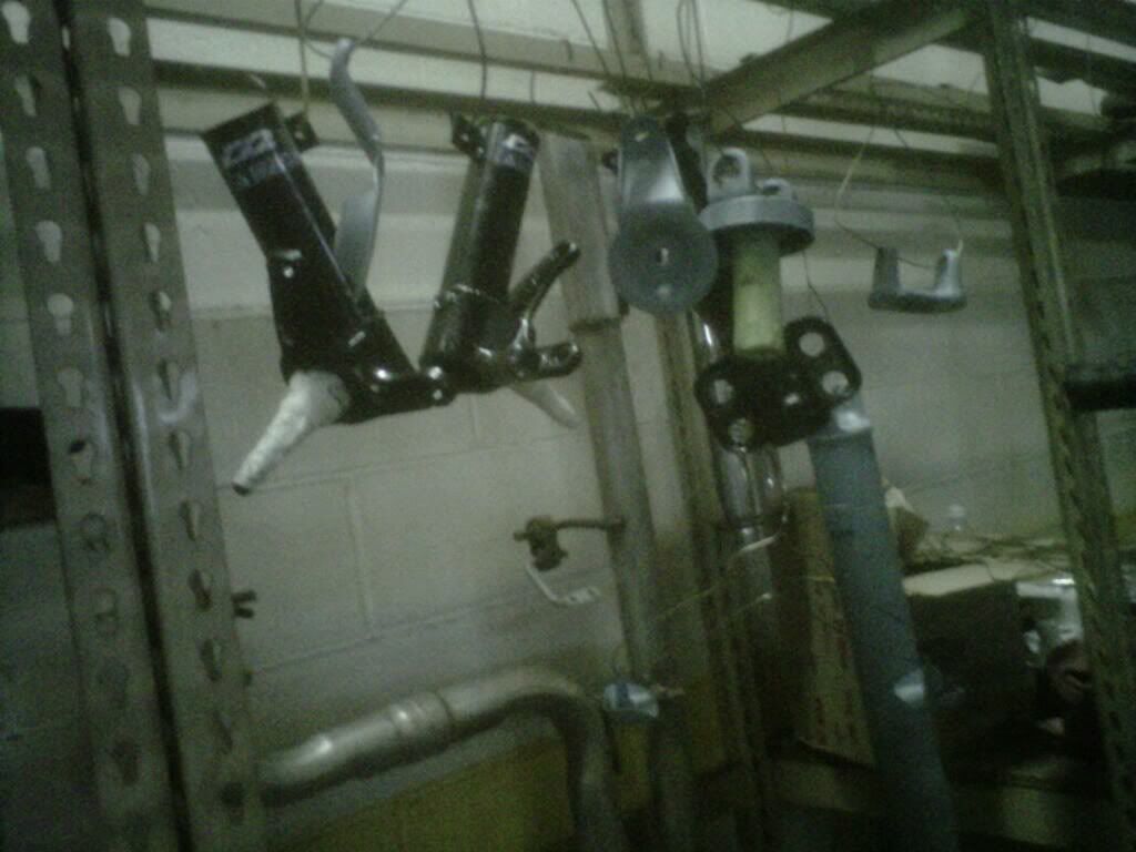

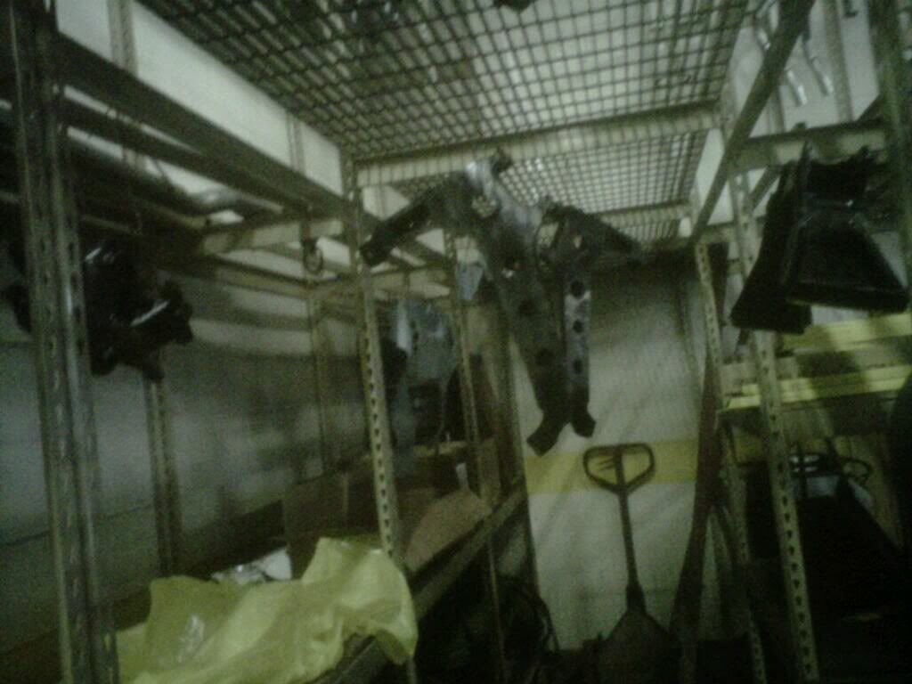

painttttt! (not done, some has one coat of Por15, some has both coats of Por, and some has primer over the por, ready for metallic silver base-> purple color coat -> clear coat)

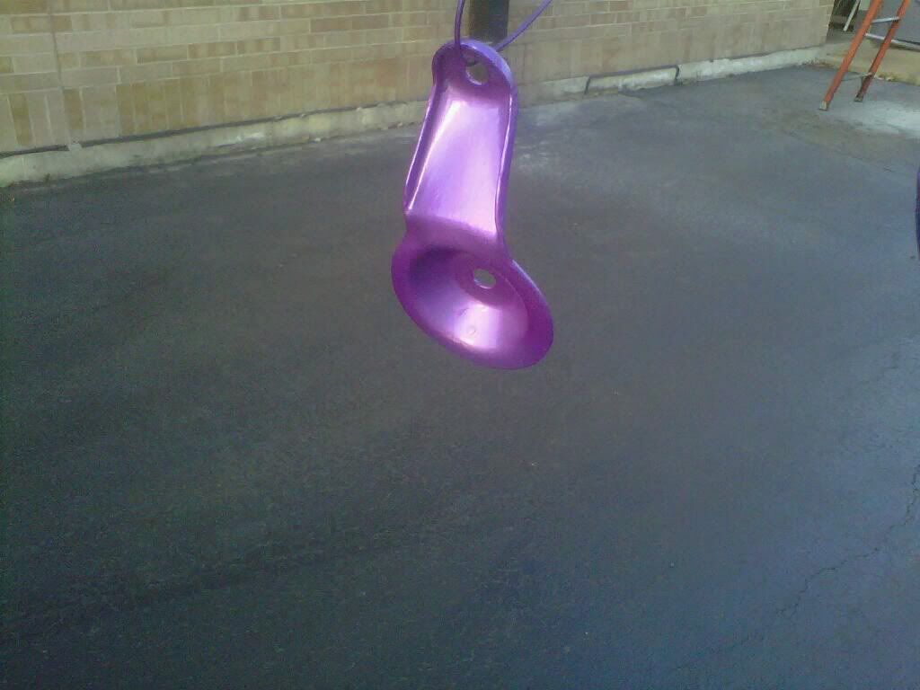

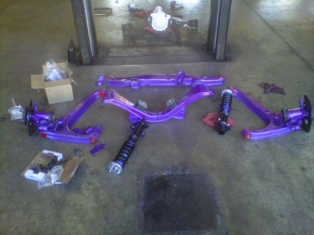

purple!
cell phone doesn't pick it up, but it is VERY sparkly. It is also VERY hard to apply even coats...since it is transparent over the silver metallic, it is very hard to match the "tint percentage" (only way I could describe it) from one spray pass to the next, so some spots seem to be a deeper purple while some are more of a purple hue over the silver (mostly in the hard to reach corners and crannies of the parts)
